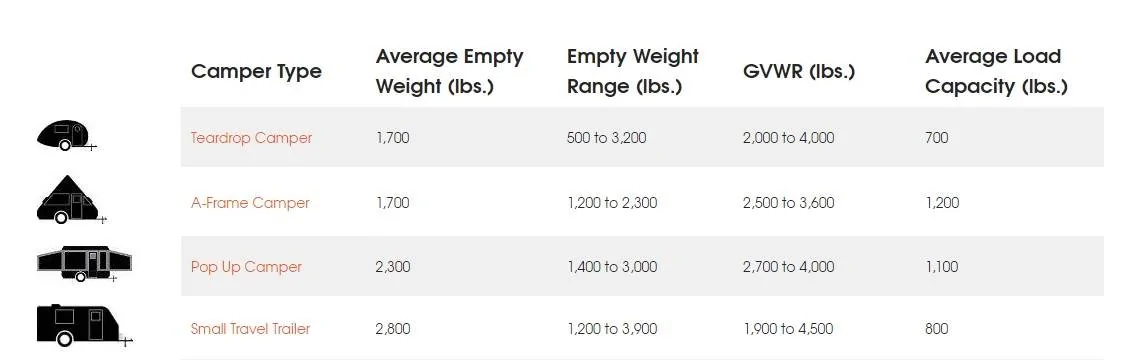

I didn't say that all travel trailers were 13,000 lbs. What I was trying to make a point about is the Maverick may be some peoples first foray into owning a "truck" and they may have overly exuberant expectations as to what the capabilities of, essentially, a modified unibody car-based mini-pickup (based on the Ford Escape mini-SUV) is actually useable for towing.
I was just saying that if someone is regularly going to be towing a travel trailer weighing even half of 4,000 lbs. empty, they will be at the very limit of the capacity fully loaded. And that capacity is on level ground at sea level. Once you go up 6,000 to 7,000 feet, which is pretty common in my state when traveling, the manufacturer's towing capacity rating is significantly reduced. And the rating is not at all taking into consideration the ambient air temperature, which in out area we average around 50 days over 100, and we reached 110 twenty times in 1994. That supposed 4,000 goes down rapidly with a loaded trailer and any of these other conditions.
That is why I said people really should buy a real truck for towing. The maverick is a wonderful vehicle for what it is. A tow vehicle for anything other than very light local U-Haul or utility trailer (for a riding lawn mower or golf cart) it is not.
Ford Maverick 2.0 supposed to tow up to 4K lbs.  Not so! Travel Trailer Weights
