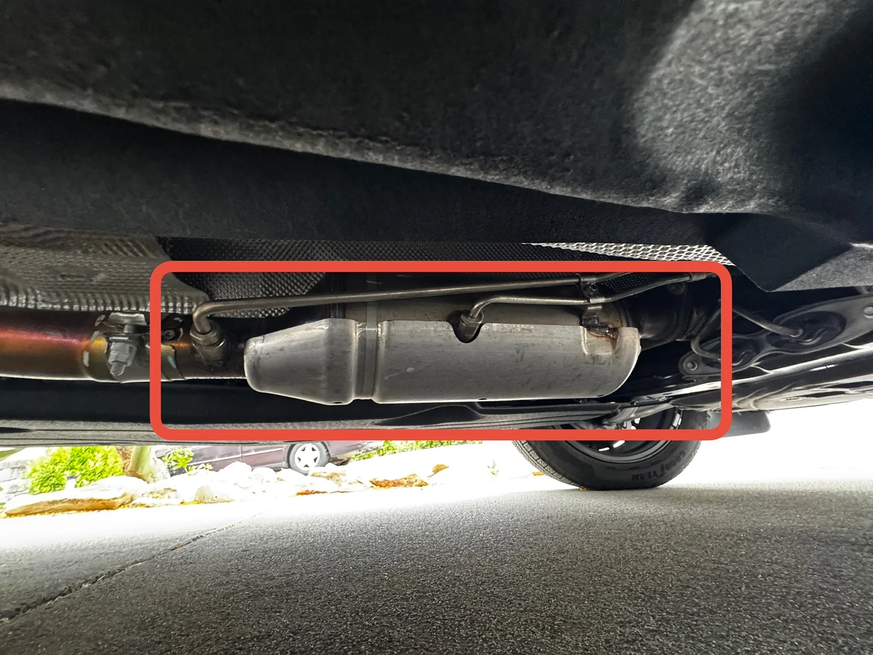

I am guessing that your 2022 and 2024 had the large resonator at the tailpipe instead of the current resonator that looks like a metal patch? A few hours of sound deadening material made a heck of a difference on my 2026 Ecoboost. Ford came up with an extra 25 rated HP from the 2025 Ecoboost 2.0 engines. I am curious if exhaust changes were part of the extra ponies. I have yet to find an aftermarket exhaust that would make me want to break my piggy bank for.
2024 Ecoboosts have the patch resonator. The rear "box" resonator if I recall correctly was only used in 2022 and part of 2023 production.
I'm pretty sure all Maverick Ecoboosts are rated by Ford at 250HP.

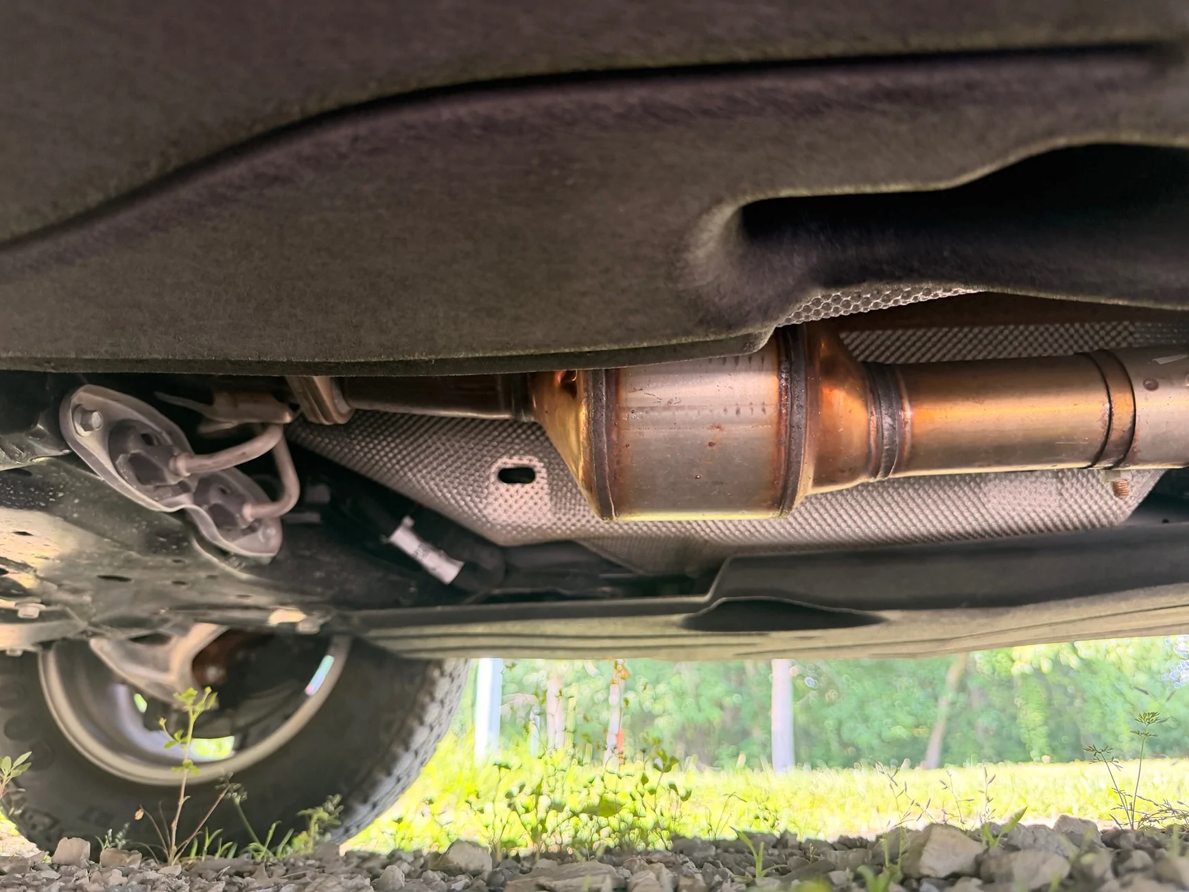

Ford Maverick 2026 Lariat Ecoboost Rear Drone Noise IMG_2836
I’m assuming this is the GPF?
My 22 EB AWD has the "patch resonator" towards the end of the exhaust system. No idea when a "box" resonator got implemented, maybe some MY23 owners can chime in with what there's have.
If that's the case, then I suspect that the box-style resonator was only found on early 22's. The patch came later than the box
That might could be the case, mine was a later MY22, took 10 months to arrive at dealership from the order date
