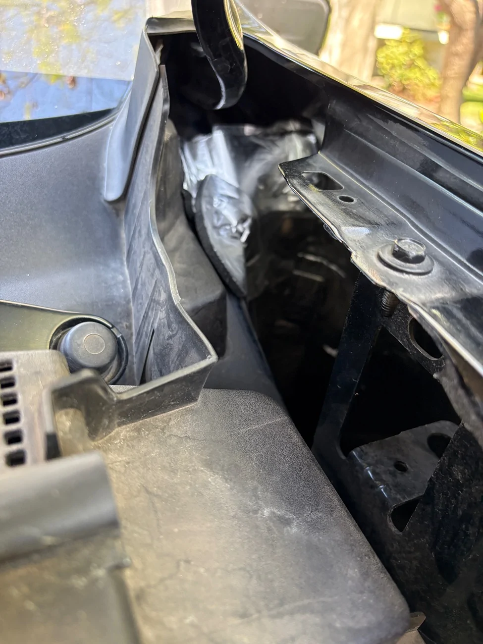

Hi,
kind of old, i "hate" the engine noise that filters to the cabin. I don't mean the sewing-machine noise but the "from high to mid rev engine rattle/vibration".
I found (repeated in many threads) that most of the noise comes from the driver's door that has no padding between engine bay and driver side.
I bought some cheap thermo pads in Temu and stuffed (from the engine side) that space (see crappy pic).
It really muffles the engine noise and now Mav sounds much better, not high rev rattling.
Happy driver! Improved experience.
Hope this helps! Cheers

Yea . I used pool noodles (cut to length) between the front doors and fenders (stuffed them in ) . Also used them between seats and center console to prevent stuff accidentally dropped to be easily retrieved .
