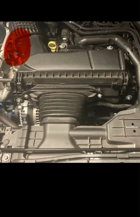

I'm confused. How does putting an air intake and filter directly in the engine compartment, provide any colder air than the original sealed design which is pulling air from the front of the vehicle?
It doesn't. Any advantage the intake would provide would be from less air restriction than the factory cold air intake, usually from larger-bore tubing, more gradual tubing bends and less-restrictive filtering elements allowing for higher maximum horsepower at WOT. It won't do much of anything for efficiency, and efficiency gains play a near-zero part in the sale of such intakes.
In other words, Don't put too much merit in the term "cold air intake" and assume that's where gains will be had. It's a marketing term, many times used incorrectly to describe many third-party intakes which aren't sourcing air from a "cold" location at all. The S&B is not one of those incorrectly using the term.
