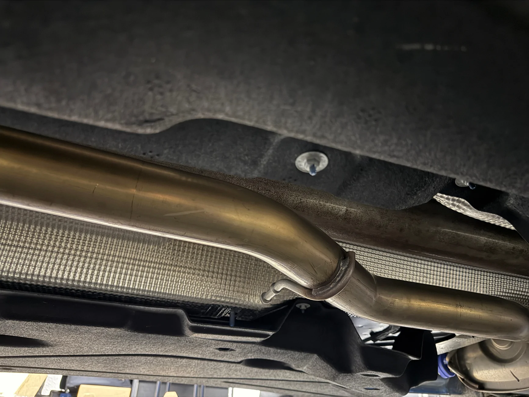

Maverick 77 - it seems your underbody heat shielding was not re attached properly looking at the various pic?
That could vibrate at high speed causing a drone?

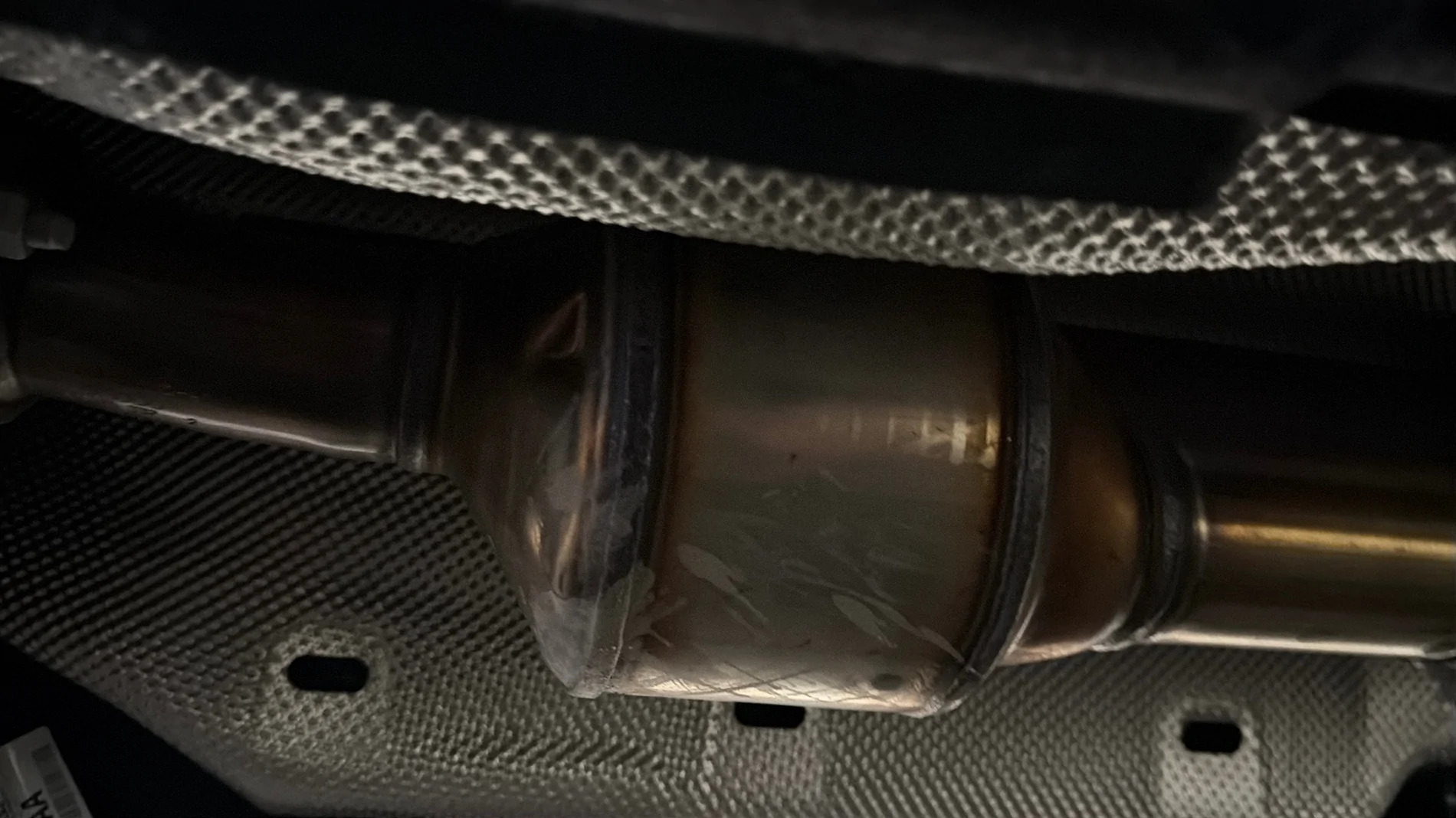

If a shield was not reattached properly, it definitely would vibrate. When I had the backend on the ramps today, I grabbed the felt and tin shielding at several places, but I did not feel anything was loose and did not notice any unused hold down spots, but these 66-year-old eyes could have missed something.

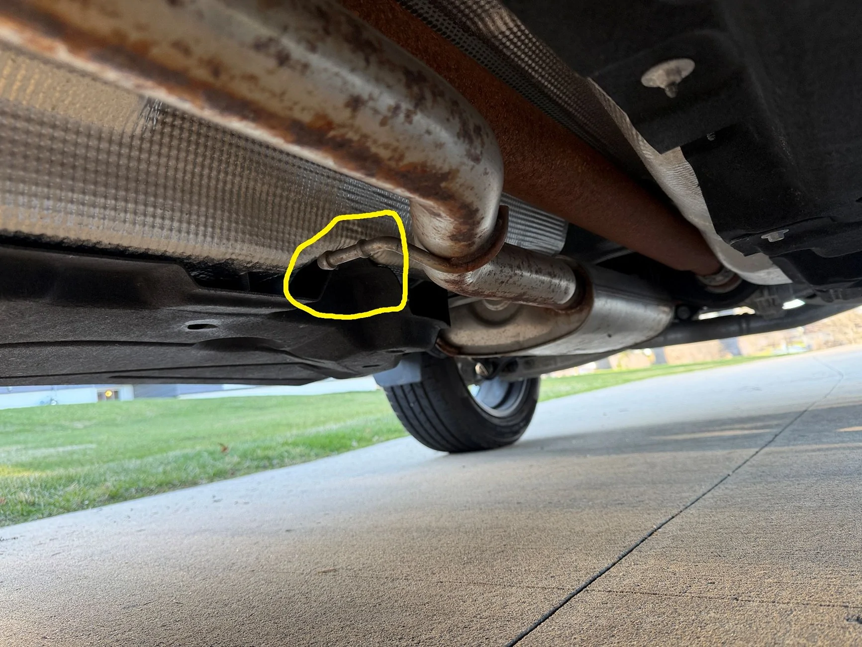

Here is a picture taken underneath the Maverick from the driver side looking towards the rear of the truck. The unused hanger mount is circled in yellow. There is nothing above it on the chassis to attach it to. This would not be my sound problem, but there is a large gap between the hanger behind the muffler and all the way to the cat. You would think something has to give eventually with age.

I just looked at my 2026 Lariat, i can confirm the unused hanger seems to be normal. That seems like a lot of rust, unless it's seen time on salted roads I suppose. The date at the bottom of my window sticker says 12 10 25, I didn't think to look at that on the truck itself when I was looking at the exhaust. This is with 600+ miles, with several trips up and down the very muddy road I live on.
Do both of Your Mavericks have the GPF?
Maverick77, the OP, does not have a GPF. Like me he checked before purchase.
When I cut my exhaust (right about where the mystery hanger is) to install a catback - I was surprised that the long piece of pipe leading to the catalytic converter was unsupported.
Luckily it had a flexible mesh connection at the cat that allowed it to move while I grabbed a box to prop it up. If it was welded it would have been stressed.
Anyway, my aftermarket catback hangs a bit lower than OEM even using the OEM hangers. Another hanger location would would have helped.
