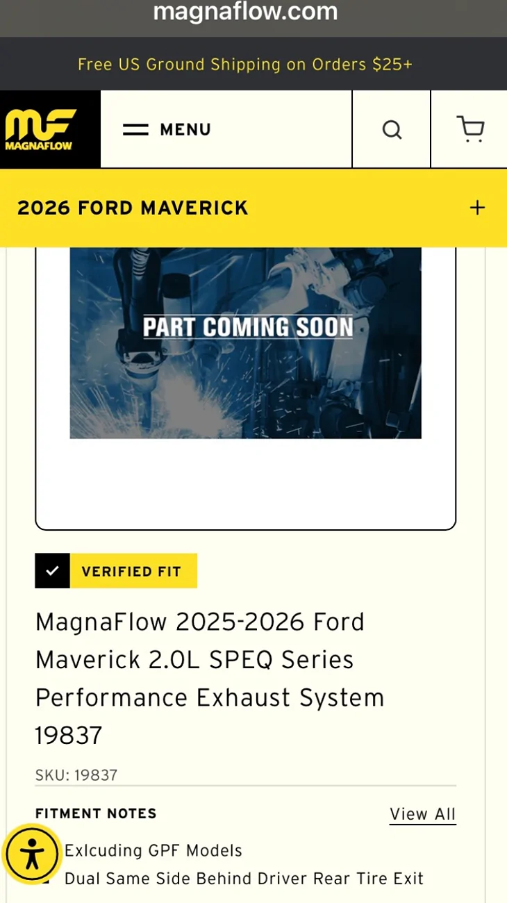

I recommend you look at the “coming soon” Magnaflow Exhaust. It was my first choice - but was not available when I upgraded my 2025 exhaust last year. Installed a nasty loud system instead that I had to add a resonator to make it drivable.
You might already know that Magnaflow is known for its low key rumble. I’m going to consider replacing my still too loud & drony aftermarket setup with the new Magnaflow for the refreshed EB. They offer a system for with or without GPF:
