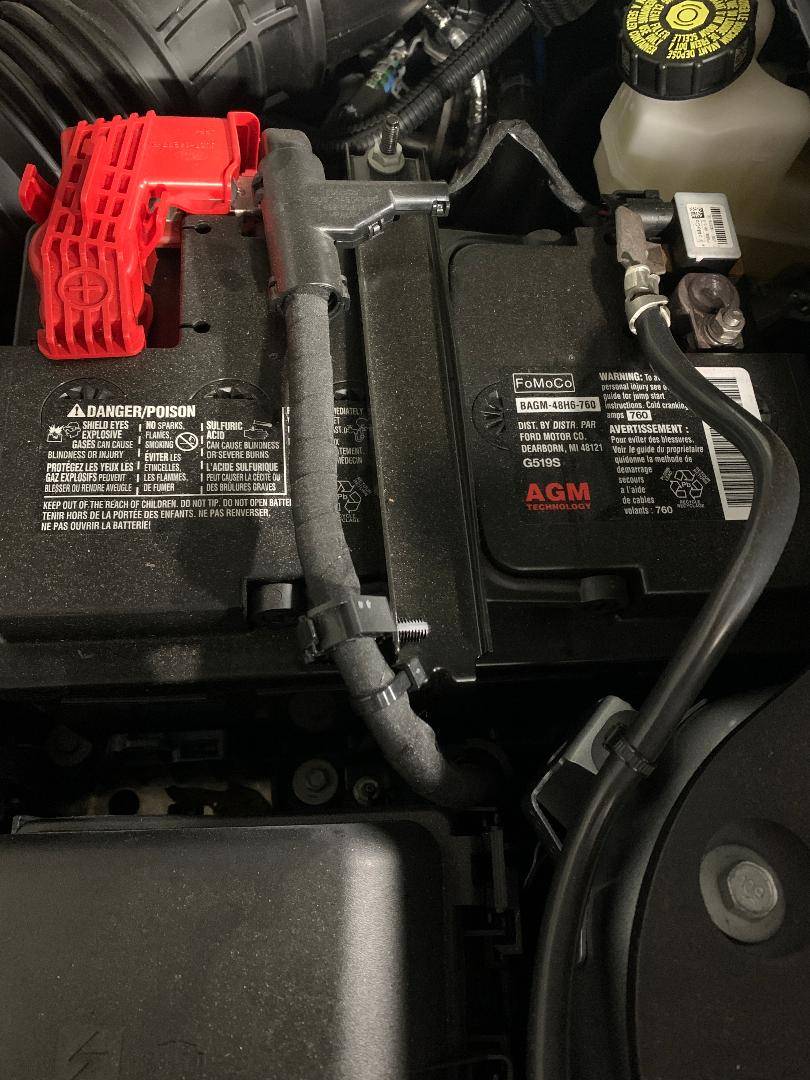

Mine came with a AGM , Apparently. see photo. Have not had any issues, so far. On a 200 mile ride, the voltage read 14.7-on highway or stopped at a light, which seemed odd but I don't know.

Mine came with a AGM , apparently. see photo. Have not had any issues, so far. On a 200 mile ride, the voltage read 14.7-on highway or stopped at a light, which seemed odd but I don't know.
Yours is not hybrid, gas engine normally has no battery issue ?
It does. There's a hardware issue on the EcoBoost and a software issue on the hybrid.
Afaik, there was actually a recall on the Ecoboost batteries, and the fix was replacing it with an AGM.
I may also be uninformed on what the actual fix was, so if that wasn't it, anyone may feel free to correct me.
JimG-24
Apr 17, 2025
2024 maverick xlt
Ok, I am not well informed, I thought hybrid car will continue to drain power from 12V battery, mismanagement or "bad" battery caused these issues, like deep sleep ect, but not for the ecoboost engine, looks like I am wrong.

For those commenting wondering if what you heard is right.
A range of EB's (ICE only) were made with FLA's included - and they ended up being a problem with actual defect.
That is the recall - to get AGM's put in like rest of the EB's got.
It has been observed to have some charging strategy issues - because it has the same functions as the hybrid when off - listening for remotes to unlock, powering door sensors if keyless entry, reporting up to Ford on turnoff, and a ping every hour to keep the cell network up for remote access (startup/unlock, ect), ect.
You'd be hard pressed to not find a vehicle with a bunch of things constantly running to some degree.
AGM just handles that better.
