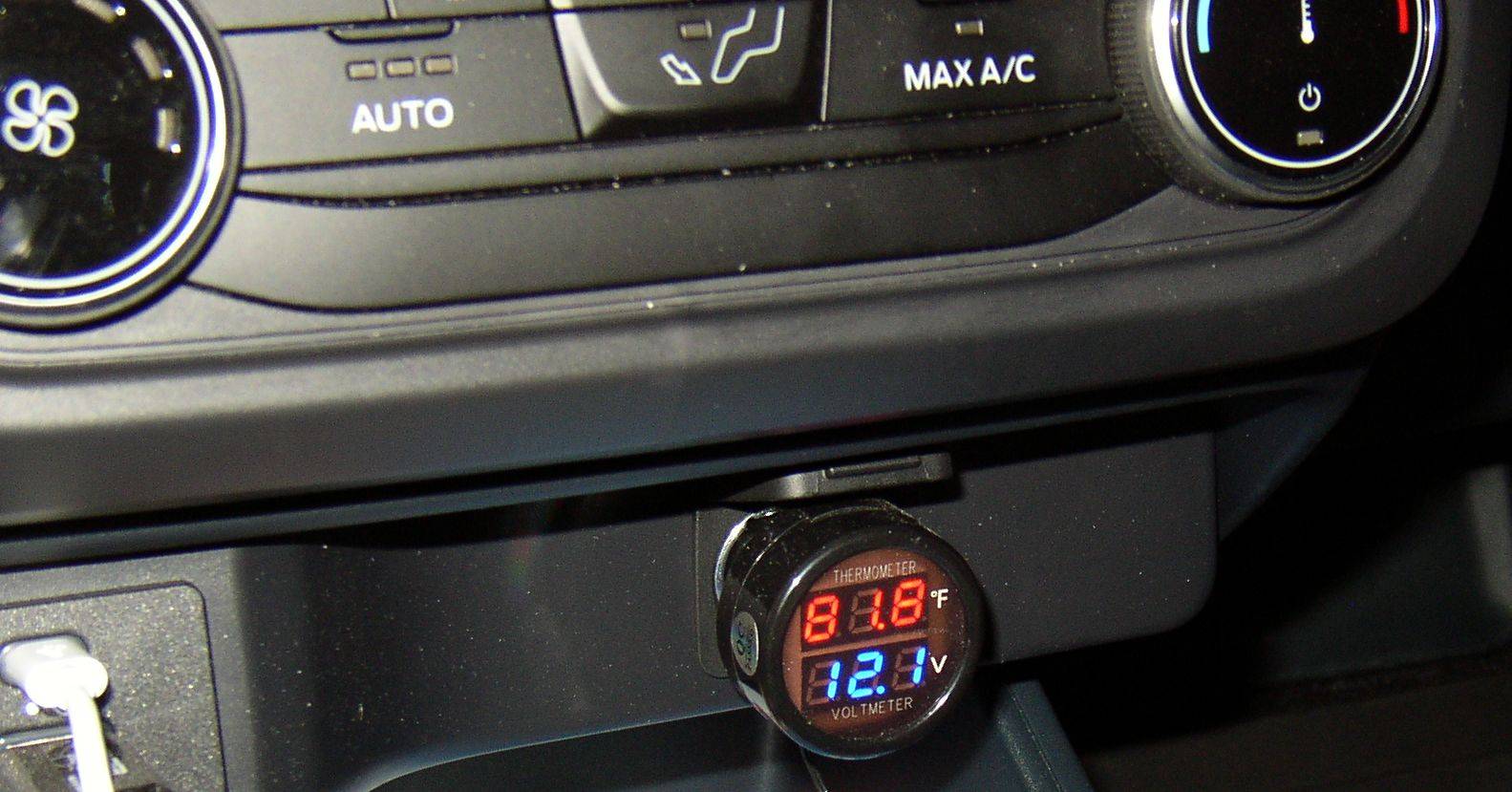

The problem with that is: that socket does not power up until you turn on the ignition or at least the accessory power. Then the 12v battery is getting power from the inverter. You need to be able to get a reading before even opening a door to get a good indication, if possible.
This is partially incorrect information.
It is TRUE that you have to turn the key to get power to the accessory port.
However you are wrong that in "accessory power" the DC-to-DC converter supplies power.
With the key turned partially to "accessory power" and not all the way to "Ready" the accessory port will show actual battery voltage.
Accessory Mode showing 12.1 volts from the battery.
It is a good idea to check battery voltage in the accessory mode as it puts a small load on the battery.

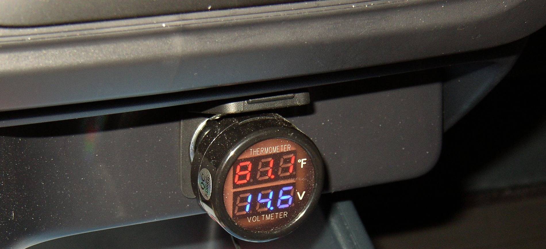

When the key is turned fully to the "Ready" state the DC-to-DC converter supplies power.
Ready Mode showing 14.6 volts from the DC-to-DC converter.

At least on mine there is some slight voltage rise in accessory versus the battery actual voltage. Possibly bleedover from the precharge capacitor?
(And, pedantically, it's a converter not an inverter since it's just stepping DC to DC)

At least on mine there is some slight voltage rise in accessory versus the battery actual voltage. Possibly bleedover from the pre-charge capacitor?
The pre-charge capacitor I know of is for the HV battery so that the contactors do not spark when closed.
I have not heard of a pre-charge capacitor for the 12 Volt Battery.
Correct, it's for the HV side. But the DC-DC seems to outputting something even though in theory the main HV contactor shouldn't be closed yet. Just double-checked and it'll go from 12.3v resting off to >14v in accessory. Measured at the under hood terminals.
