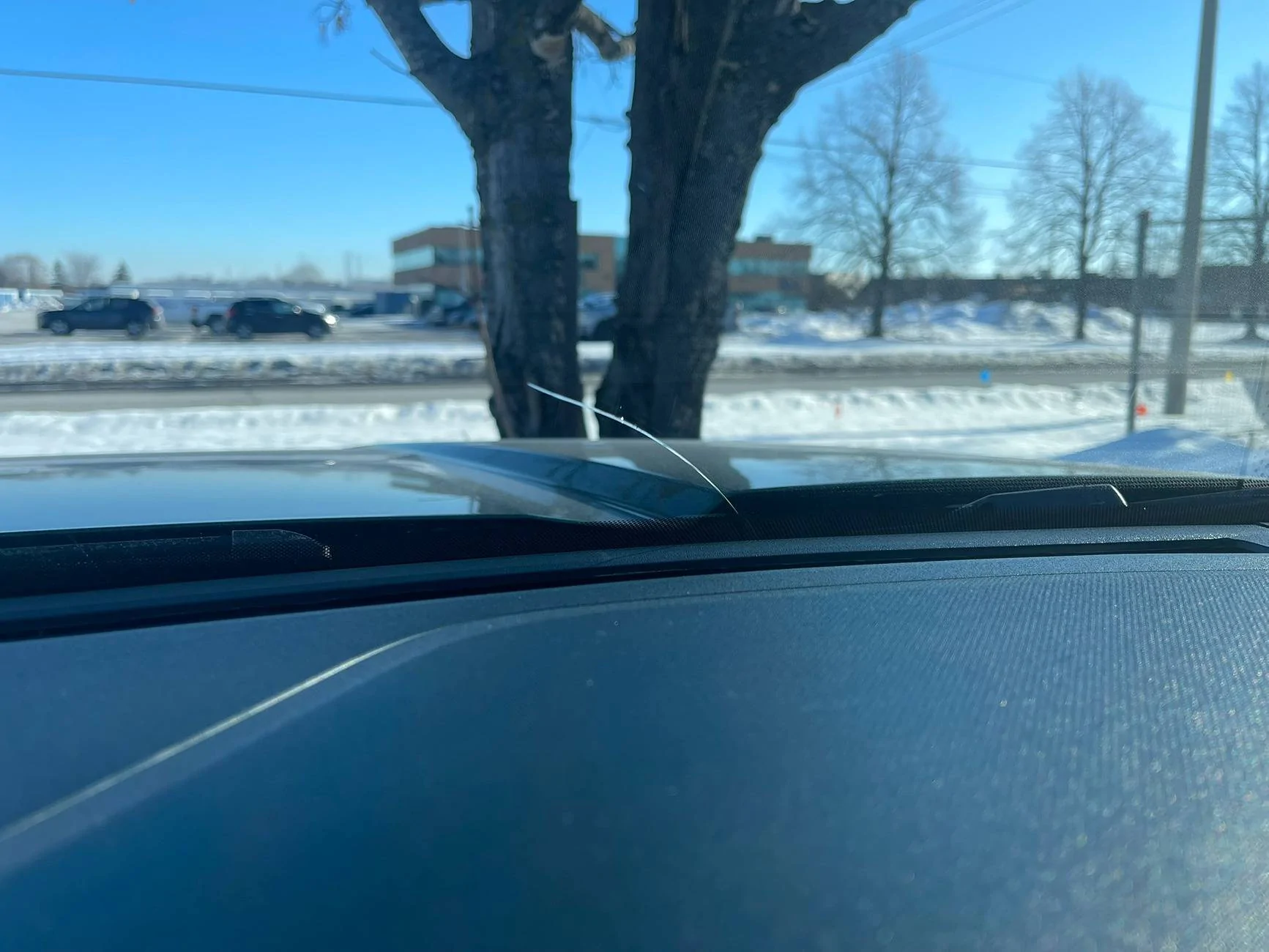

Next time you get a crack in a modern lightweight windshield, do that pen test. What you'll find is that the pen will stop in multiple places because the top glass layer will flake and chip off along the length of the crack.
It doesn't matter if the crack is due to stress or a rock: a cheap windshield will always fail a pen test at several places along the crack due to the top layer of glass flaking. Whether or not it is intentional, the pen test cannot rule out a stress fracture and should not be the standard used to deny warranty claims.
All that said... the Lariat windshield would be great but it's also on manufacturer backorder. I'm just going to have to enjoy this crack for a few weeks.
