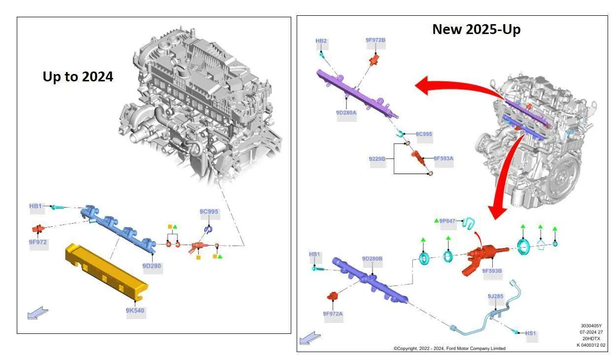

Here is some info:
Ford Maverick What are the specific differences/improvements in the 2025 2.0 Ecoboost engine and the 2022-2024 engine? 1742773195994-cl

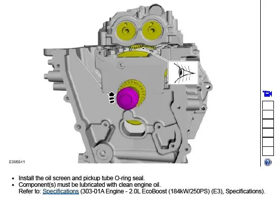

I'm also happy about the gear driven oil pump instead of a wet belt. I was amazed how low key of an introduction this motor was.
Ford Maverick What are the specific differences/improvements in the 2025 2.0 Ecoboost engine and the 2022-2024 engine? 1751546939054-z6
