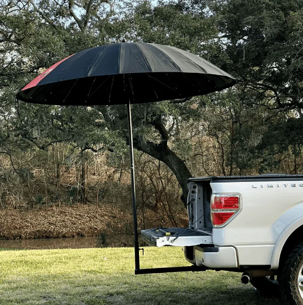

Pipeliners Cloud umbrellas. Not cheap but rated for 60mph winds for the 8ft and 40mph for the 10ft. Some are also flame resistant. Cool company. Welders who make stuff for welders, that the rest of us can enjoy.oh that look great too. i love all the stuff available for a hitch.
