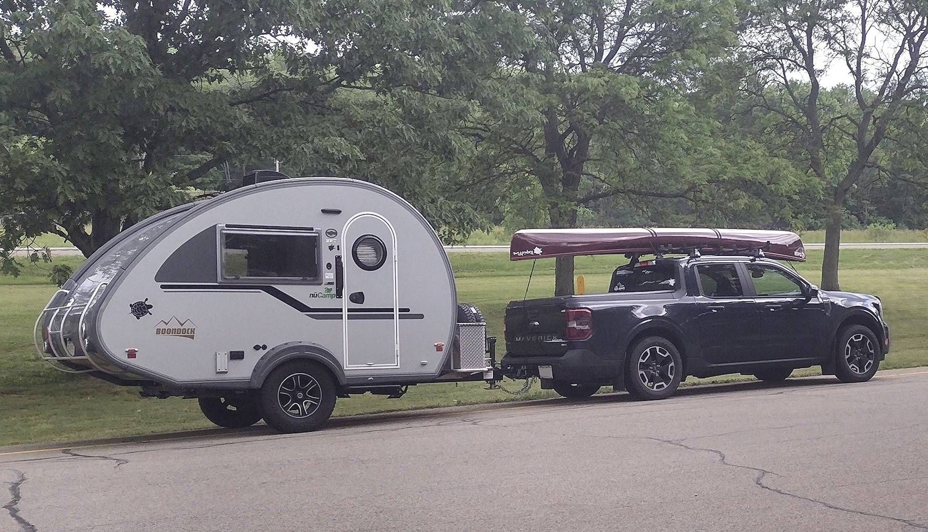

That's an alternative. Will also prevent my wife from making me get an even bigger camper. :)
I liked the smaller one we had but she didn't.
I'm trying to figure out why your truck looks so good. Is it lowered? I don't know if it's the wheels or what but it looks great for some reason

Out of curiosity, what was the weight on the teardrop you previously had? I know some of the 'tiny' teardrops come in well under the 2000 lb limit for us non-4k owners, and just curious what those weigh.

The problem is the water tank is up front and not over the axle. filling it for boondocking adds almost 160 pounds forward of the axle and puts me close to the hitch limit of the Mav. For now we carry the water in the Mav if we can't fill with fresh water at our spot. Was just hoping the Ranger would be the answer but at that low MPG no way.
Get a 10 gallon water bladder and pack it in the back of your trailer? Fill your freshwater half full for the road and transfer the 10 gallons into it when you get to the campsite
That'll shift about 80 pounds from the front to the back and should give you a more manageable tongue weight
I use a weight distribution hitch to reduce sag and transfer weight to the front, but that's another debate

2,200 Lbs dry.

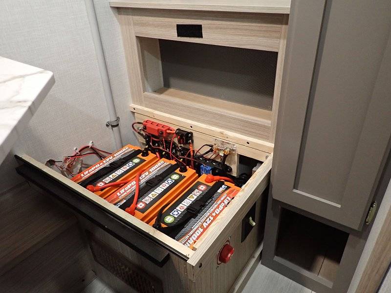

Already do that but would like to avoid carrying extra containers and putting more stress on the rear floor and frame frame of the camper where most of the bounce is. Already moved the battery from the front tongue to the back (installed 3 100ah in the back).
