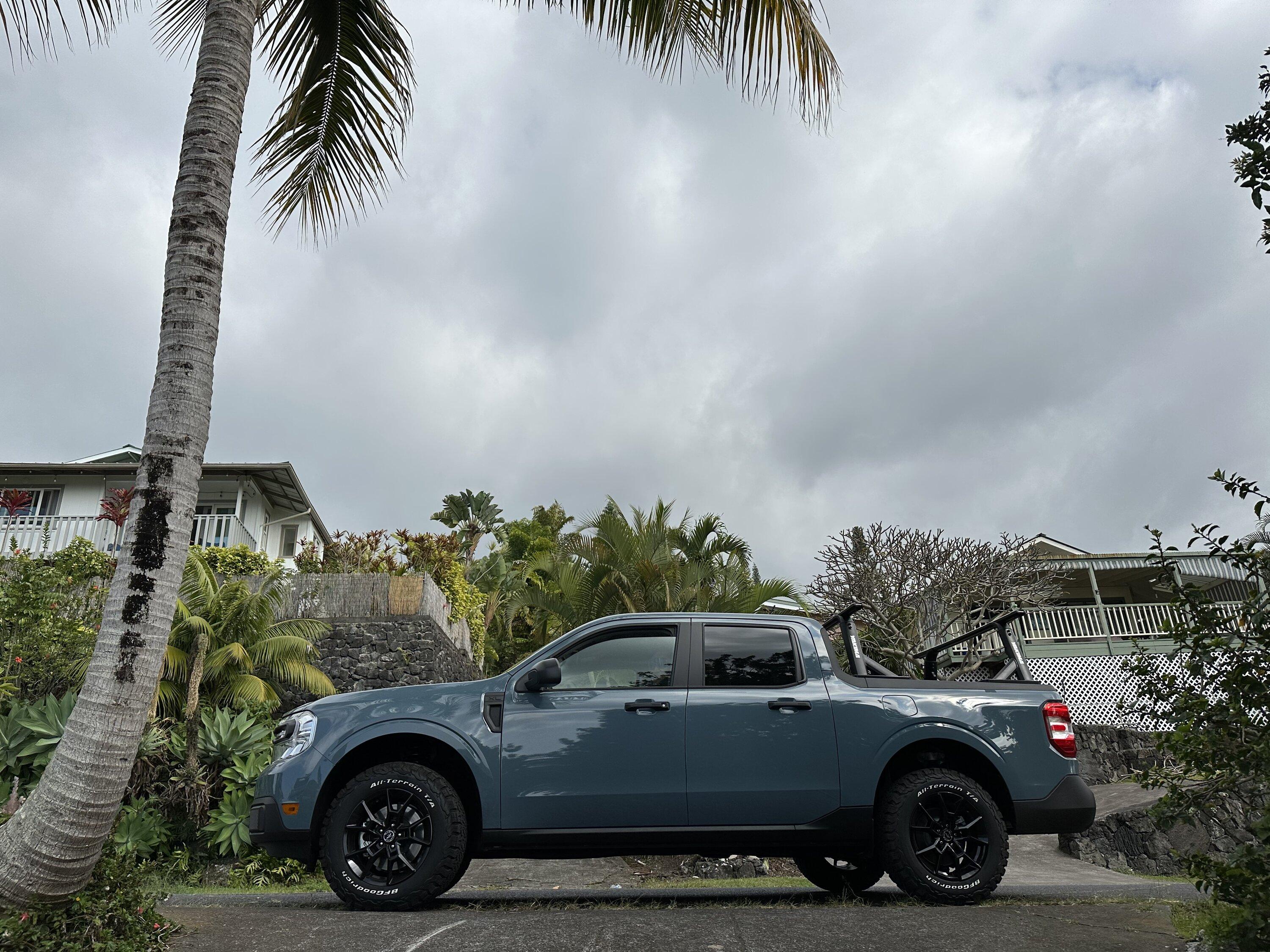

Stock height put BF Goodrich All Terrain Koa 245/65/17. Tight fit but cleared no rubbing. The added 1” level to be safe fro m Rough Country
