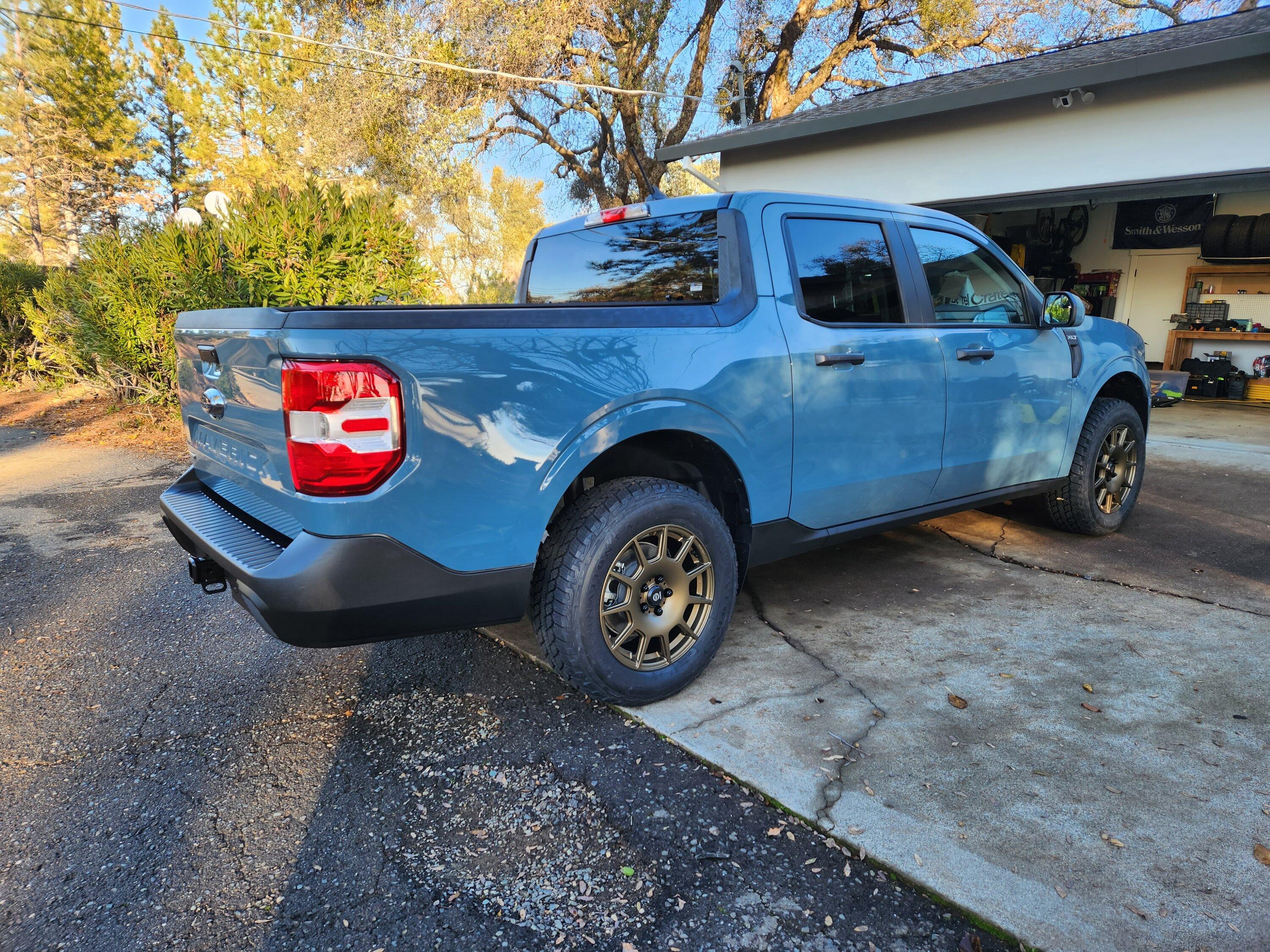

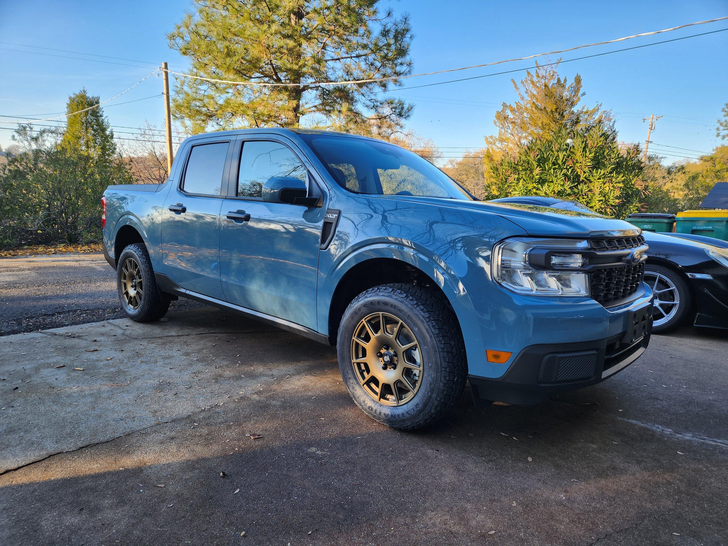

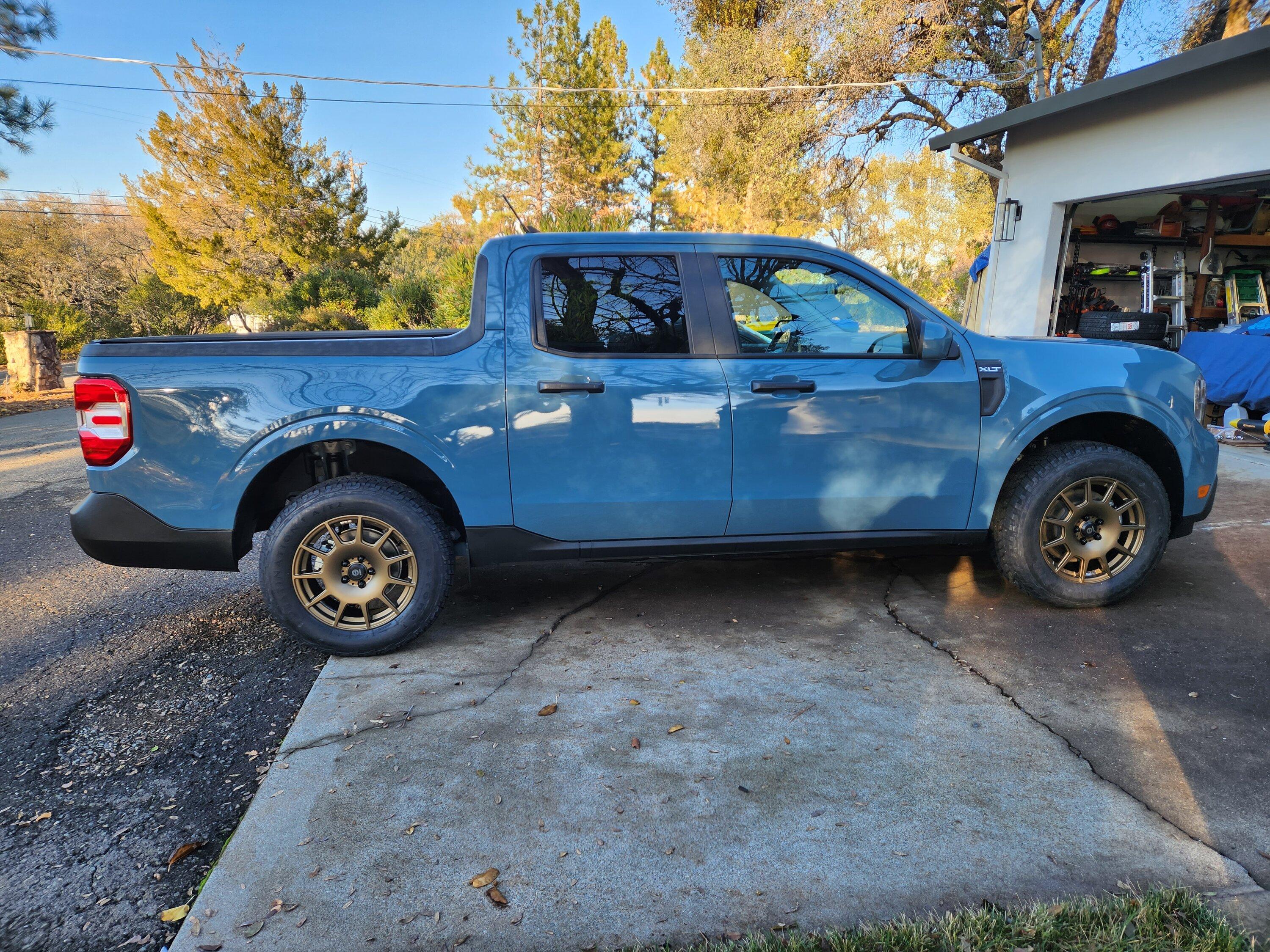

235/65R17 Firestone Destination A/T2 mounted on 17x7.5 Sparco Terra in bronze.
About a +1-2lb weight difference from stock since these wheels are substantially lighter, and these tires supposedly have a very low rolling resistance for the class so I'm interested to see how this affects mileage (Hybrid).

I think Area51 and brass wheel looks the best. The sparco terra are perfect. Did you have any other bronze wheel in mind aa alternative?
I agree I love the look! Very happy with the little Hybrid now.
I looked at some of the other Sparco wheels and a forged set from Vivid Racing, but the weight and price of the Terra was too good to pass up. There are better looking wheels but these are an excellent value.

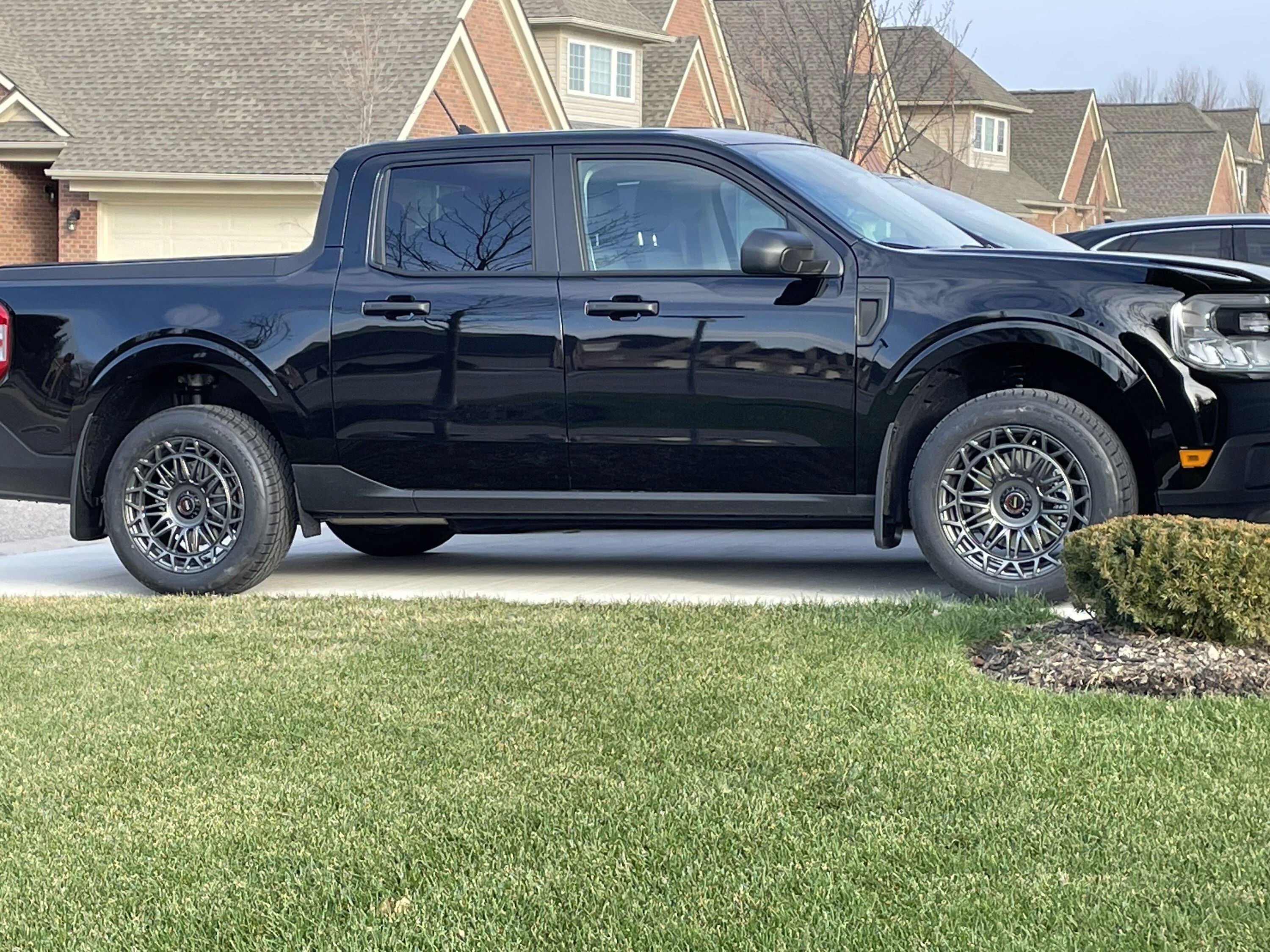

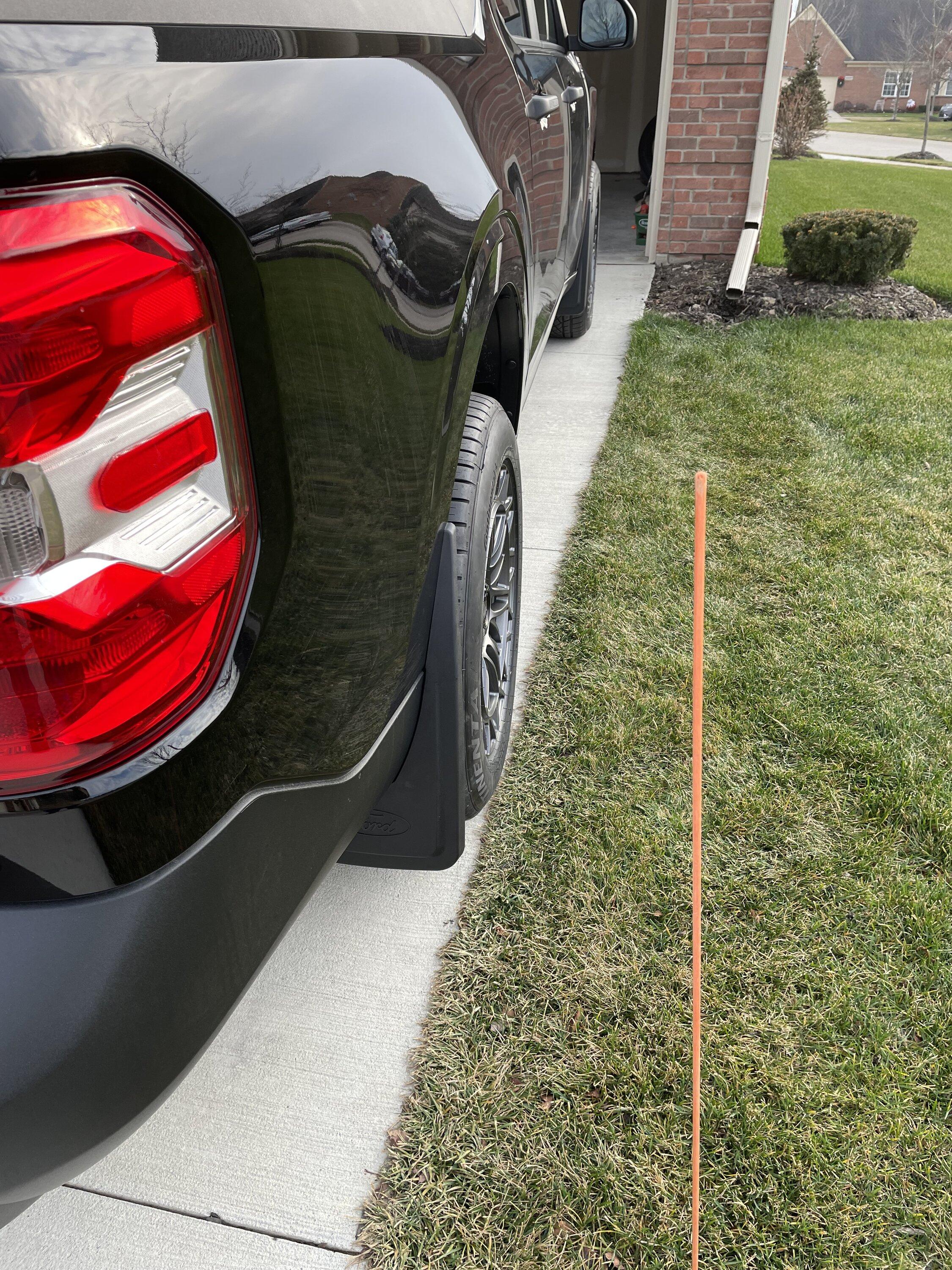

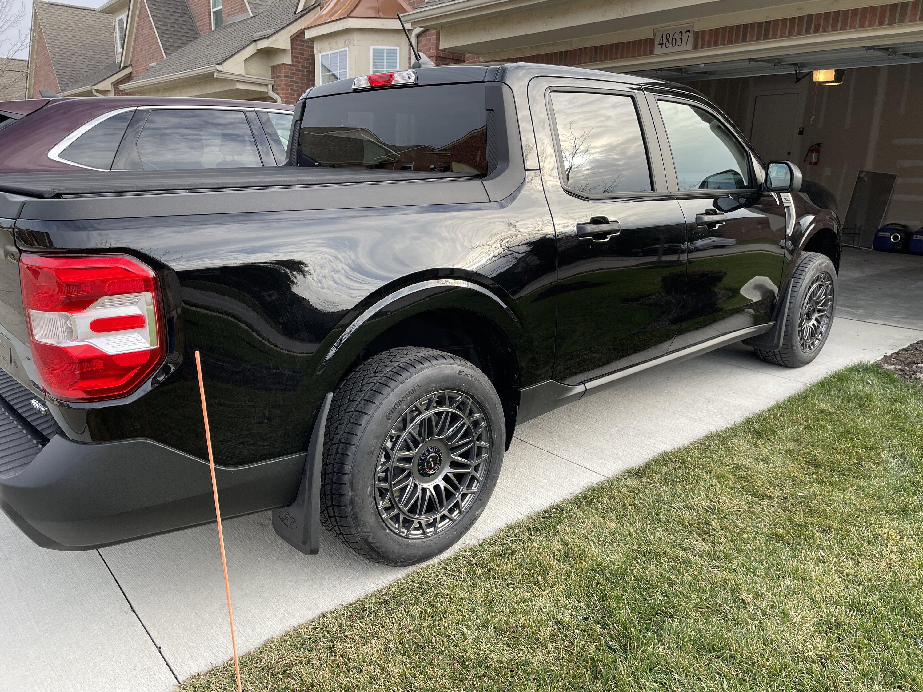

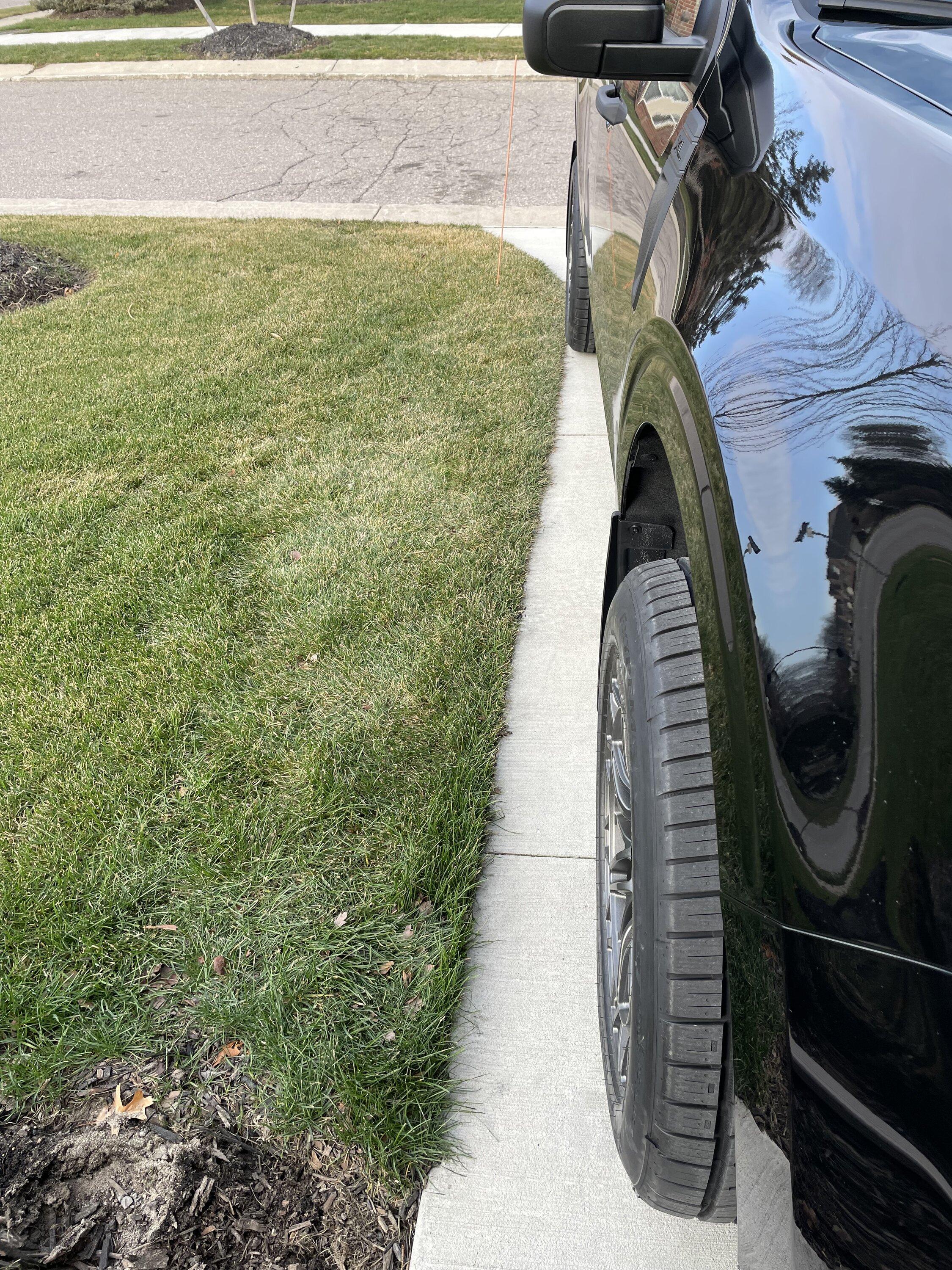

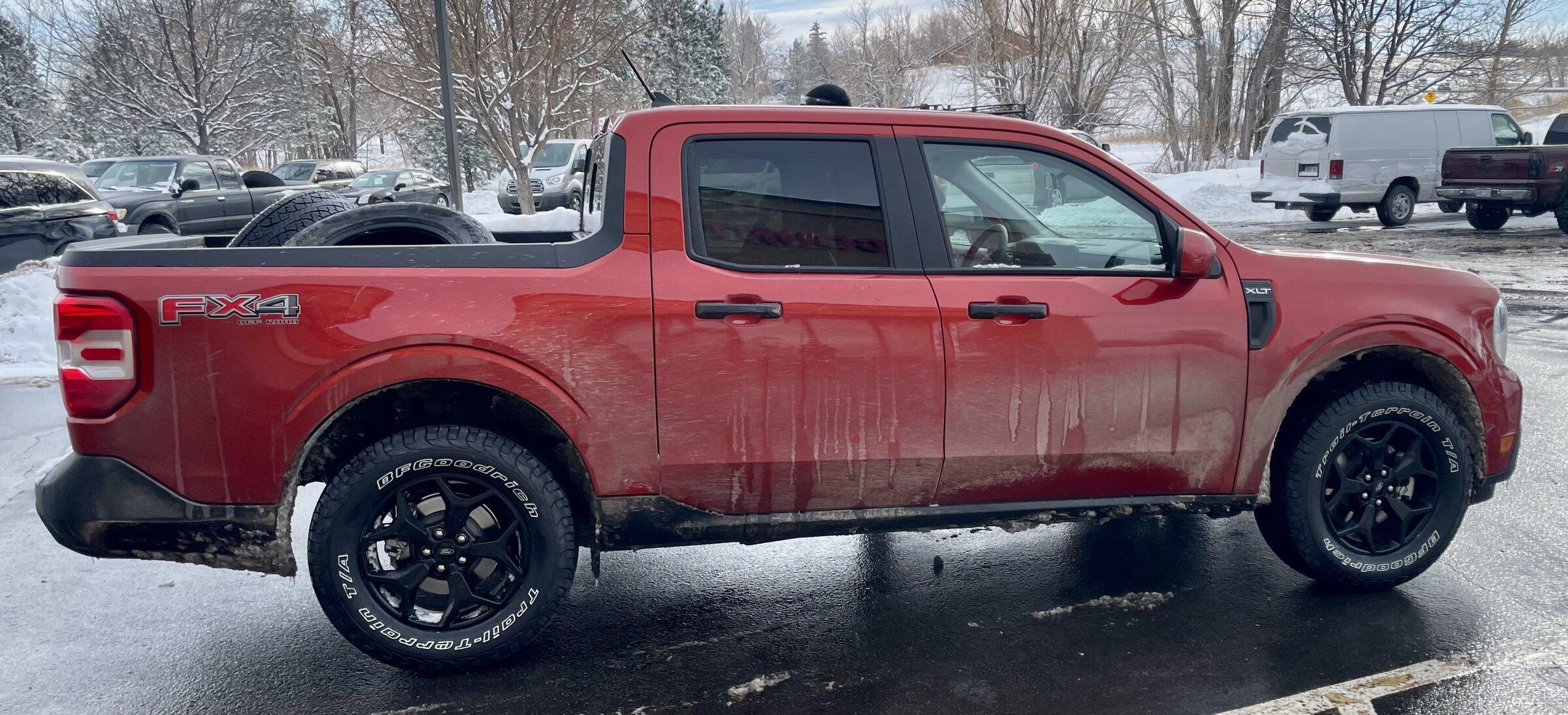

245/55/18 extreme contact dws06 2 on 18x8.5 38.5 offset momo racing Bernina
Ford Maverick Visual Comparison of Different Tires / Tire Sizes on 2022+ Maverick IMG_1773
Ford Maverick Visual Comparison of Different Tires / Tire Sizes on 2022+ Maverick IMG_1772
Ford Maverick Visual Comparison of Different Tires / Tire Sizes on 2022+ Maverick IMG_1771
Ford Maverick Visual Comparison of Different Tires / Tire Sizes on 2022+ Maverick IMG_1770
Ford Maverick Visual Comparison of Different Tires / Tire Sizes on 2022+ Maverick IMG_1769

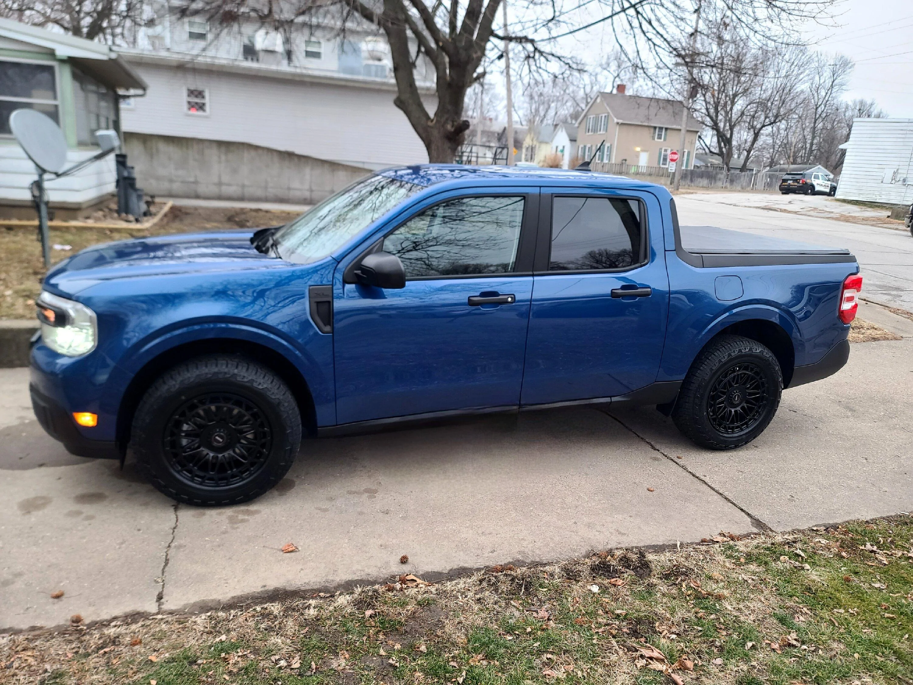

Don't think I've noticed OWLs on an Alto Blue or Black so wanted to share. Suspect some may not like the look.
245/65/17 Trail Terrains. Happy with the upgrade. Will see if we are going to do a lift still.

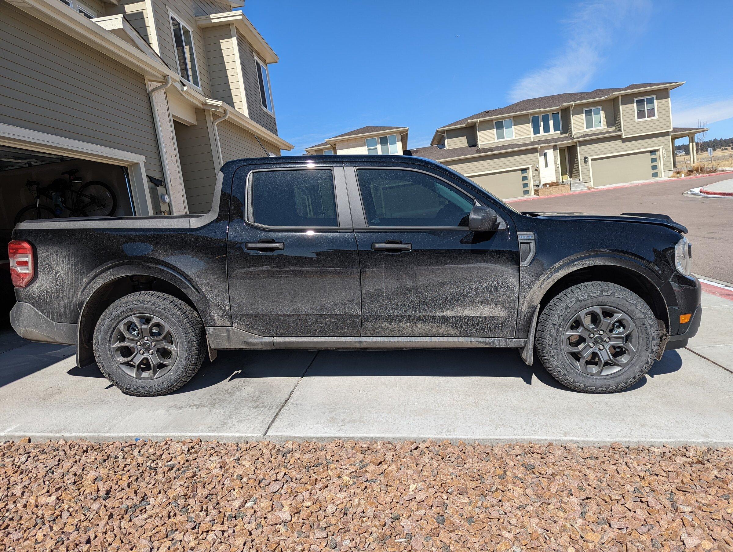

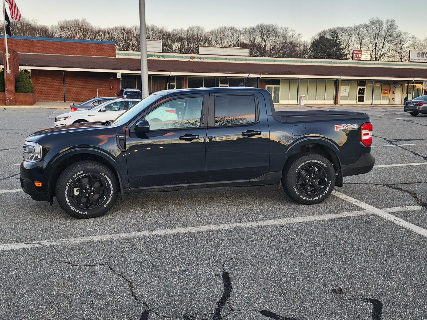

Dextero 245/65/17 All Terrains
Stock Height HYBRID 😁
Now that you've been running these for a while, any regrets going bigger size and all terrain with the hybrid? Looking to go same size (bfg trail terrains) with my hybrid and scared it may affect the benefits of the hybrid too much...
As you might guess, a bigger heavier tire with wider contact patch is going to leech away at the hybrid MPG, but the offset is the benefit of improved traction in the dirt and the nicer appearance is worth it. Since I WFH, I don't drive every single day, so mpg is not the end all for me.
It really depends on what you mean by "too much". I'm not a hyper miler or a Climate Activist, so I'm fine with it.
Good luck on your decision.
