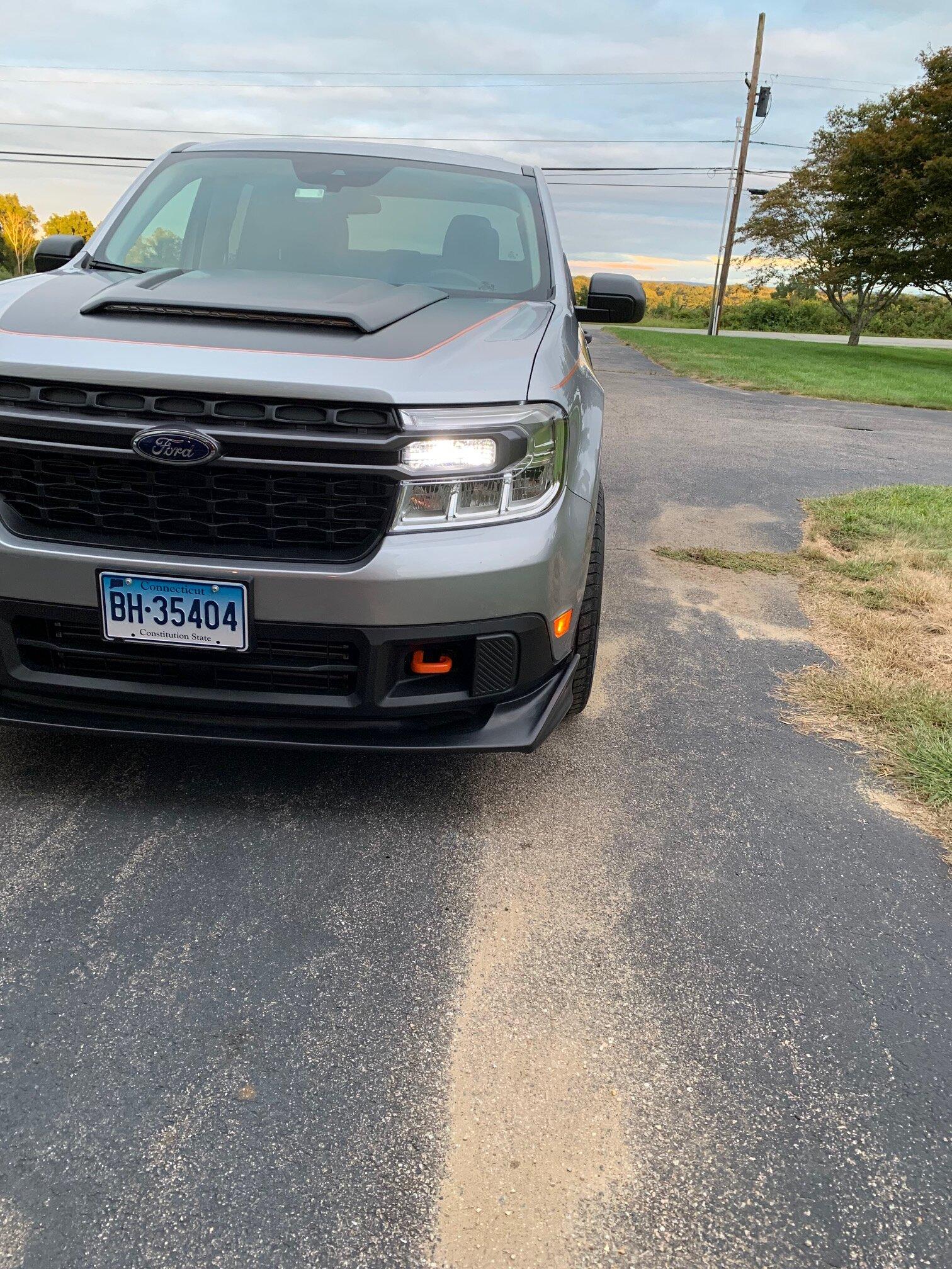

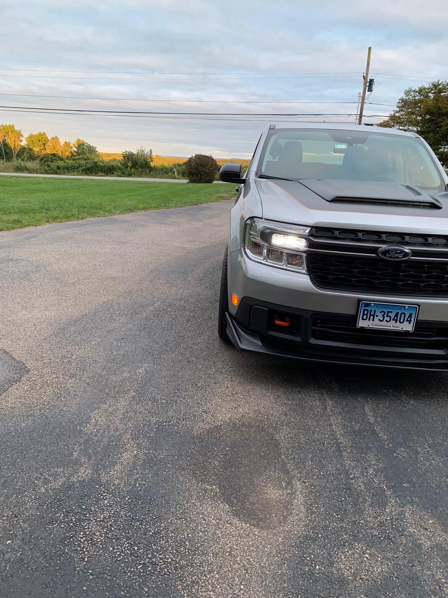

Thanks for that. I'd love to see a head on view to se how much stick out there really is. I just ordered a set of 20x9 +35s so they should be really close to what you have too.

Yes ,I should have said spacers for the rear. Yours @ +35mm theoretically will stick out 3 mm more.
I'll take a pic this afternoon.

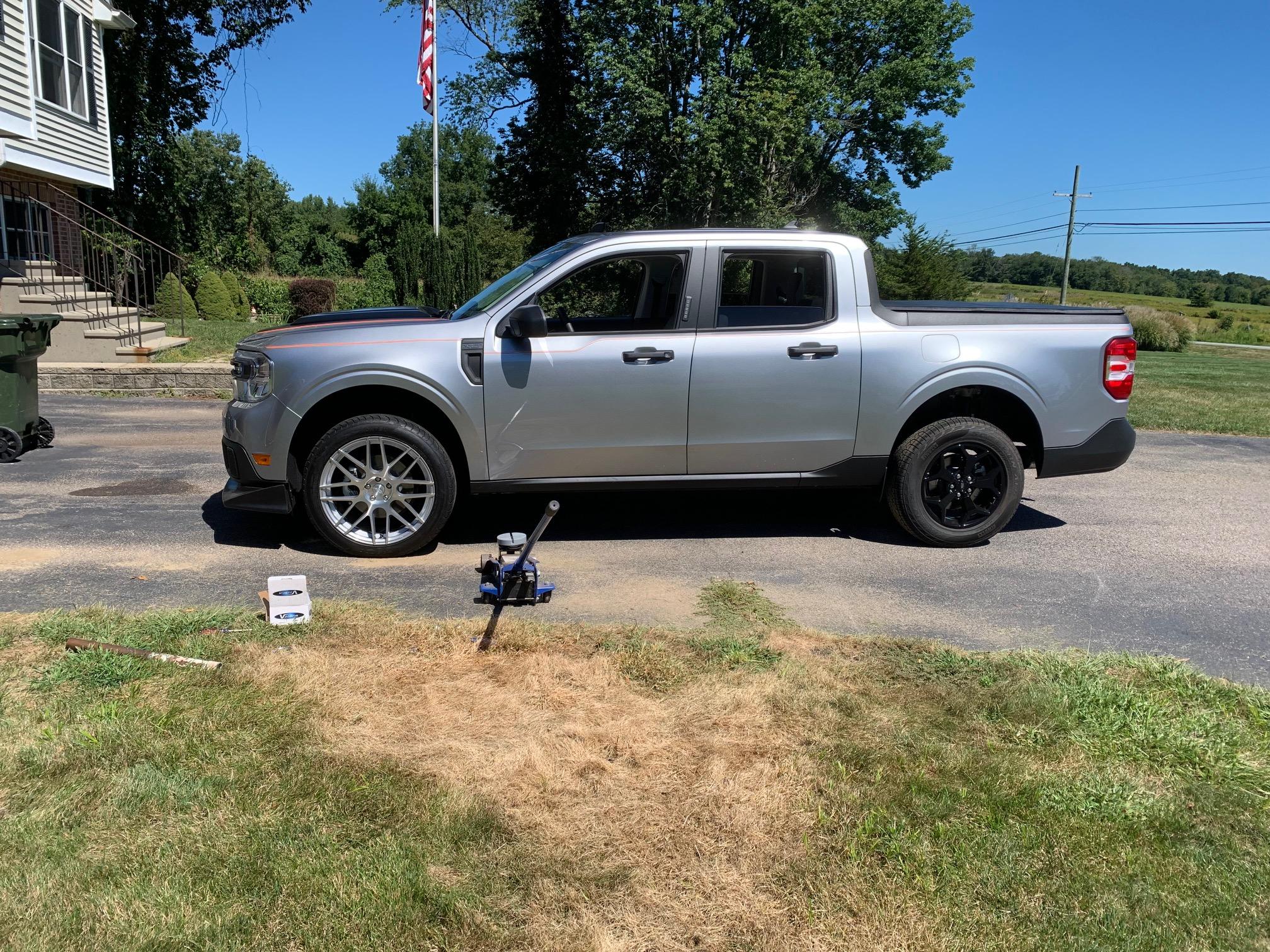

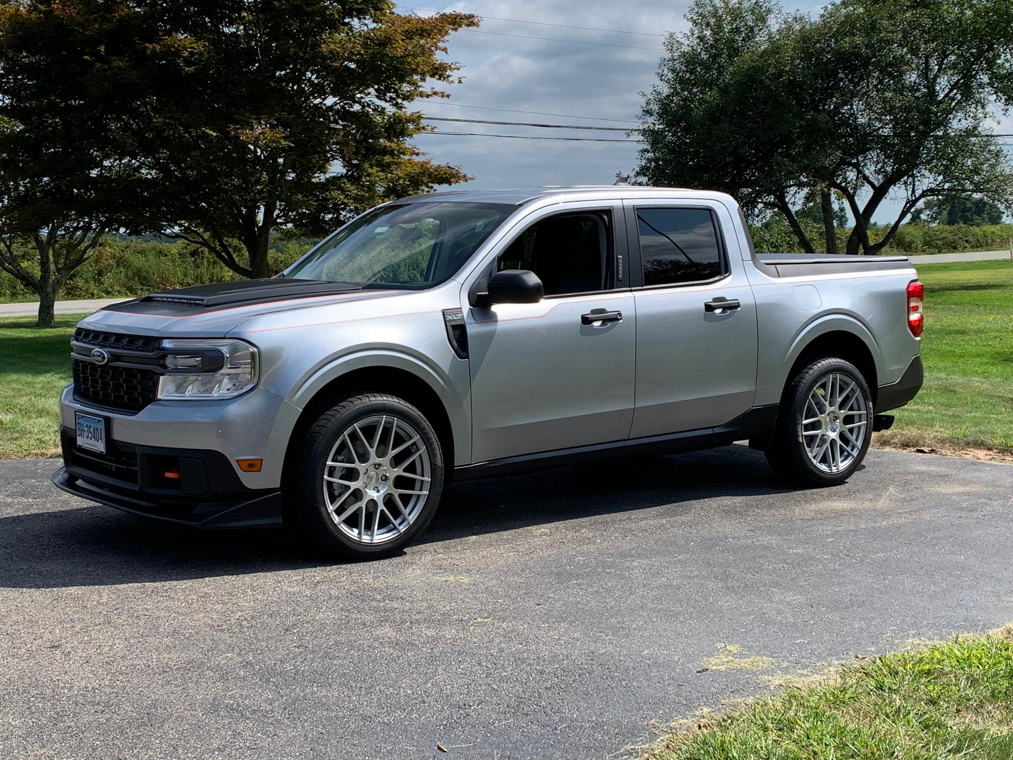

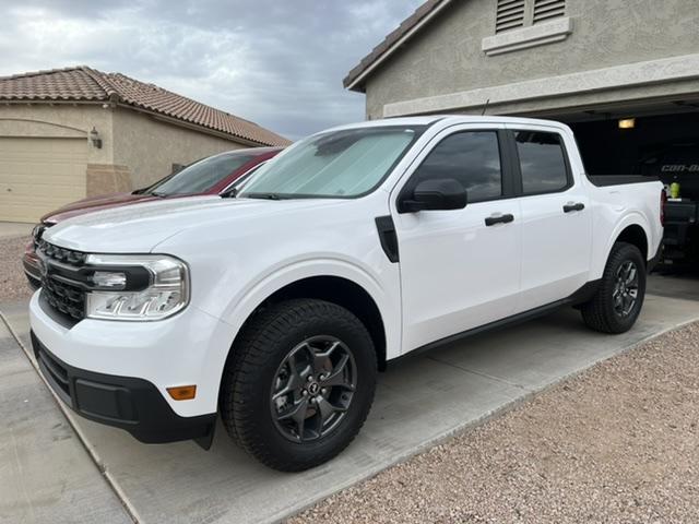

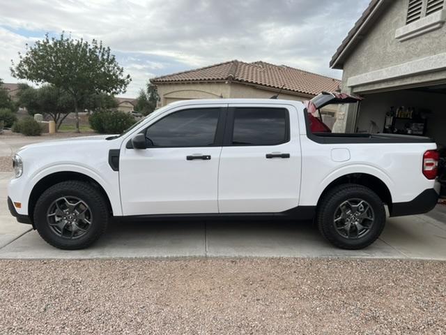

Here you go...
Thanks for that! Would you be able to get a shot looking down the side from the front, so you can really see how much the wheel/tire sticks out? My wheel order is on hold as another options is available and I want to pick the right combo for my goals. Thanks again!!!

Here you go

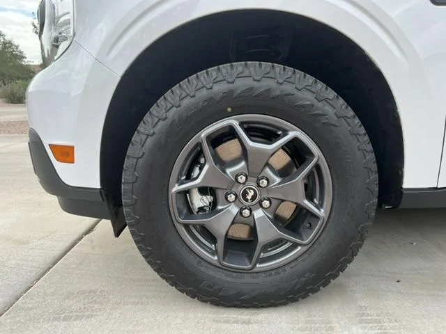

Thank you so much for this. I'm now sold on 255/65/17

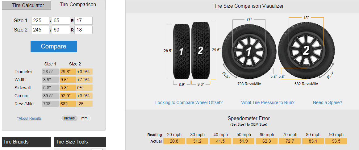

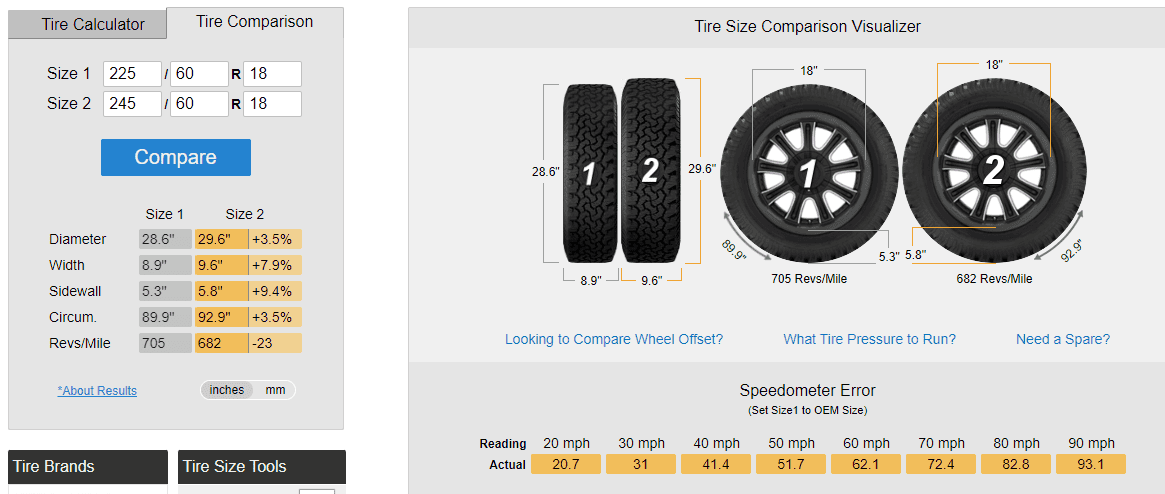

I just tried 245/60/18 and they touched solidly on the liner. Should be exactly the same size.
So confused...
Interesting, as that is the size I'd consider going from stock.
Surprised to learn a 1" greater height would cause any rubbing at all.
I like the slight width and height increase just for ride comfort to absorb more road imperfections. I'd have the 4K tow kit which yields a lower differential ratio.. so I'd be clawing back all of that torque loss difference and it would have result in engine to wheel rotation on par with that of a non 4k equipped truck... Speedo would always be off though as I don't think ForScan would permit dialing in a non-spec value.
Anyway, disappointed to hear you are touching.... I guess I would consider a mild 1" front 1/2" rear lift that would serve as a bit of a leveling lift... so that should negate any rubbing concerns.
I'll have to keep looking at other 18" posts....

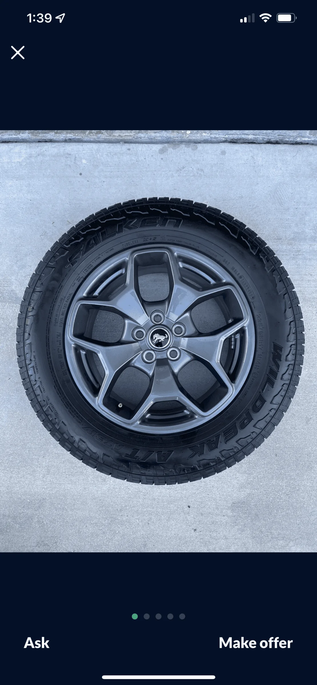

You are so right! I have a set of 235 65R17 WP and Bronco Sport wheels waiting my CG Maverick! Basically the FX4 setup in Grey to match the CG truck.
Did you ever throw these on the CG maverick? I want to see a pic. Planning on possibly trying to do the same.
Nope, still waiting on the truck. I will update as soon as I get them on.
