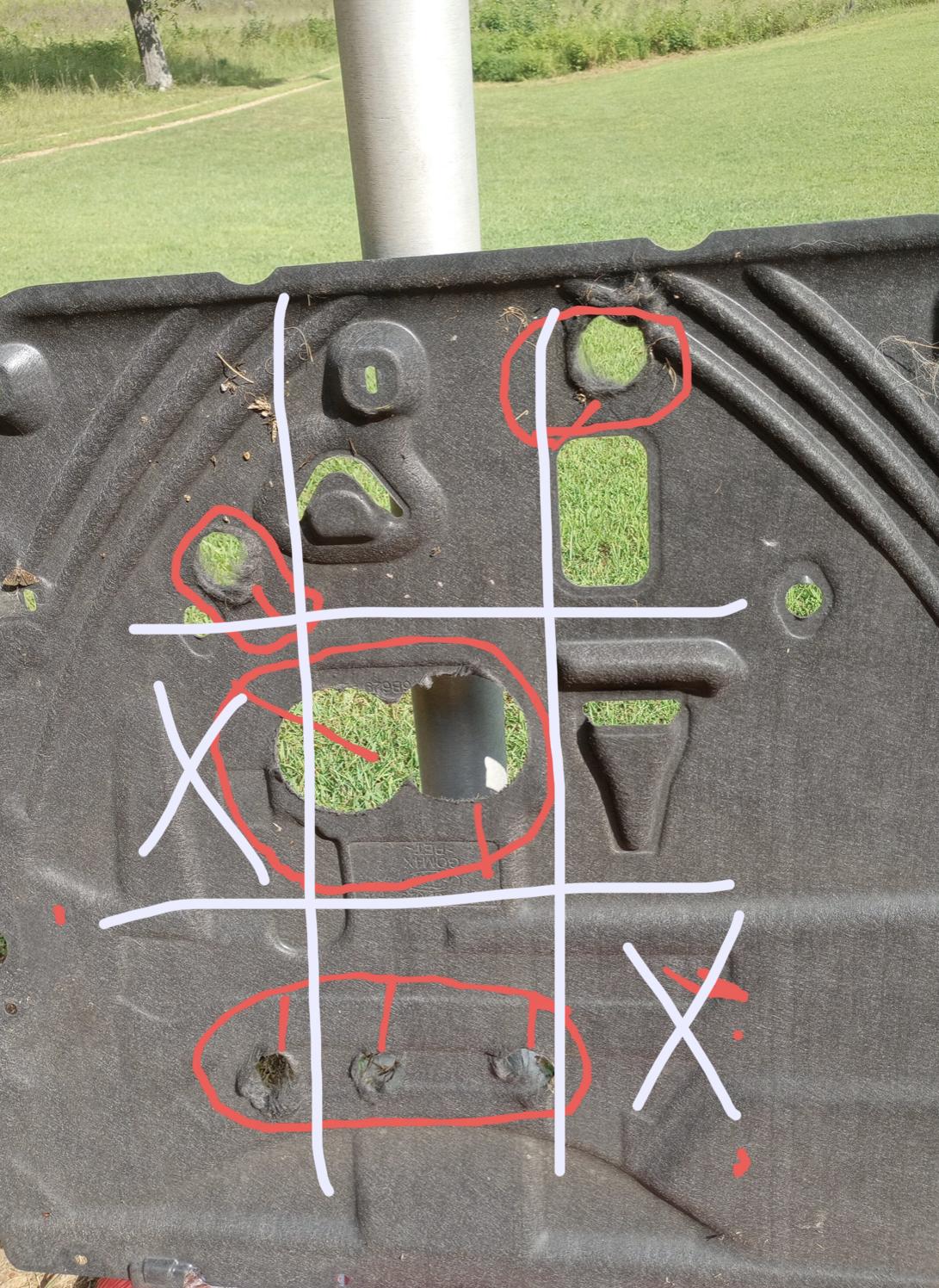

Ill try to post a pic later, but i just checked underneath my maverick and the holes on mine were better cut than the original poster…. On his it looks like they did it with a pair of child rounded scissors. they obviously outsourced the job to some dude who outsourced to another dude who gave the job to his kids.

A Ford tech posted his version of the repair on reddit. It looked like shit and I called him out on it. Now I see how much worse it could have been.

There are some other threads on this fix, where the factory diagram for the holes is posted. I did it myself because of pictures of a dealers hack job someone posted. If you take your time, use a hole saw to radius the corners of the larger cuts, and use a block of wood under the drill bit, it turns out fine. The fuzz cleans up with a razor blade.

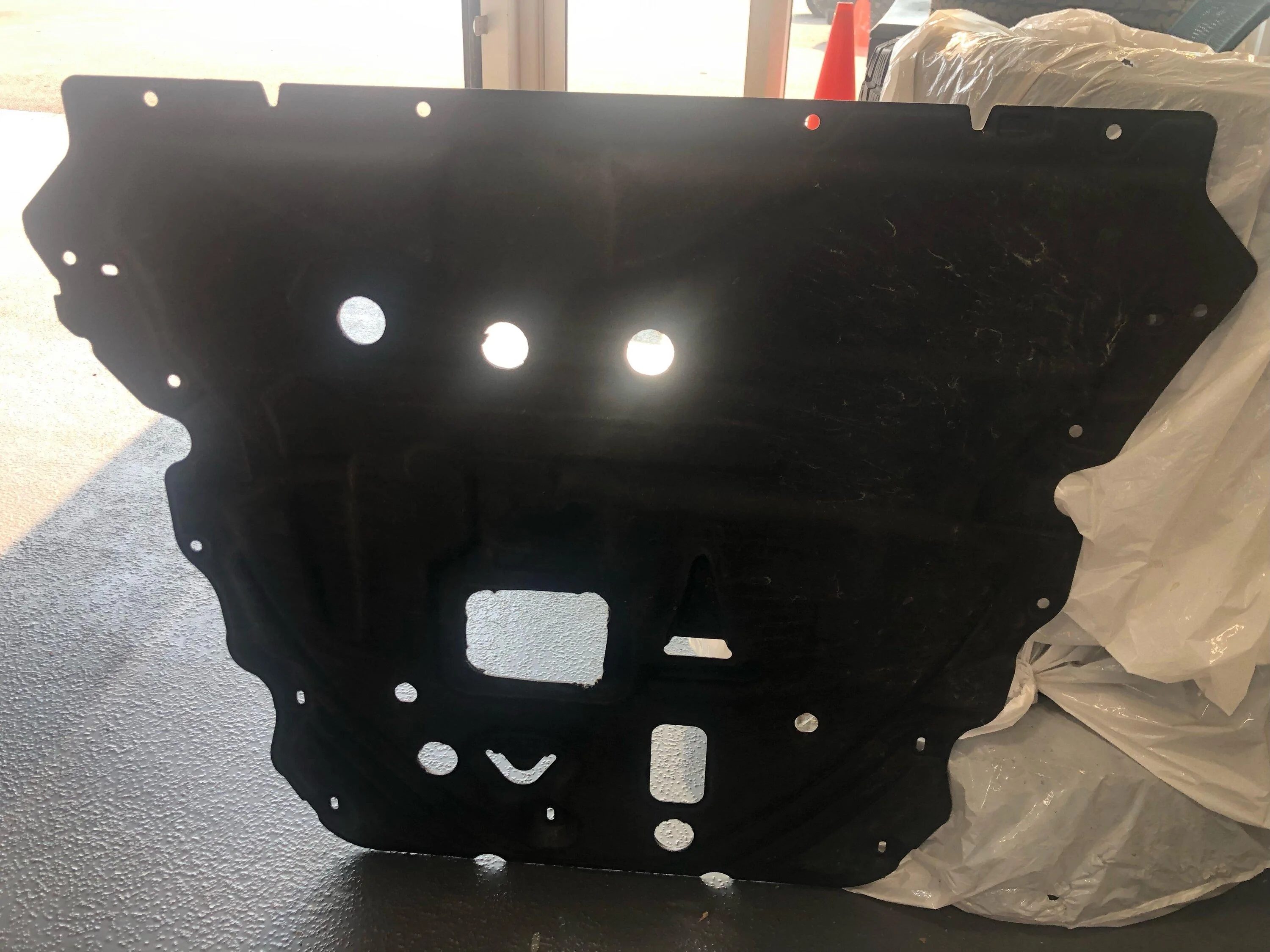

I have a Maverick hybrid the recall for the bottom Pam to drill holes in it was done at the factory in Mexico . In my opinion and I know everyone has one I think a 1st grader could of done better job !!!!! 👎🤔. Holes are not straight not even close and the material is very hairy and they left all kinds of fuss or what ever on the holes and I think they took my Maverick in a field or something when I took the pan down to change my oil all this grass fell out of the pan and it's never never been off road never !!!! the grass it self could of caught fire .🔥🔥 Also the fussy hair stuff burns real good and fast . I hope I'm the only one but I thought I let all of you know . Very poor on Ford quality control.
I am wondering if the metal pan being used for the 2023 Tremor might be a better fix? Will it line up to the same fasteners and holes that are used on the Hybrid fabric material pan?
