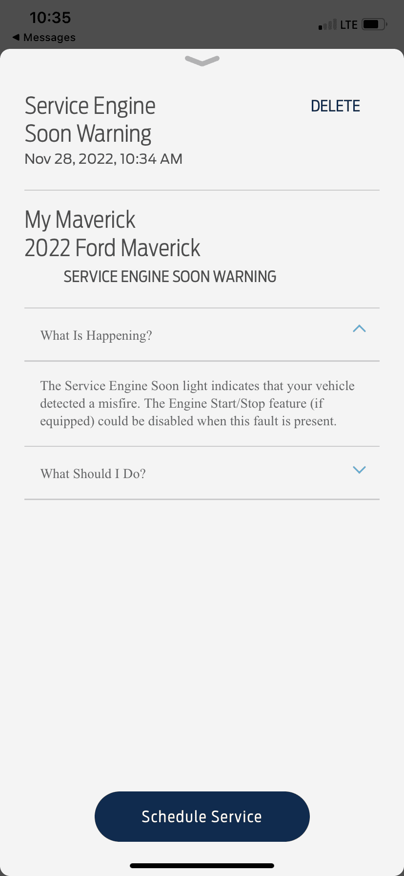

Last week I made a post about my Hybrid with rough and loud idle. The engine would shake terribly and a check engine light for a misfire. Well I got it back today and wanted to post the fix (hopefully) for anyone with a similar issue.
