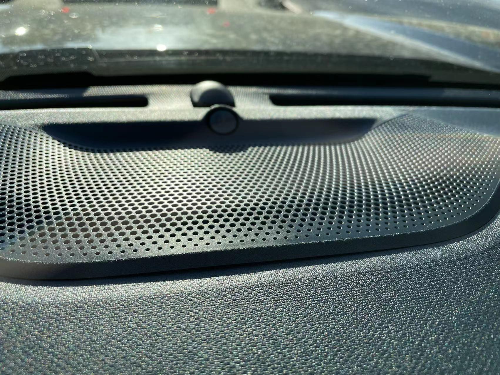

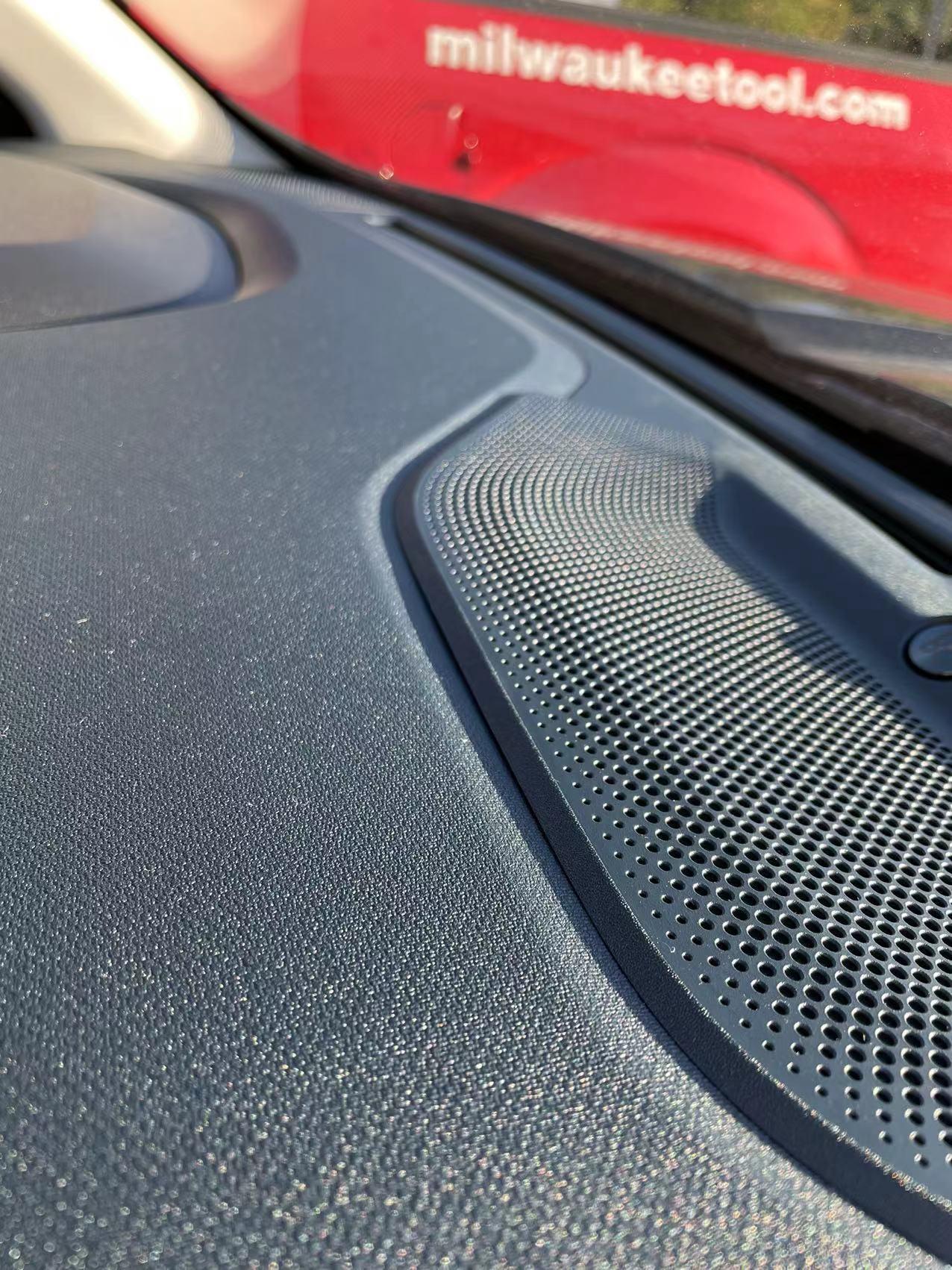

does anyone know how to remove this panel? i want to take it off and straighten or otherwise eliminate those gaps.

Imagine designing it that poorly, manufacturing it that poorly, and then shipping out thousands of units after looking at how poorly it fits.
On the dash.
On the most expensive trim of your product that makes you the most money.
Truly incredible choices.

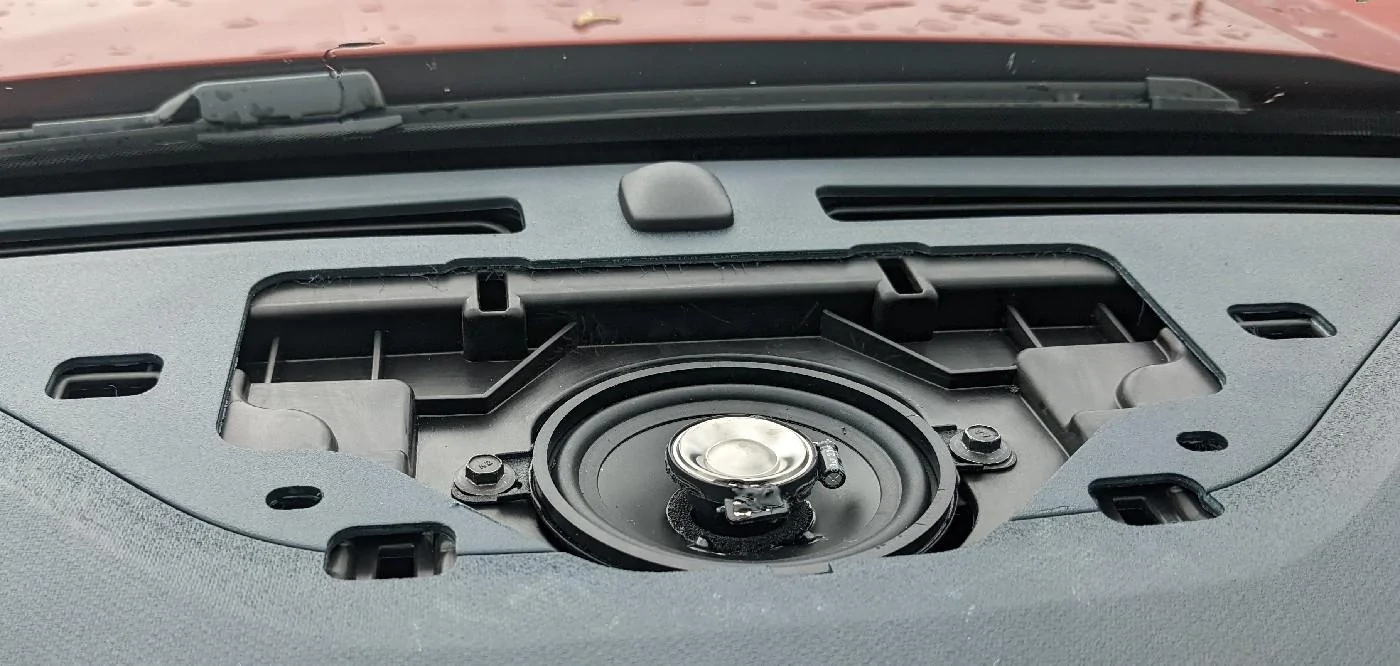

It just pops straight upwards.
Although FWIW there is a very small H-shaped alignment nub directly at that point which I cut off during my speaker adventures to see if it was causing the bulge. It didn't initially affect it, but may be why mine has since settled.
