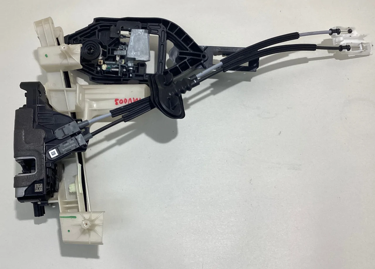

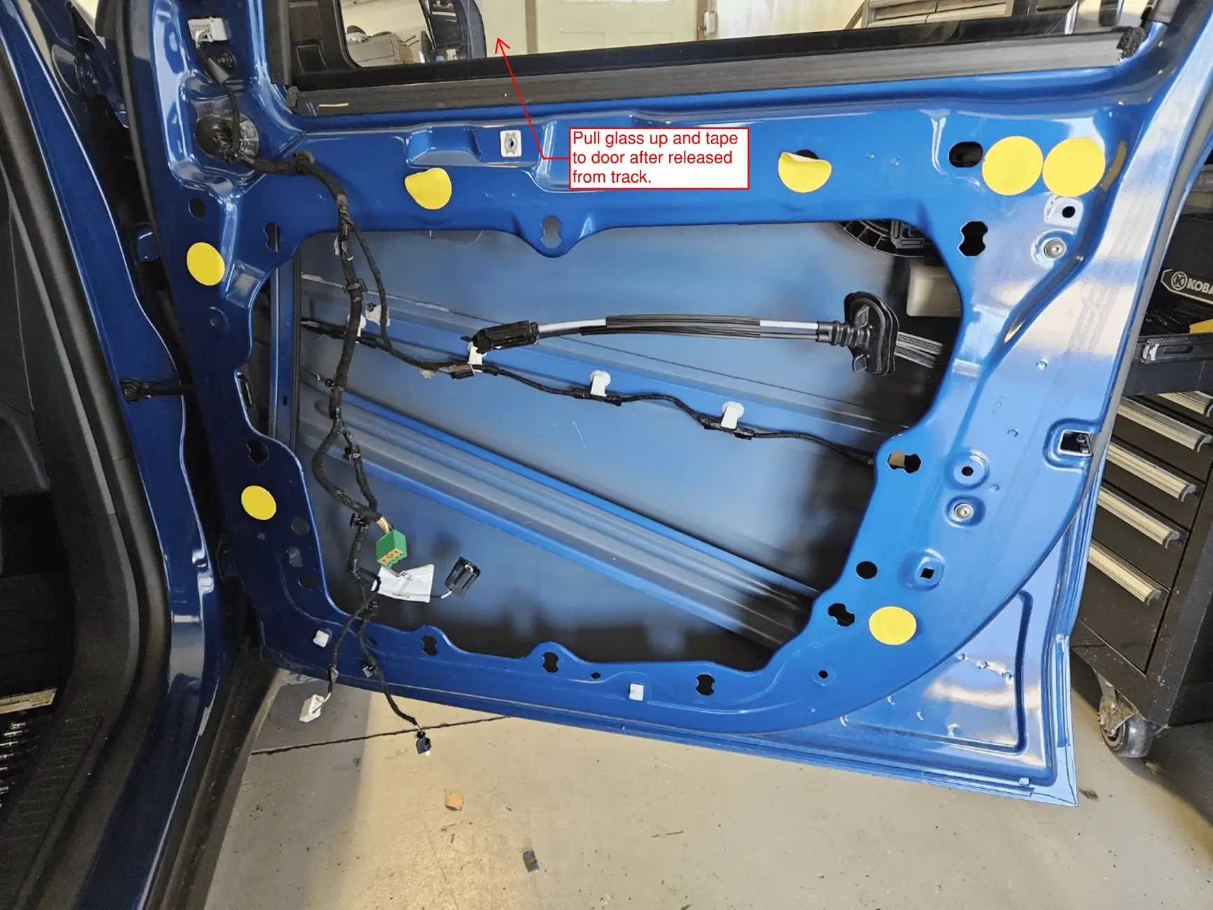

I haven't seen any examples of popping the lock on a Maverick, but a lot of modern cars have barriers inside the doors to block slim-jims.
Here's the how-to video:
You can get one of these bags at a hardware store, sold as a tool to hold up doors while you install/remove hinges.
In ye olde times, you could fish around between the door widow and the rubber flashing and pull/push some sort of connector or rod and open the lock. Dunno if it's possible in a Mav.
Was coming in to post the video you did.
That AAA guy was a total hack. I do actually have a bladder like the video shows and also some plastic wedges that don't damage the paint that you slide in and create the gap manually.
I'm not sure I could do it in 3 minutes but no more than 10 and I wouldn't have hurt OPs vehicle!
