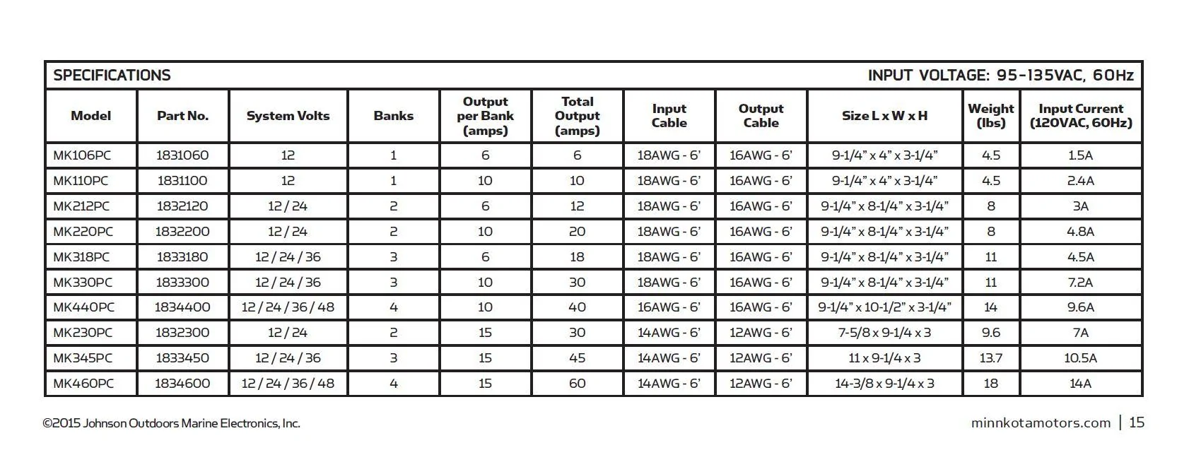

Here's the real (kinda ridiculous) question: could you use that 400w plug or the 12v wiring to slowly charge 12v deep cycle battery or 2? Or would that just take forever and not be practical at all? I'm not saying try to do that while the truck is parked and not running.
Well,,,,, here's a Minn-Kota marine charger chart, look at the far right column for the 120V AC amp draw.

It depends. Is a 6 or 10 amp/hour charger going to provide enough of a recharge for your deep cycle battery? What I was trying to show is that 12V DC chargers are available that will work within the 400watt limitation of the outlet, but you have to determine if the output amperage and # of hours will work in your situation.
