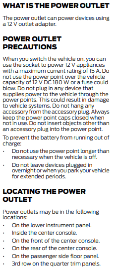

You're limited by the existing 12VDC wiring and fuses. The ones in the back are 20 amp. Draw any more than that and you'll pop the fuse. Change the fuses without changing the wire and you'll risk fire or the wires melting (bad news).
If you want to run larger gauge wire direct from battery to a converter than you can run bigger stuff.
The smallest standard or mini fuse I have seen in a car is 5 amps that would be able to handle 600 watts. Respectively if the inverter circuit is fused with a 10 amp fuse the wiring should be able to handle 1200 watts. Has anyone seen the fuse box schematic to know how it is fused?
Personally I would not want a 1200watt inverter hanging out in my back seat but inverters under 800watts or so are small enough to do so. I can put it under the rear seat when not in use.
Your math is off by a factor of ten. 5A at 12V = 60W. 10A = 120W. The stock inverter is fused for 60A, likely to accommodate the 400W nominal having some margin for startup surge although the manual doesn't explicitly specify how much.

You will not plug in a 400 or 700w inverter to a cigarette lighter. They pull too much power and will blow the fuse. A 400w will pull around 40a.
I have done it numerous times with no issues. I also asked if anyone had seen a schematic to know how it is fused. It is not plugging it in that is the issue, it is the amp draw of the device you plug into it. My 400w inverter will only run a 3.3 amp 120V device. Go higher and the circuit breaker on the inverter will trip. I would limit my use to say a 5amp 120V device. The 700w Inverter will work well in a situation like this. If these were no capable to be used directly on 12V sockets They would not come equipped as such by big names. As you go higher the inverters become direct wire connections only.
The bottom line is this. How many amps is the 12V socket wired for?
