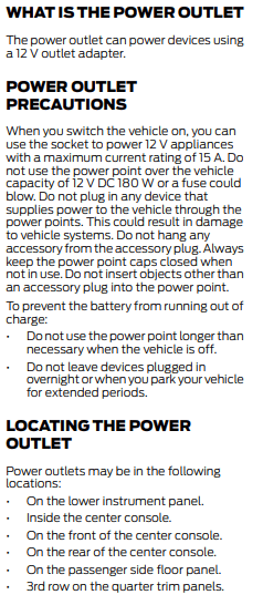

I hope it's okay to ask my question here. I have an XL, so no AC outlets included. Can I plug a low wattage AC inverter into the cigarette plug to charge my laptop? If so how many watts should the inverter be?
Anything that you plug into the 12V power point(s) should be no more than 180 watts (12 volts DC times 15 amps) all together at any time, since (as far as I know) all the power points receive power from a single fuse.

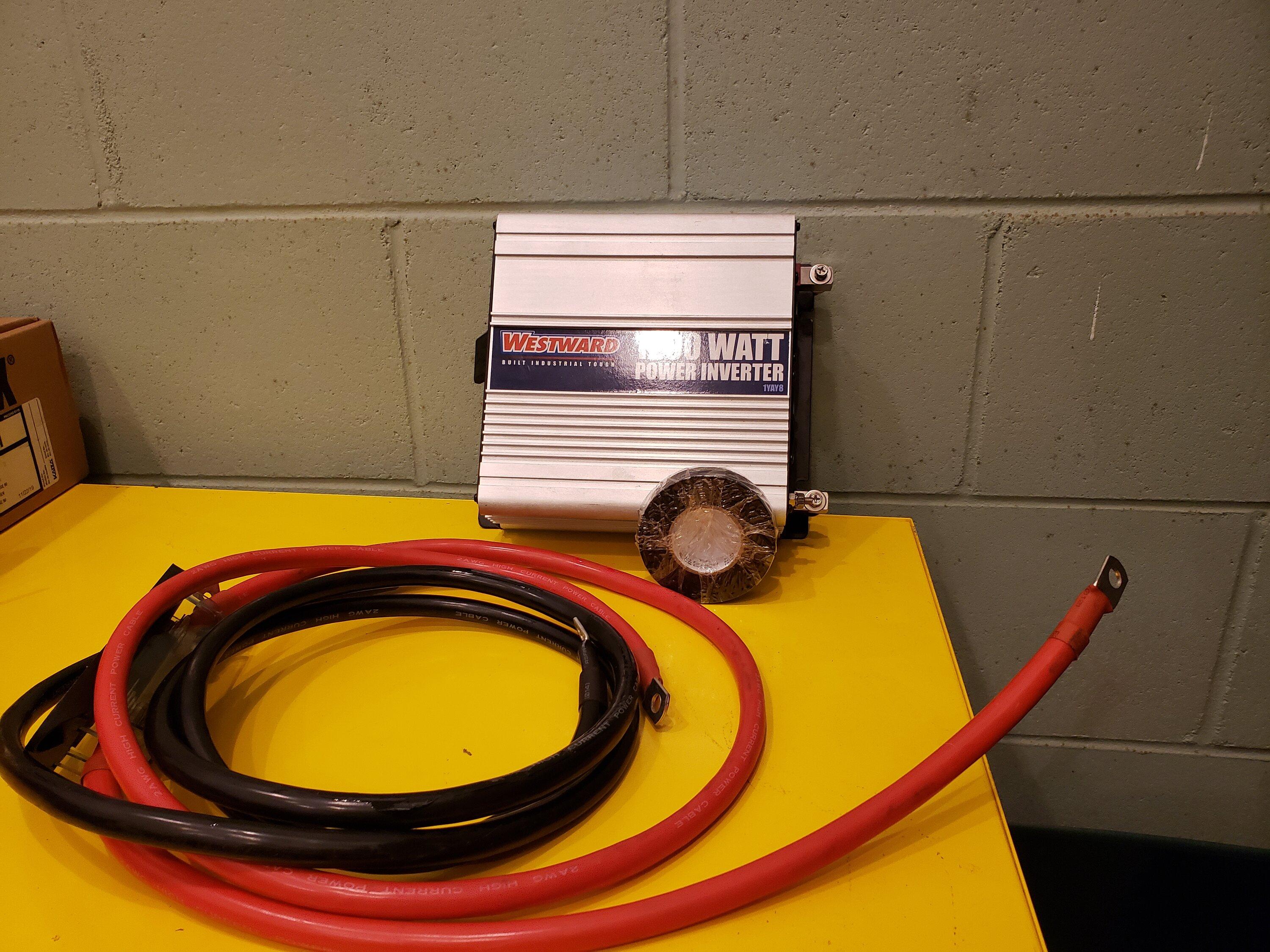

The one I have in my work van is 1200 watts. It charges multiple tools at once, can also run my key cutting machine, hammer drill, and other assorted tools.
I'll include a pic of my spare from the storeroom as well as the 2AWG wiring thats supposed to power it. (Roll of electric tape for size reference)
I don't have my Maverick yet so I can't test fit it into the spot the regular inverter goes behind the seat. (finally got a build date, so that's progress)
Assuming it will physically fit I will likely swap mine out for one of these at some point, but I'll be planning on upgrading the wiring at the same time.
One thing to watch out for is draining the battery if using a larger inverter with the vehicle not running. One of my coworkers ran his hammer drill and grinder long enough to cut off and re-drill sixteen 1/2 studs into 4 inchs of concrete and I had to come give him a jump afterwards.
Good info...thanks.

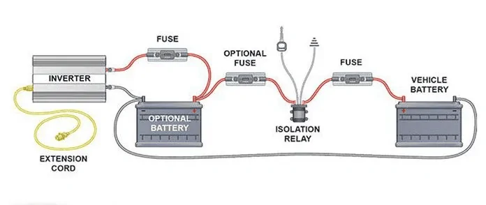

There are a number of ways to increase the capabilities of AC power available in your truck. Here are a couple of excellent articles.
Add more batteries = larger inverter size. This makes me wonder how big the hybrid batteries are and what could be done with them as emergency power for the home. But to do have to consider the size of the Maverick's alternator.
Here is a diagram used in a Family Handyman article.
Ford Maverick Upgrading 400W inverter possible? 1658755710124
I like the idea of adding an optional battery and a isolation relay which helps to protect your truck's electrical system.
There are a number of web sites that offer guidance, and here are a couple that I like:
Hope this helps some. :cool:
Thank you for the reply, I will buy an inverter to plug into power point. I don't require much power. Reading this entire thread gave me great info, maybe too much as my brain was starting to get twisted.
