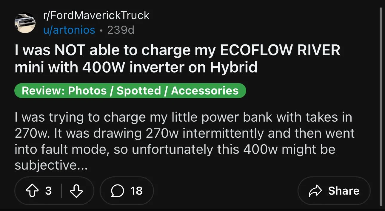

Hello! Can I charge portable power station Ecoflow River 2 from the 2024 Maverick inverter outlet? Battery charge fine with the cigarette lighter 100w max, but I was wondering if I can charge it faster with the outlet. Thanks!

Unlikely. Ford and most other companies install garbage modified sine wave inverters, which trip sensitive electronics. My Delta 2 trips the inverter immediately. And that's limited to 200w.

Found this thread from last year on reddit, that’s why I’m asking
Well that sucks. It's the main reason I ordered the outlet.

I was going to plug it in anyways, but don’t wanna risk it, truck is brand new.
You won't break anything. It's designed to trip out.
