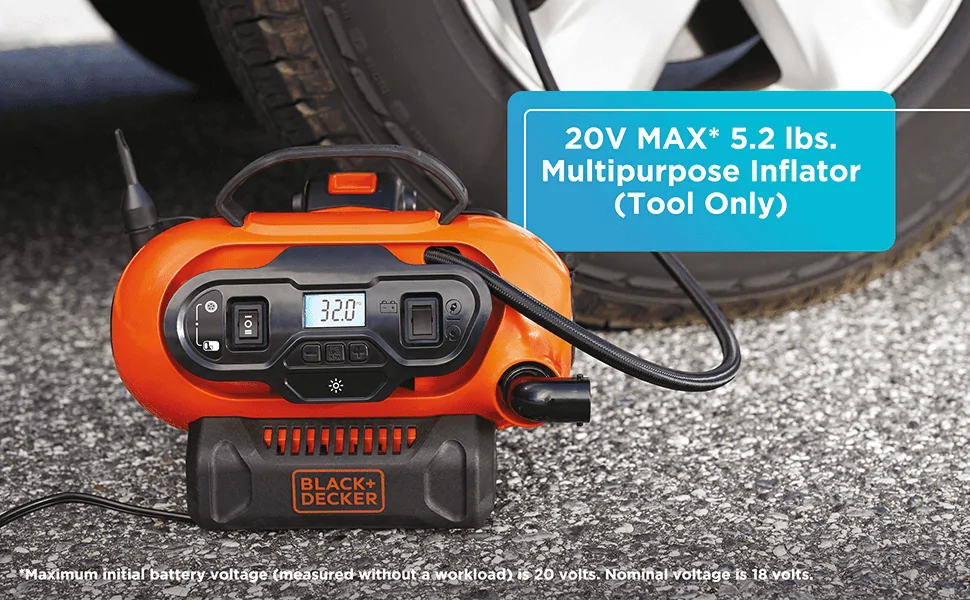

I am not well versed in these matters of Volts, Amps etc... would this be a good match to plug into the outlet? ( 12V DC, 120V AC, 20V max battery):
