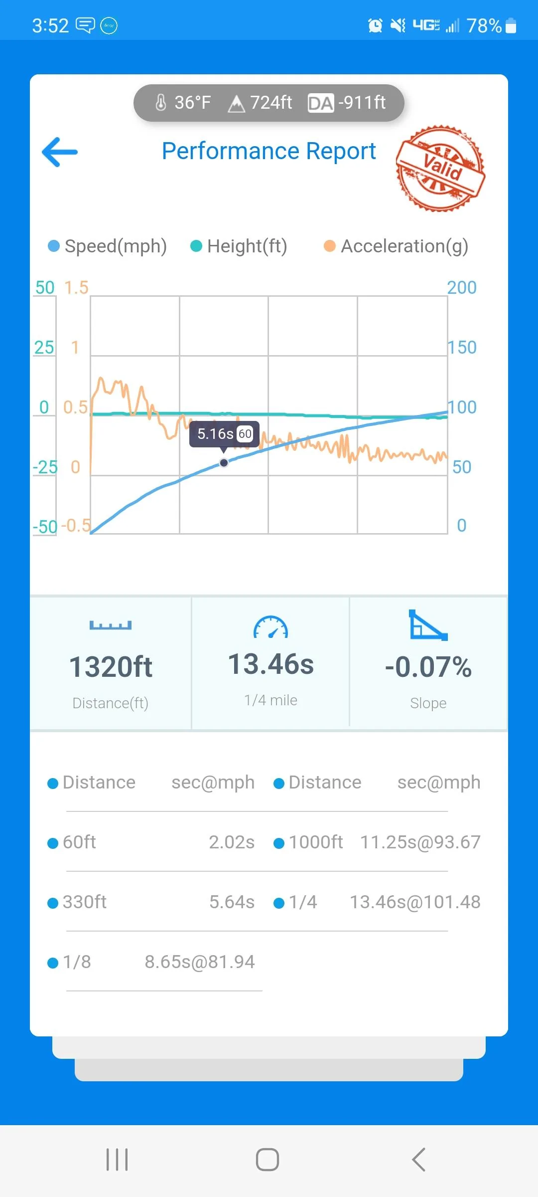

Did some datalogging. Since it was showing good datalogs yesterday, I let it eat for a full quarter mile while I watched knock. Knock stayed negative, so I believe that means it continually added timing! That's a good thing. Better thing is on the 87 perf tow tune meant for the factory turbo, it ran 13.46@101mph! That's it's fastest quarter-mile on 87 octane by .14 seconds with no tuning changes! This is going to be great!
