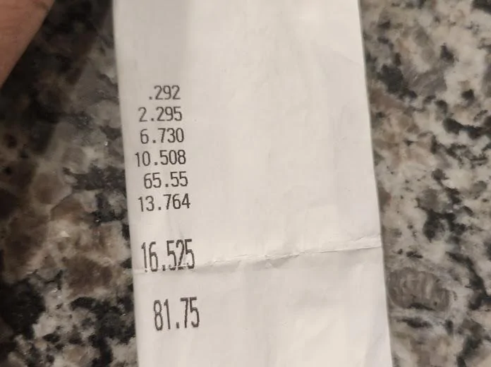

I have the same not power adder intake and an exhaust cutout no tune 5000 ft of altitude pathetic 16.5@82 sport, launched it harder than I ever have
Ford Maverick Finally hitting the 11 second goal [Maverick EcoBoost w/ upgraded turbo]. IMG20230731220949
Was it just the altitude or do I suck? I Might move my cutout before the 2nd cat instead of after when I get a Cobb and Corsair turbo... Rip bandimere speedway Colorado

I here you on bamdimere, I enjoy watchong pfi speed there!
Your altitude is 100% the reason it's in the 16's. If you were at sea level you would be pretty close to where I was.

wouldn't the turbo make up for some of that altitude by keeping boost up? 2 seconds & 12mph seems to be a drastic drop for altitude. Hopefully OP wasn't using that 85 crap they sell there.
The turbo doesn't know what the atmospheric pressure is. So say at 5k altitude, the pressure is .85 bar, and lets assume the stock turbo runs 16psi. I can't remember what it actually runs stock.
So 1 Bar being 14.7 psi, at sea level, you get 14.7+ 16psi= 30.7psi. At 5k altitude, you get .85(14.7+16)=26.1psi. That is a very dramatic difference!
More than likely, the factory computer will only allow the factory engine to see so much boost, even if it is shooting for a targeted torque value. I see this all the time when TFLTruck does 1/4 mile runs with all the boosted vehicles. They still are dramatically slower than the same vehicle at sea level.
Hope that rant makes sense, lol.

a turbo can overcome low pressure from altitude only if it has the efficiency to still make full boost.

totally does, and the stock turbo actually hits 21 psi. I was shocked but it's true.
but it totally *cannot* hit 21 psi with any kind of efficiency at high altitude for exactly the reasons you said. besides not making the boost target, it'll also have much higher intake temp.
