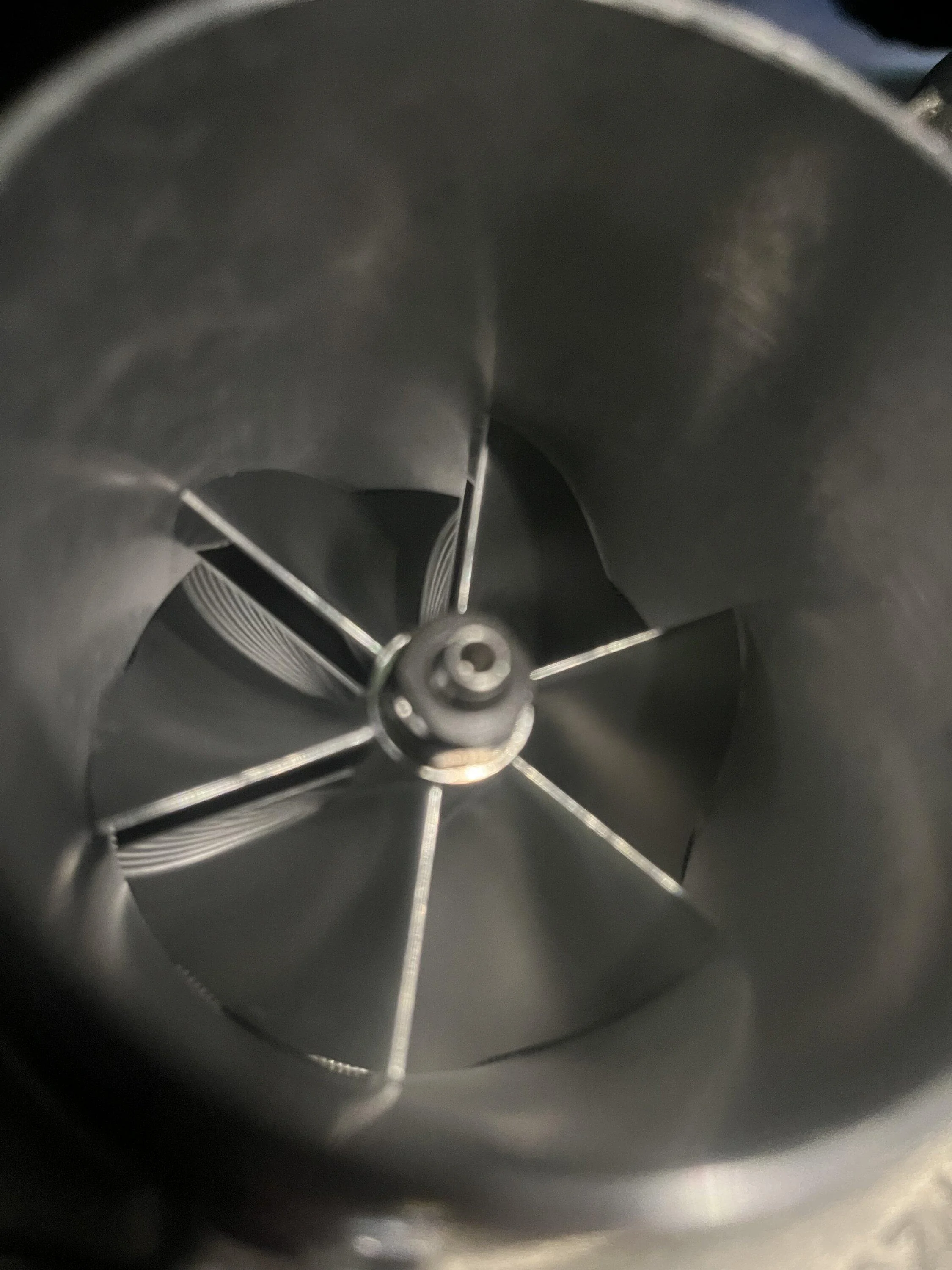

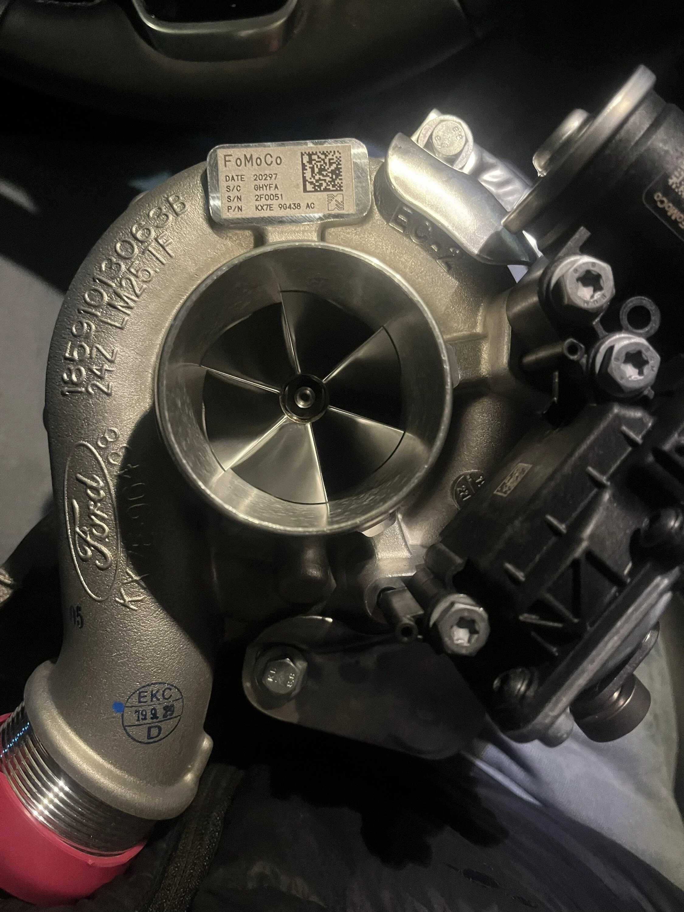

First of all, I want to thank John (Deuces) for doing all the work and research on the turbo options for the Mav. As most of you know, he’s the first person to swap the turbo on a Maverick and is currently the fastest Maverick in the world.
The 2.3 Corsair turbo is already rare so finding a used one is next to impossible. So I bit the bullet and ordered 2 new ones from the dealer (1 for me and 1 for a Grey Goose 😬) . Like the sensible car guys we are, we shipped them out to be “serviced”.
Lawrence and I just got them back today and they checked out ok. Somehow they came back as 57/71 turbos. Hopefully they work ok. 😉

Lol...I personally plan to see about playing more with timing to see if we can light up the turbo quicker!

What tune are you gonna rock with that turbo?
I've been in talks with Palm Beach dyno since they are here in Florida and "expressed" what I was looking for. They assured me they could "get me there". If all works out I'll have them build a similar tune for Ivan and have him data log for a bit to ensure all is dialed in on his truck. I LOVE live dyno tunes!
