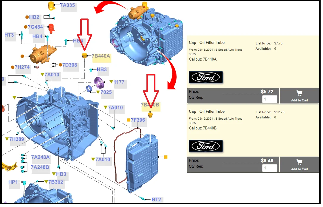

So, which fill plug do you remove to add fluid??...
Pretty sure its the A cap from videos I've seen. Hard to say for sure, but chances are, there is only access to one of them, as mentioned above, next to the battery.

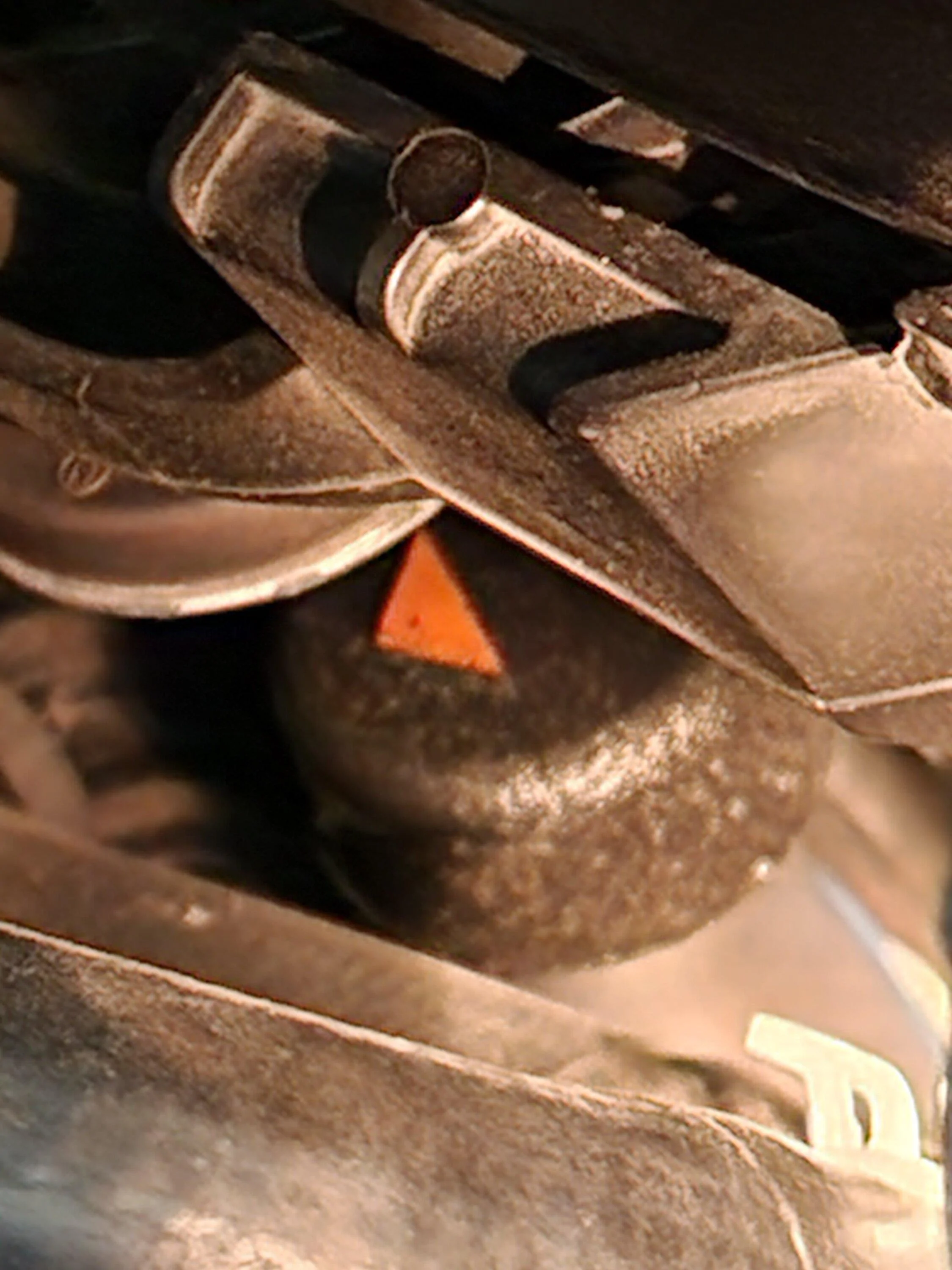

This cap....
