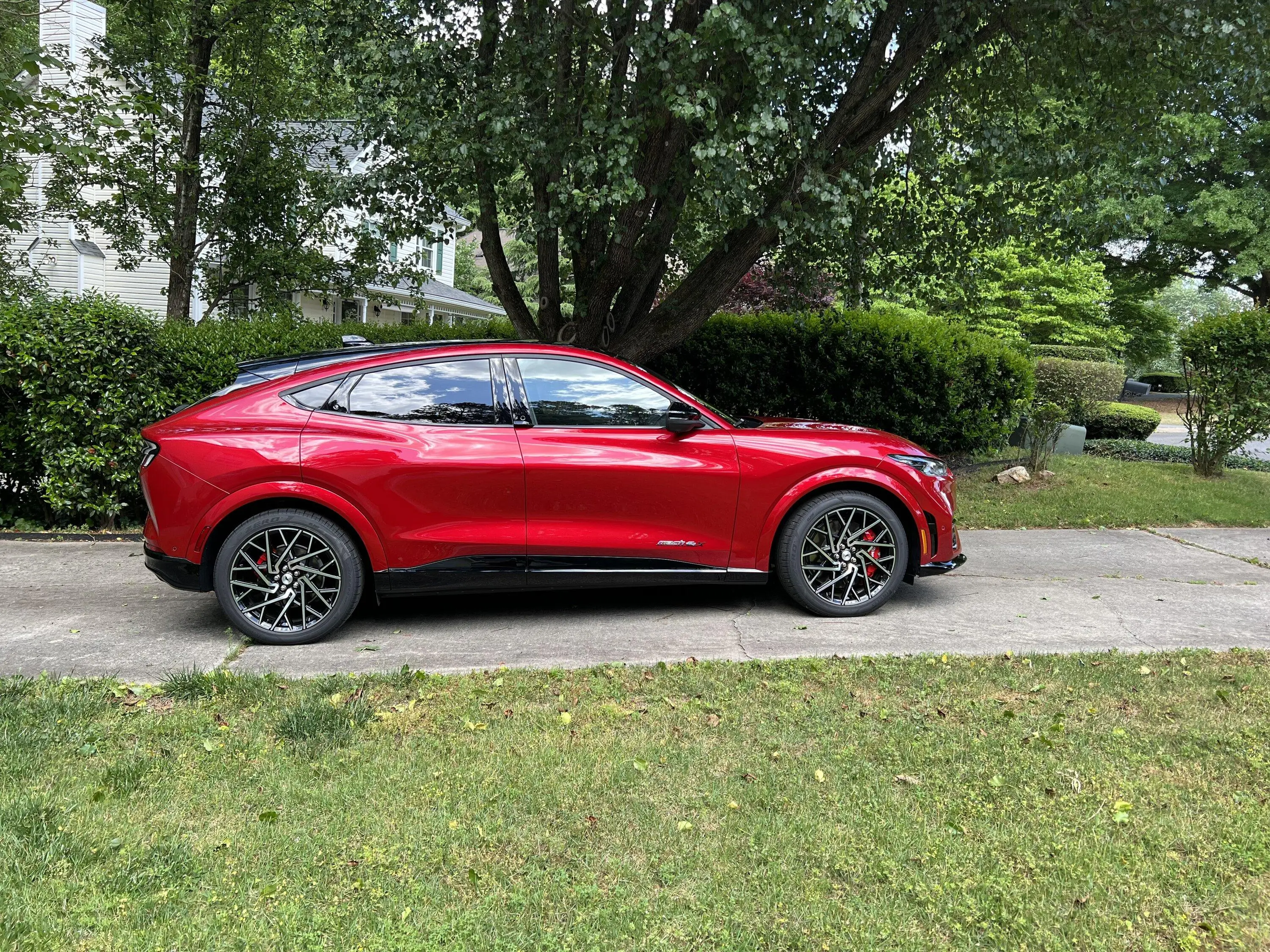

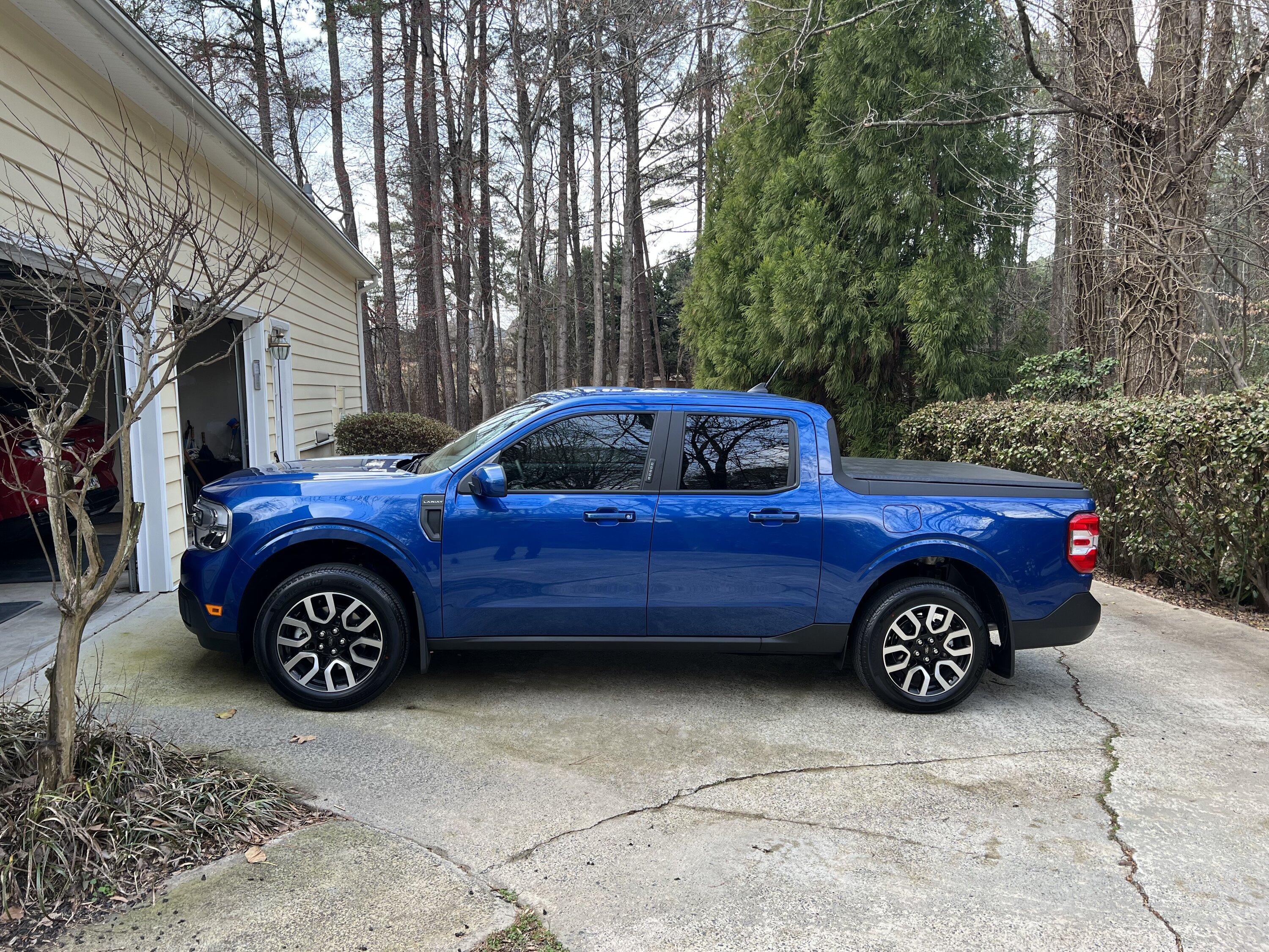

I alread do that. I have a 2021 Mach e GT that I only drive around town up to 200 miles round trip. I is only charged in my garage. I have a 2023 Maverick Lariat that I drive on trips.
