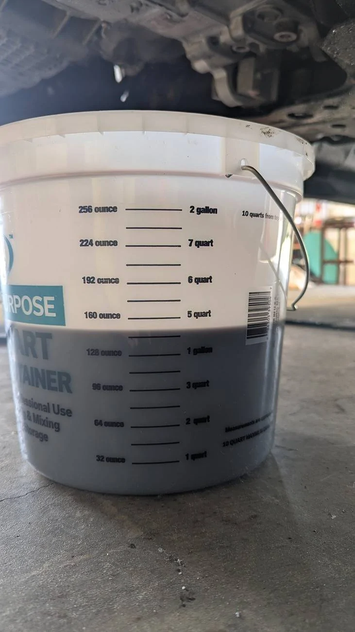

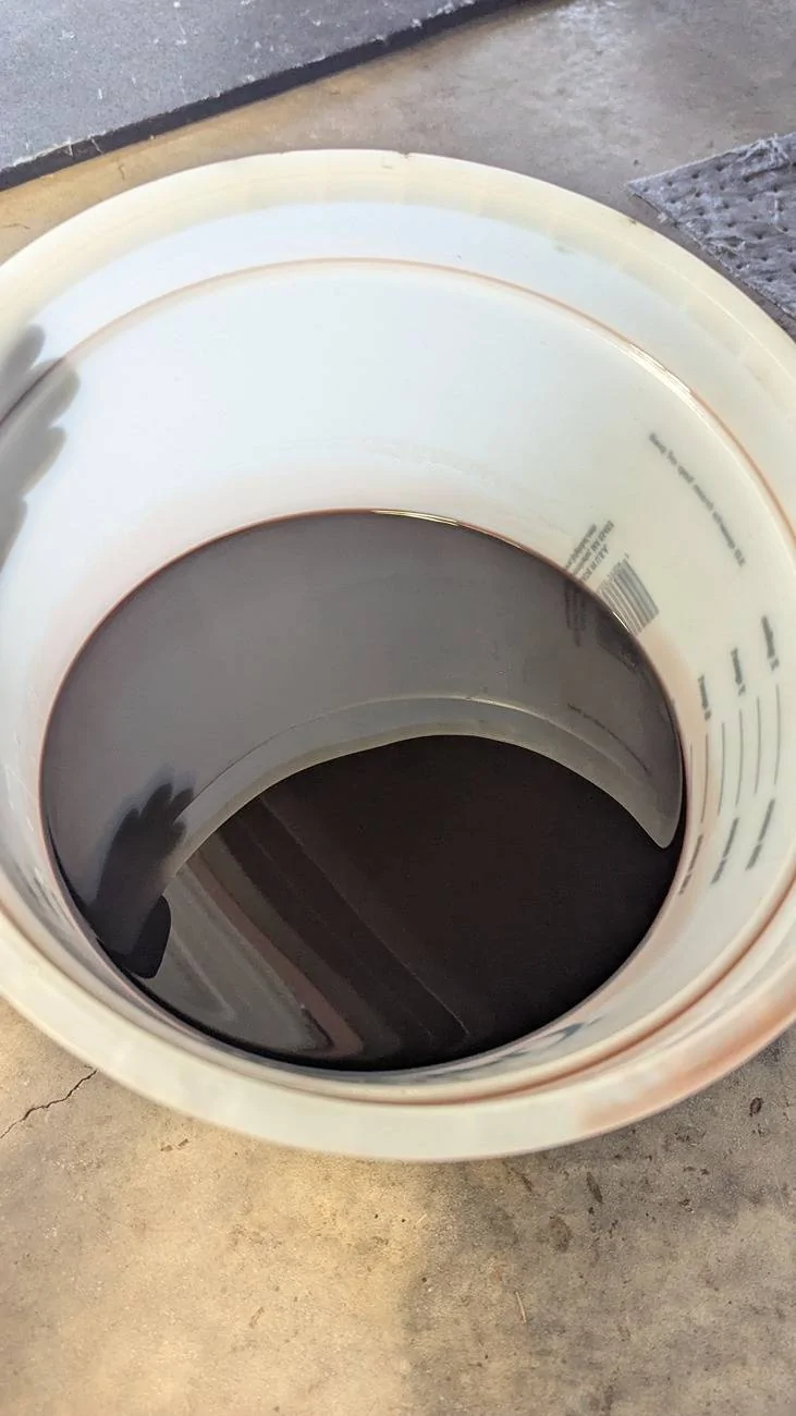

Tscottok, thanks for the tips on how to do the transmission fluid drain and flush, they were very helpful when I did this job on my Mav! I did mine at 16,300 miles and the fluid was a very dark red, but I did not see any metallic glimmers in the drained fluid. Here are some of my findings/experiences that might make the job even easier/quicker for MTC members in the future:

  • I also drained out 4.25 quarts of fluid with the vehicle being level. By raising up the passenger side of the vehicle, I was able to drain an additional 0.5 quarts of fluid. Raising the rear of the vehicle removed an inconsequential amount of fluid. In total, I drained out 4.75 quarts.

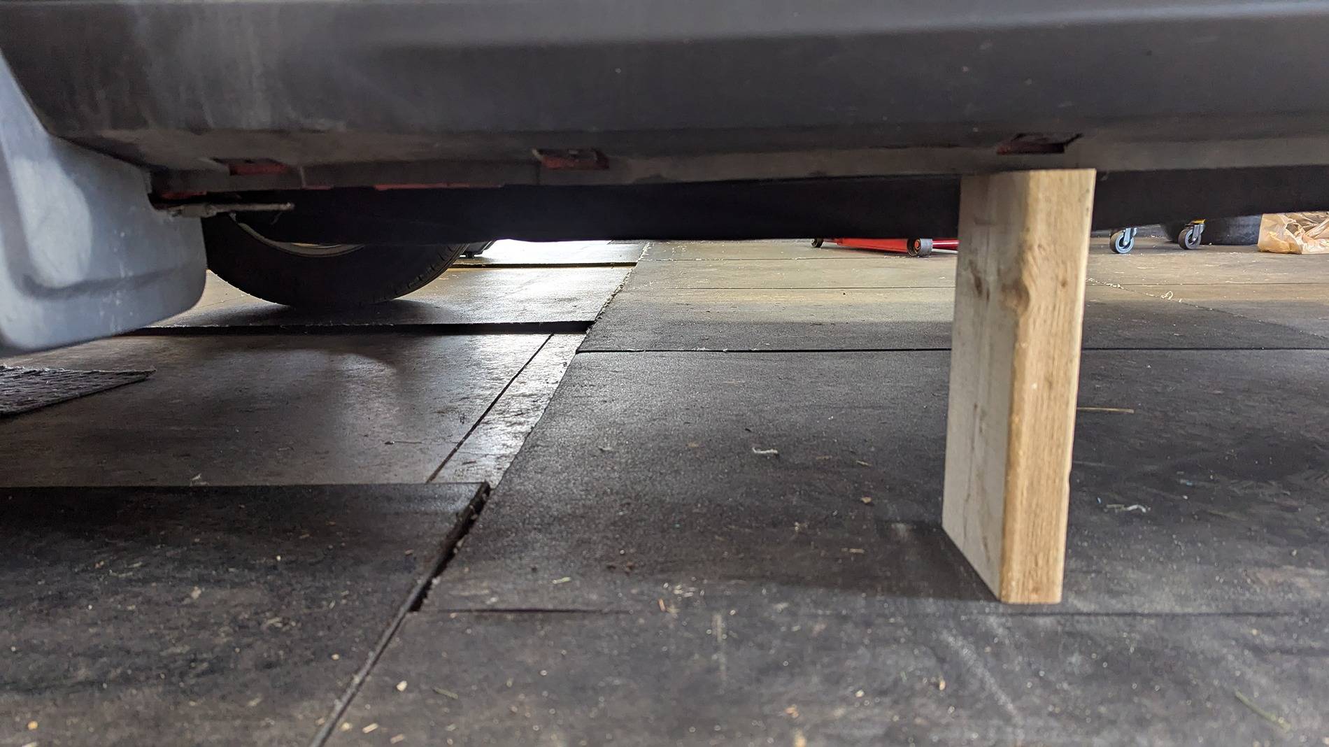

  • For the fluid leveling process, I would strongly recommend removing the front driver wheel to gain access to the leveling plug (it would be very difficult to get access to the plug with the wheel still on). To get the vehicle level, I used a previously cut spacer block that was the same distance from the ground to the pinch weld as when the front wheel was on.
