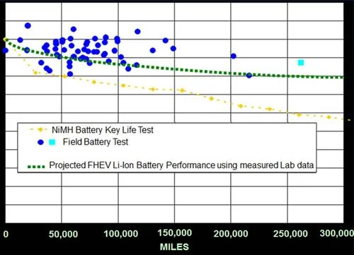

My 2012 Ford Fusion Hybrid is still on its first battery, and it is the older nickel metal hydride. The newer batteries are lithium based and should have better conditioning software, so I'm not worried.
This statement goes with this chart from 2012. Ford hybrids all switched to Li-ion in the 2013 model year. C-Max HVB experience validates the test's predictions. That's why I call it a life-of-car part. Hybrids that routinely replace batteries are using NiMH, whose capacity falls off eventually.

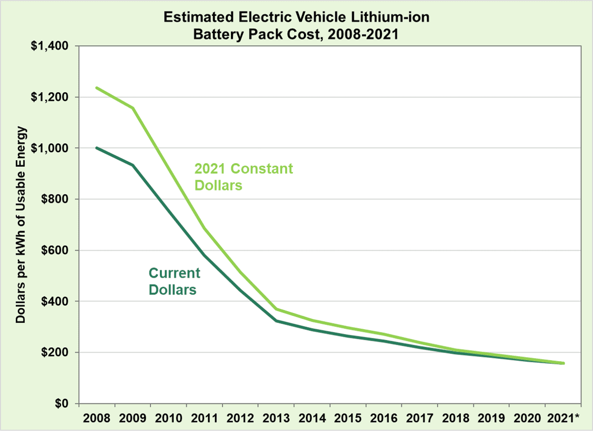

Electric Vehicle Battery Pack Costs In 2021 — 87% Lower Than In 2008
https://cleantechnica.com/2021/10/0...tery-pack-costs-in-2021-87-lower-than-in-2008
“Research by the Department of Energy’s (DOE) Vehicle Technologies Office estimates the cost of an electric vehicle lithium-ion battery pack declined 87% between 2008 and 2021 (using 2021 constant dollars),” the DOE writes. “The 2021 estimate is $157/kWh on a usable-energy basis (the equivalent of $143/kWh on a rated-energy basis) for production at scale, i.e., 100,000 units per year. That compares to $1,237/kWh on a usable-energy basis in 2008. The decline in cost is a combination of improvements in battery technologies and chemistries, and an increase in manufacturing volume.”
Using the $157/kWh times the 1.1 KWh battery in the Maverick puts the cost at $173. This number is probably only the battery cells so there is additional costs with sensors, wiring, casing and other stuff. And of course labor for the actual replacement.
But the old "it will cost $8000 to $12000 to replace" or even the $5k one posted early in this thread are way too high based on this report. Also remember the High Voltage battery pack is warranted for 8 years so future prices my be even lower.
