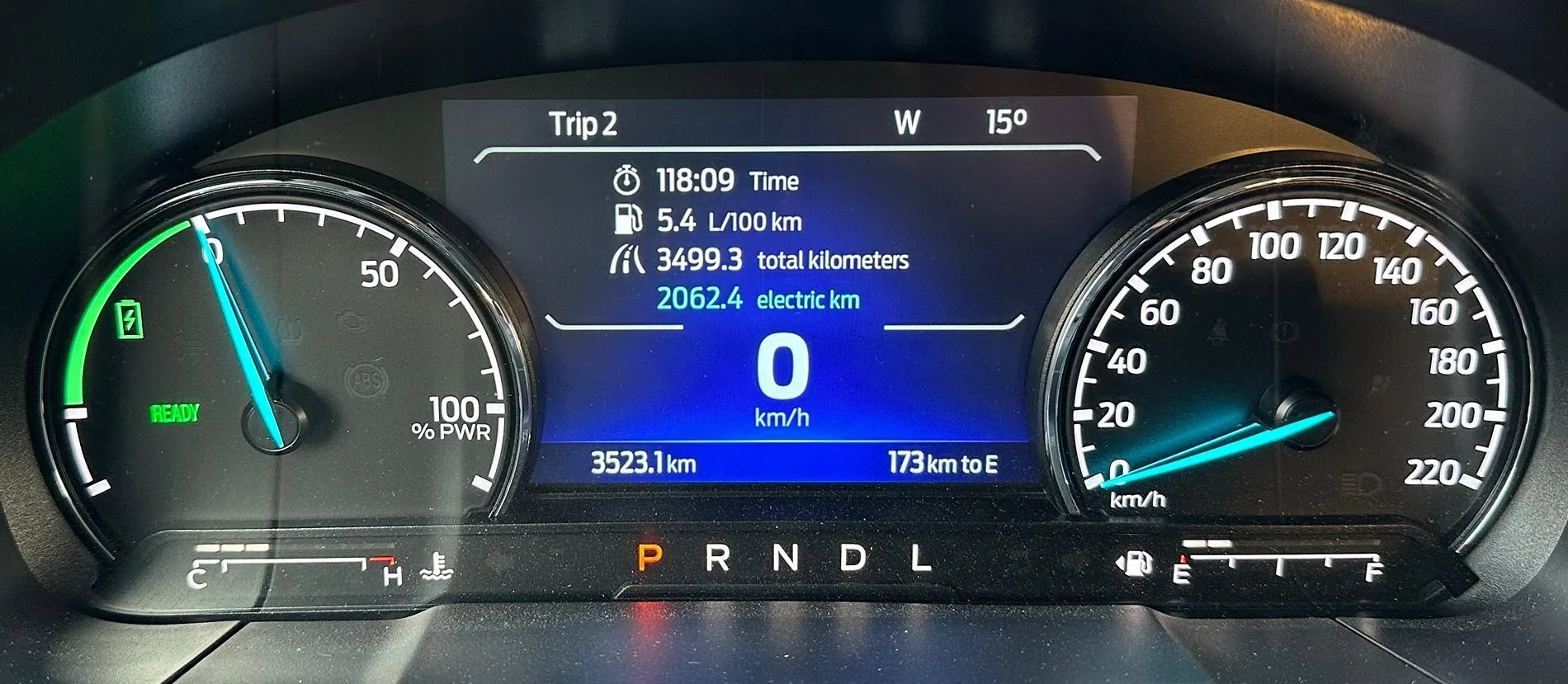

where do you check that?
Ford Maverick Thinking ahead -- Are the batteries in the hybrid consumer replaceable? IMG_1188
Trip 2 has not been reset since I picked up the truck...
3499.3 (Total Kms) - 2062.4 (Electric Kms) = 1436.9 (ICE Kms)
1436.9/ 3499.3 = 0.4106 (or 41.06%)
