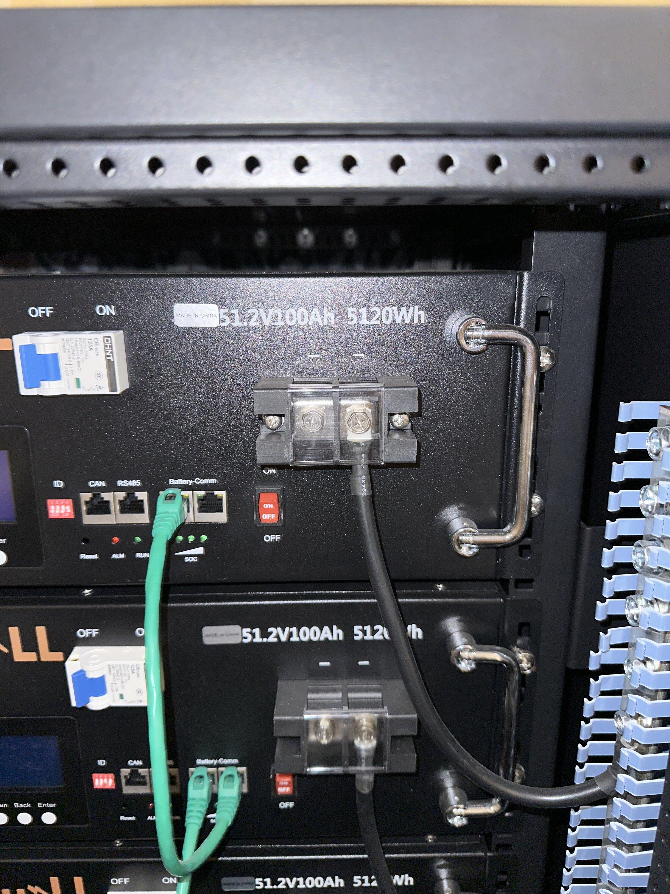

I didn’t even get the AH right, here’s a pic of one of my residential batteries, it’s 100 AH and 5120 WH so I was way off:
Ford Maverick LiFePO4 batteries for Hybrid Maverick use? IMG_3475
