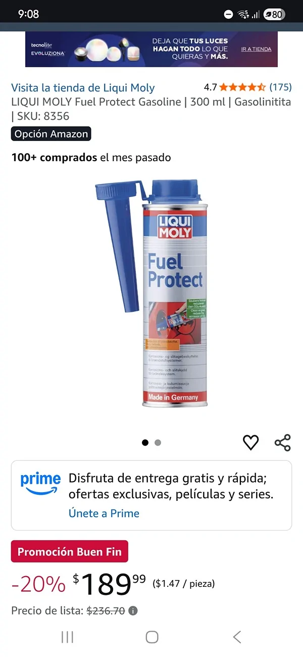

“Top Tier” gas has a higher detergent formula than non top tier. Since Pemex is not top tier - do you use aftermarket (Techron) or OEM (Motorcraft) detergent/additives occasionally? I think the recommendations say a $25 bottle every six months or so.
Keeps your baby squeaky clean:)
This is what I use, is it good?!
Good question.
:crackup:
more seriously, it depends upon what is in it, and it would take some research.
We know what is in Techron: it's what Chevron uses to create it's top tier fuel in the first place!
There is a lot of snake oil out there, some of which have folks that swear by it. Some harmless, some harmful.
If you can determine that it comes from an oil company that makes TopTier fuel, it's likely good. And if it's not, than what do those folks really know? The top tier standard was developed by the companies who make high compression engines; none of them sell it. Rather, it specifies what they want to count on being there.
Check the ingredients for Polyether amine (often abbreviated as PEA)
It is the highly effective & commonly used detergent in Top Tier Gasoline and also aftermarket additives. Was a neat discovery by some smart “nerd” scientist:)
