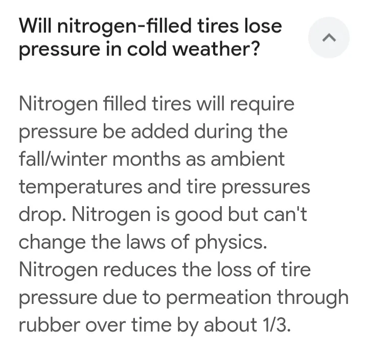

No. It's my understanding that common compressed air expands and contracts much greater than purified nitrogen gas between -40°F and 140°F and is not contaminated with water. Pressure remains very stable with nitrogen gas filled tires.
Nitrogen may be better, but absolutely not "immune" to pressure variations based on temperature. Anyone with nitrogen-inflated tires that does even casual observations of their tire pressures can see the fluctuations, myself included.
In any case, common compressed air is nearly 80% nitrogen by nature. I prefer to use N2 because it's free at Costco, but it is by no means immune to temperature swings.
This is true and accurate.
Another reason nitrogen is put in tires is all the molecules are the same size and a bit larger than O2 molecules so,
Less slowly leaks out over time.
BUT !
The air we breathe is composed of approximately 78% nitrogen.
So,
I’m not getting sucked into that game. I’ll just check my tire pressure often and adjust as weather changes.
