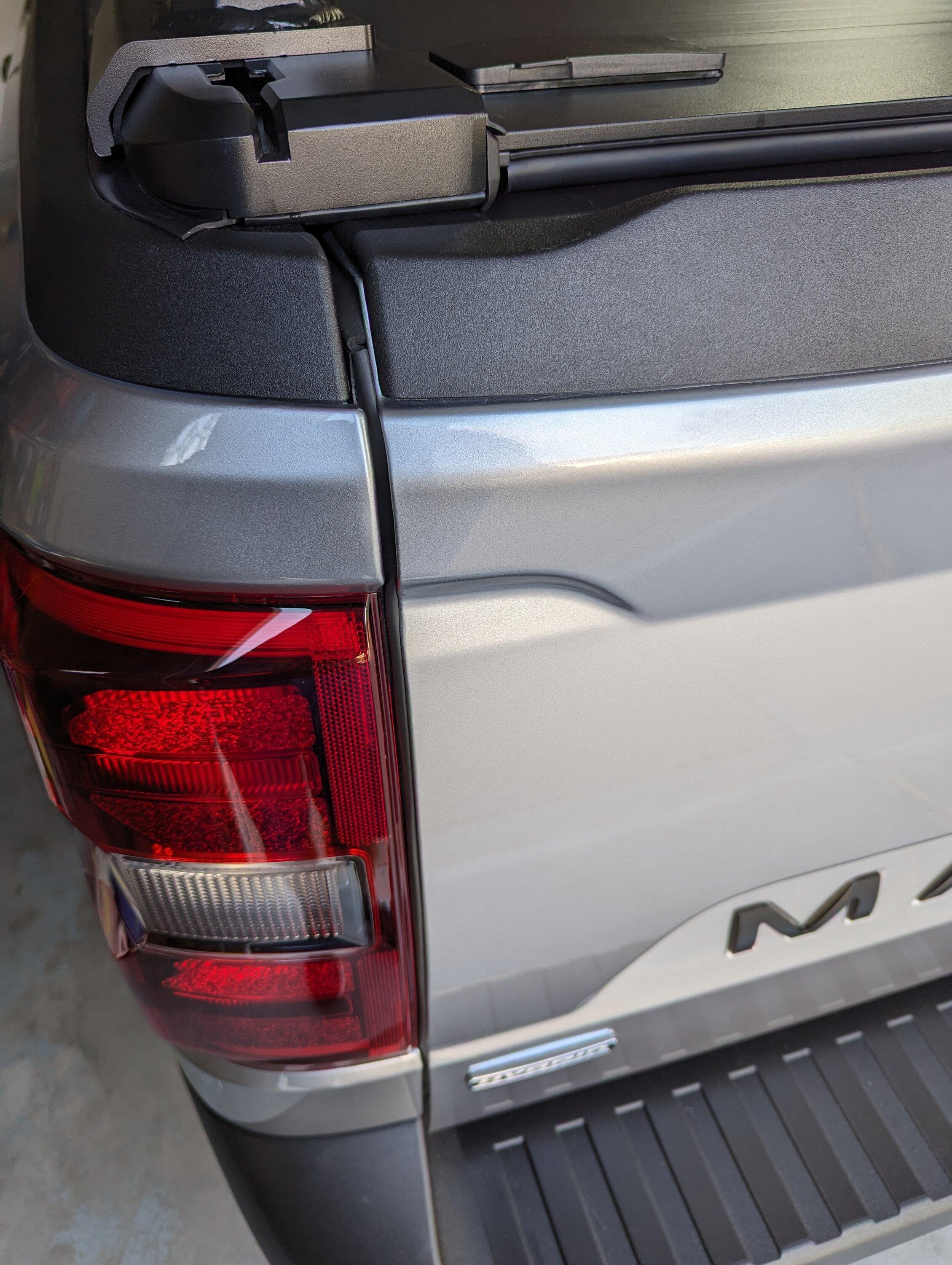

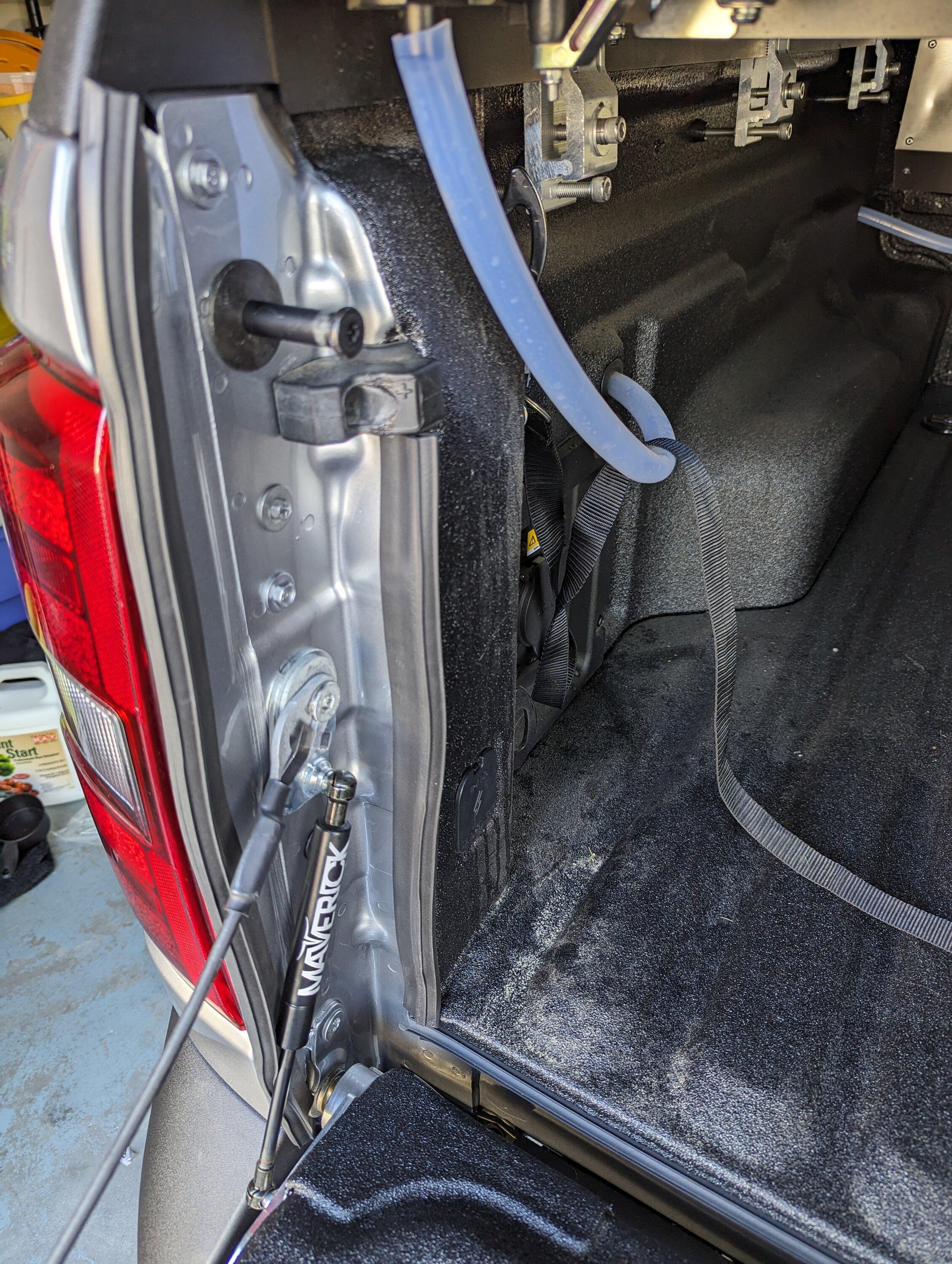

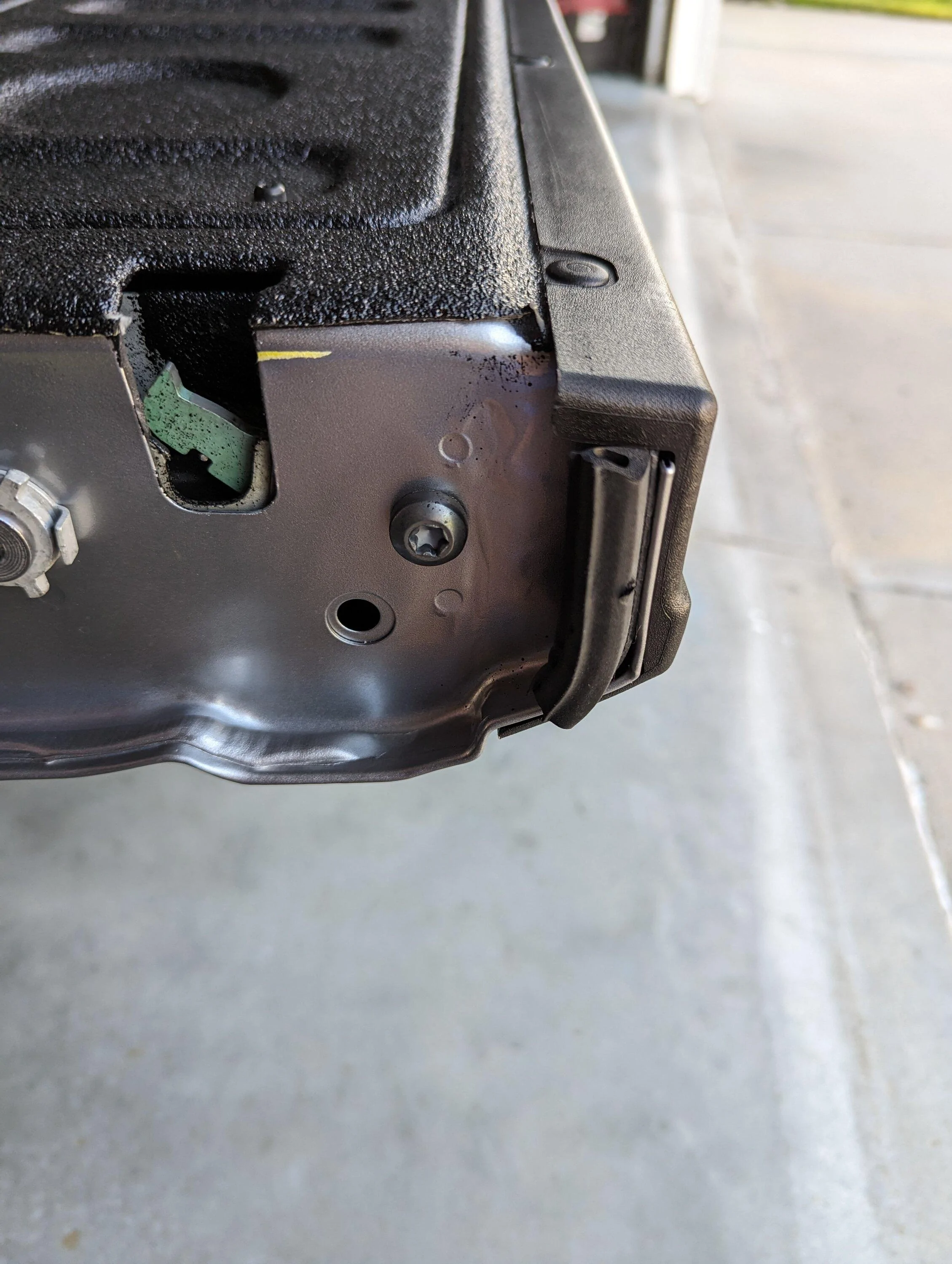

Remembered the way to do most weatherstripping. Place it on the moveable part!
Just now seeing this thread, but had the same idea.
After trying out the mount-seal-to-tailgate method, I didn't like how much it was rubbing to get inside the body line, so opted to seal the truck-side instead.
A few notes:
  • Some interference with the tailgate strut and tie-downs. Seems okay, but was going to add the simple triangle tiedowns on both sides anyway.
  • Had some cutting from the tailgate plastic lip, so stopped the seal at the top and continued with a short tail-gate mounted piece for the top/horizontal run.
  • Kit from amazon had enough length to also do the interior seal, left right and bottom
