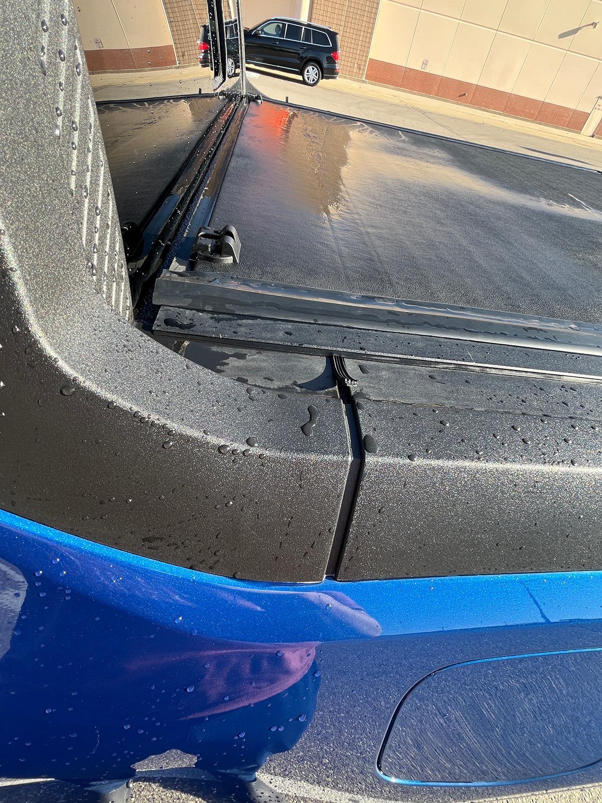

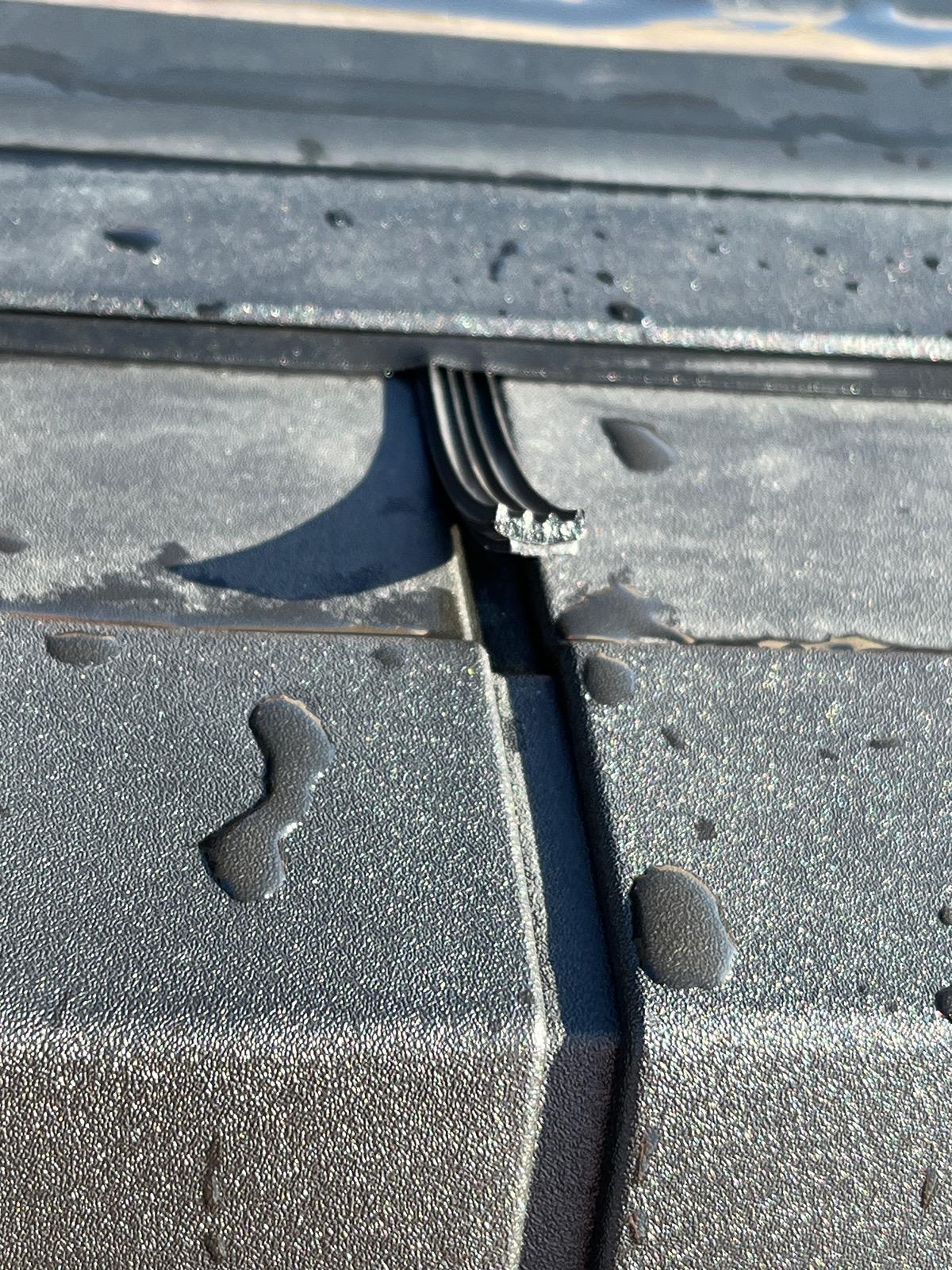

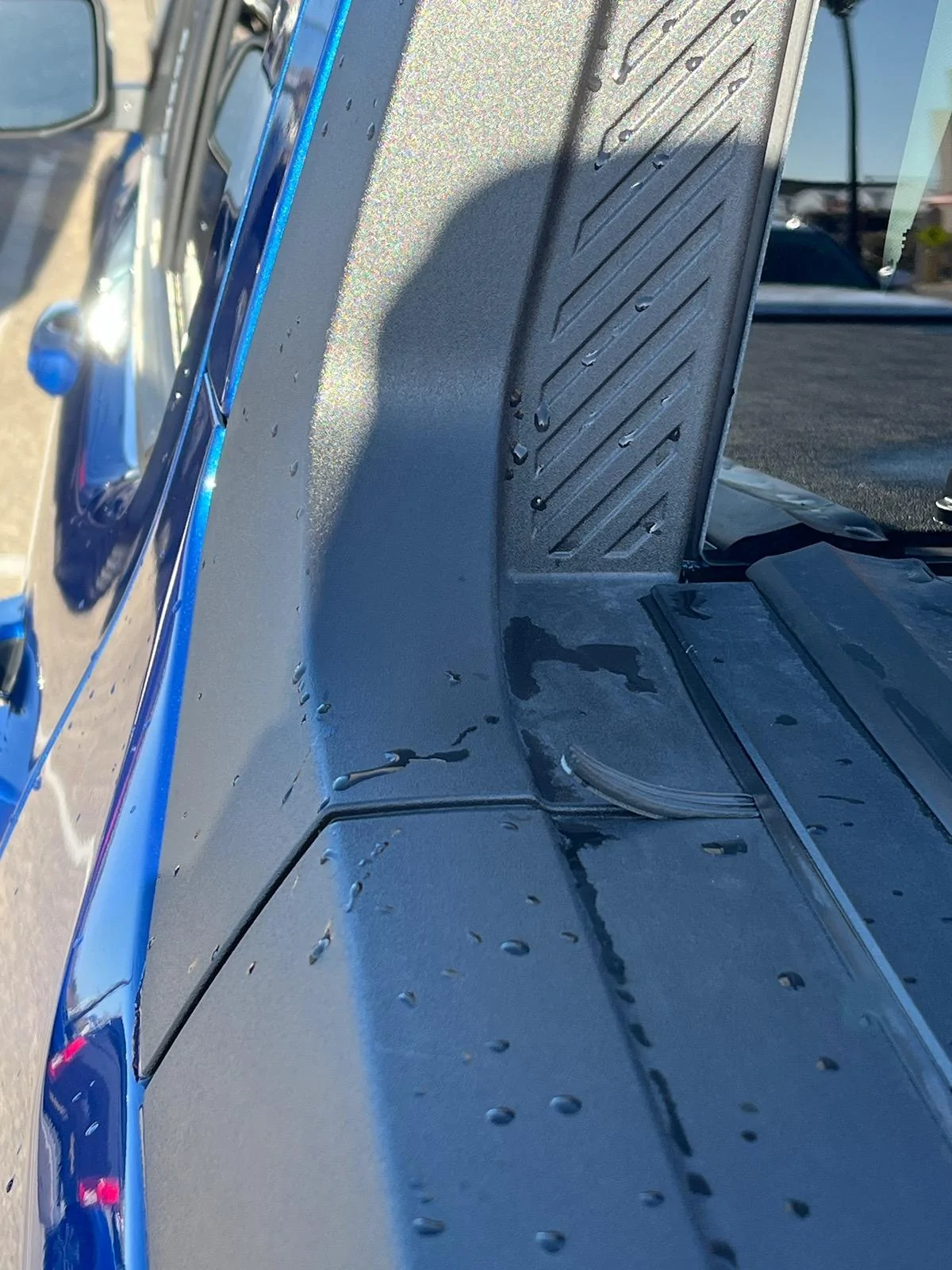

I have a Revolver X4S bed cover / top and it came with weather stripping. I followed the procedures to clean the surfaces before applying the weather stripping in the two channels behind the rear window. Today after a car wash, I noticed both sides popping up…
get rid of them and let it be?
Try to re-do it with new weatherstripping?
Maybe a black exterior grade RTV?
Something else?
See pics and thanks for your feedback!

The stock glue from aftermarket add-ons is average at best. I usually put on some additional glue of my own to ensure it will stay. I did this to my wife's car because of the car wash she goes to was constantly removing the black inserts off the roof of her Toyota Yaris. A little dab of super glue or gorilla glue and the problem is gone.

I squeezed black RTV under the bed cover rails 18 moths ago. You can't see it and no leeks.
I must have stretched the bulkhead seal a litle to much and ended up with a little seepage in each corner. You could see paint between the end of the seal and the bed rail. I filled those gaps with RTV and the leaks stopped.

Yes sir - that's right. I used the smaller weather strip for those channels. It was either in the instructions or there was a published video on YouTube by the manufacturer on sealing all of the areas where water could get in.
I realize there's no way to make the inside 100% waterproof, especially after a car wash. So I don't keep anything that can't withstand exposure to water in the bed. I usually keep a tool bag in the bed and pull it out prior to a car wash. It does stay dry in light rains without any issues.
I bought an aftermarket adhesive & applicator for the thicker seal behind the rear window which was showcased on an installation video. I may do the same thing for these small channels.

The tailgate area is the spot where I have water coming into the bed and only after a carwash where it's shooting water into the bed area under pressure. The amount of water that does make its way into the truck isn't a big deal and I can live with that too.
