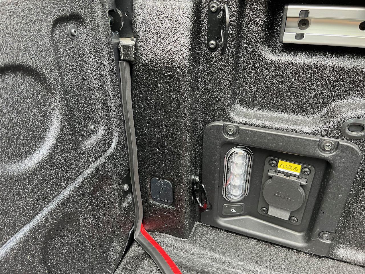

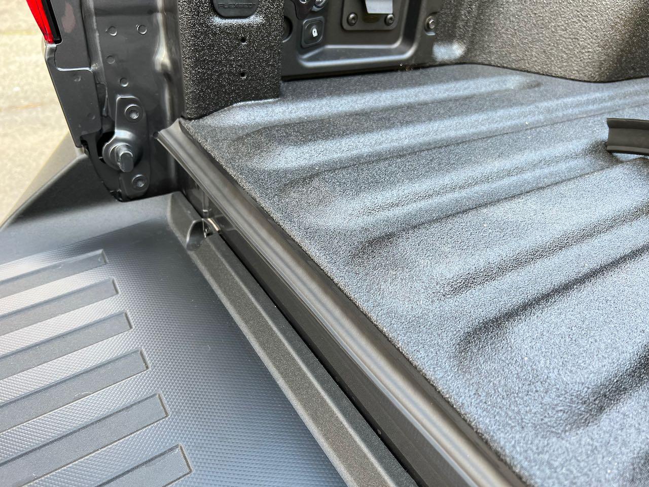

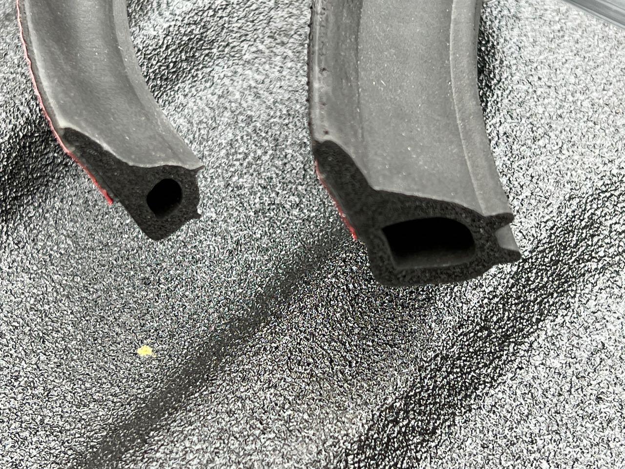

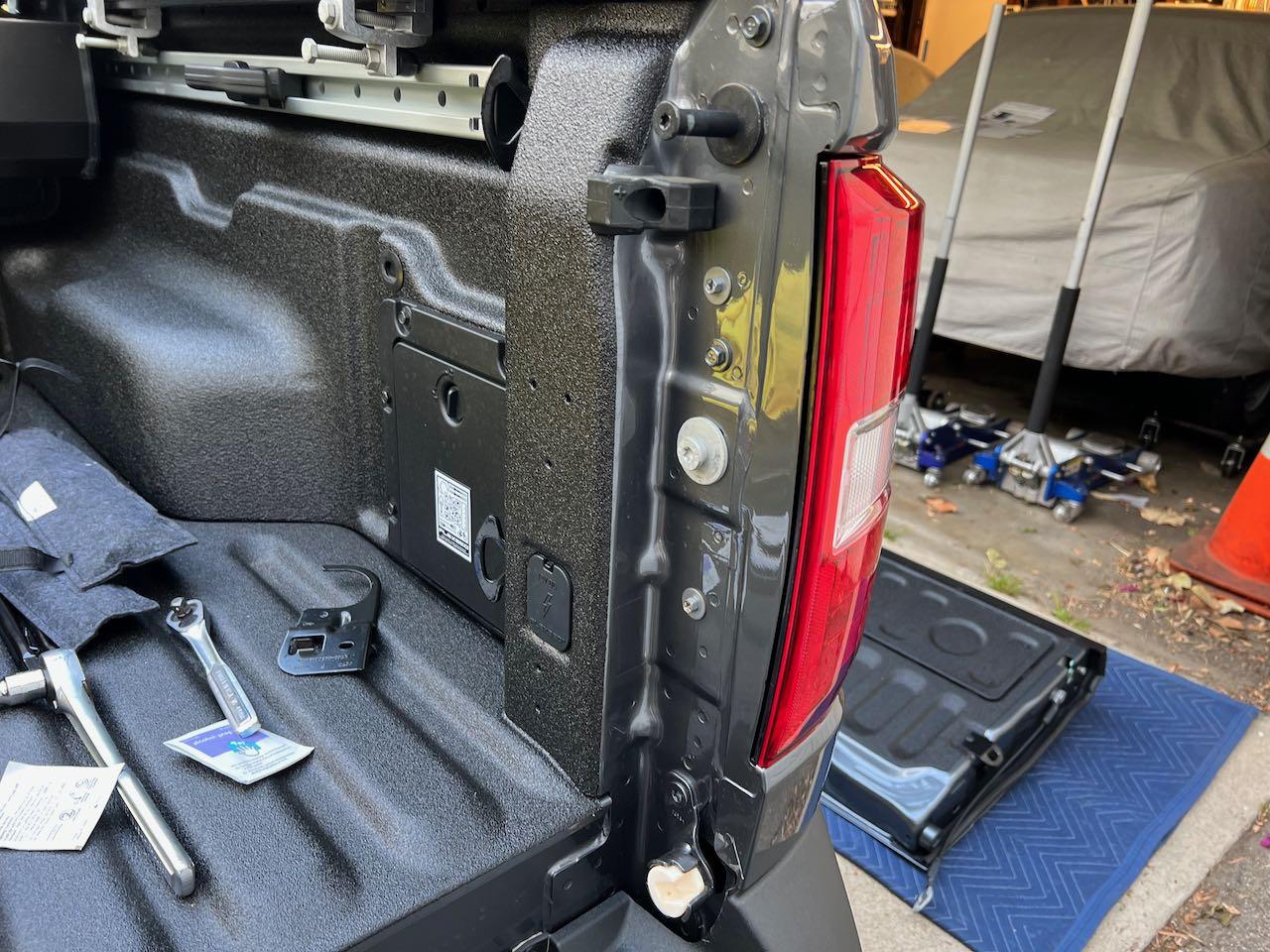

I watched a million YouTube videos and bought this tailgate seal kit. I comes with two sizes of adheasive seal. If I had to do it over I'd get a second roll of the LARGE size to help bridge some of the large gaps. I haven't had any issues with the adhesive failing, I did a very extensive paint cleaning before I installed it.
Ford Maverick Need suggestions for weather-stripping the tailgate IMG_7629

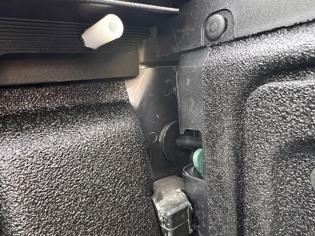

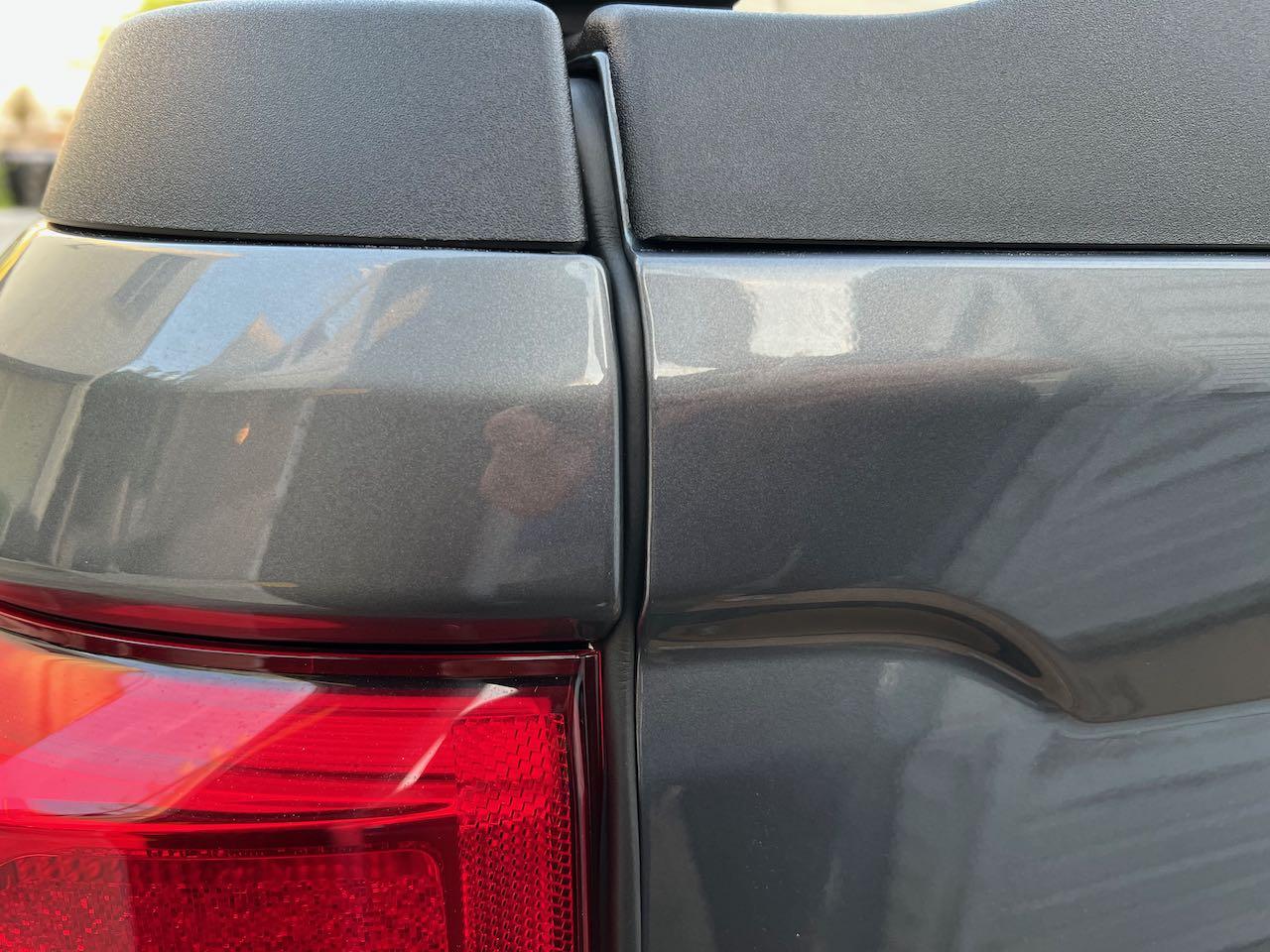

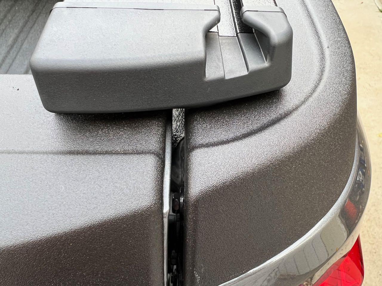

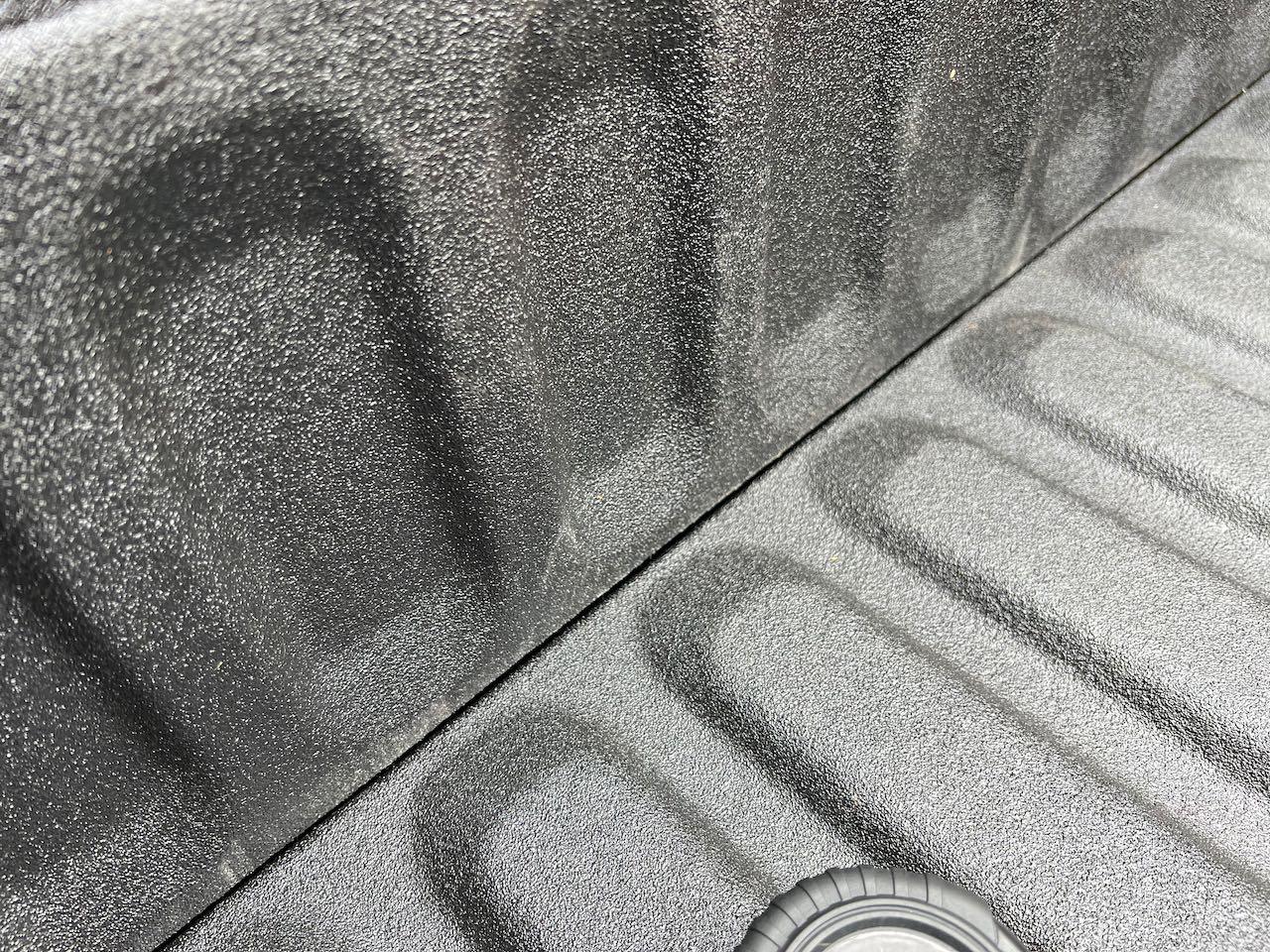

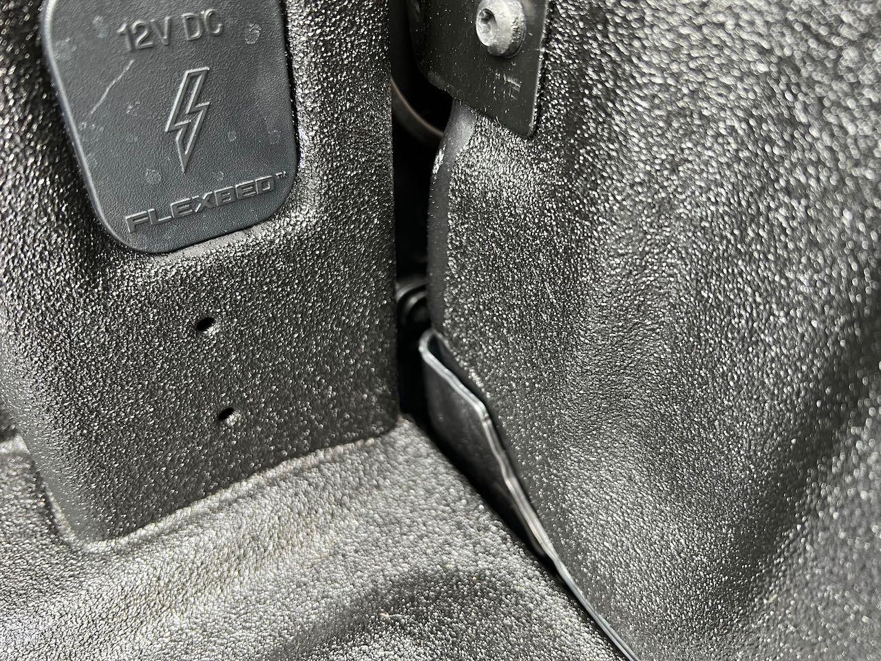

Lot's of gaps:
Ford Maverick Need suggestions for weather-stripping the tailgate IMG_7637
Ford Maverick Need suggestions for weather-stripping the tailgate IMG_7638
Ford Maverick Need suggestions for weather-stripping the tailgate IMG_7641
Ford Maverick Need suggestions for weather-stripping the tailgate IMG_7644

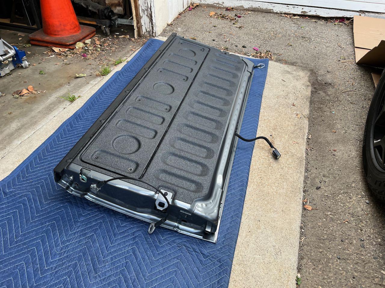

Remove the tail gate to get good access:
Ford Maverick Need suggestions for weather-stripping the tailgate IMG_7647
Ford Maverick Need suggestions for weather-stripping the tailgate IMG_7648
Ford Maverick Need suggestions for weather-stripping the tailgate IMG_7653
Ford Maverick Need suggestions for weather-stripping the tailgate IMG_7639

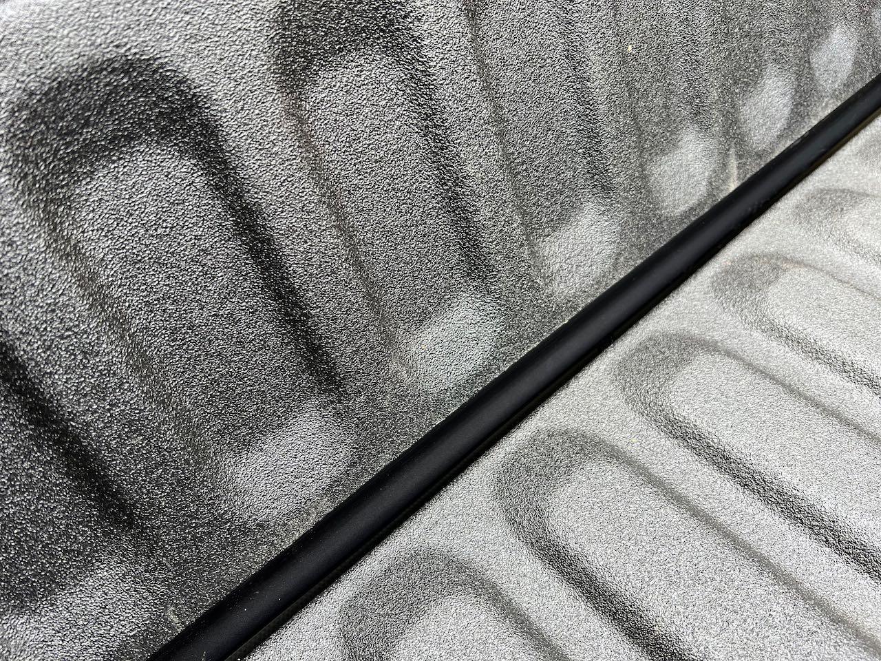

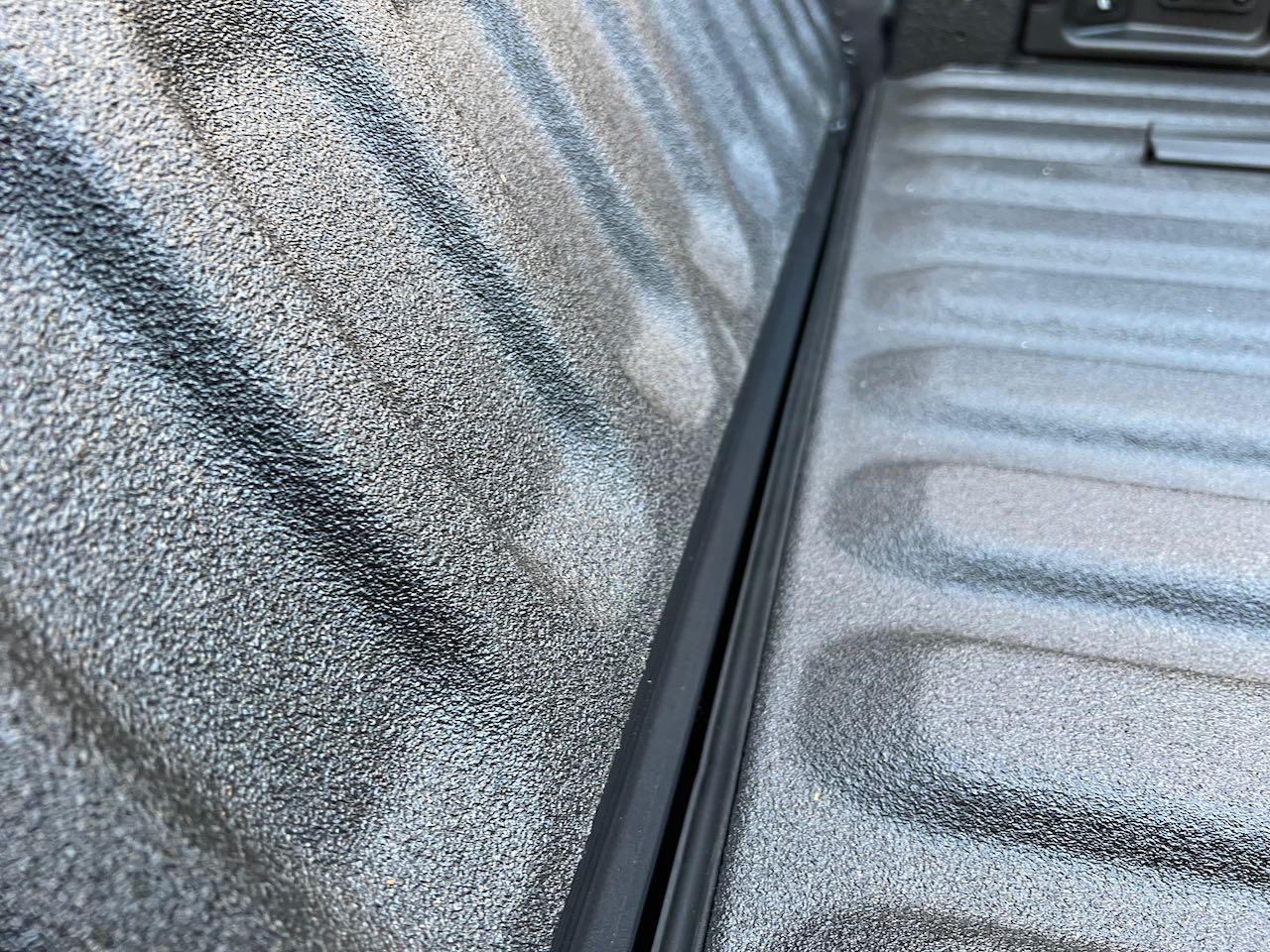

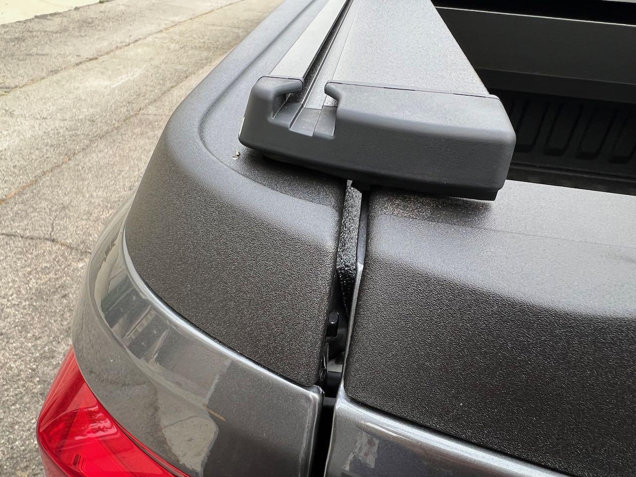

I put weatherstripping on both edges (tailgate and bed)
Ford Maverick Need suggestions for weather-stripping the tailgate IMG_7656
Ford Maverick Need suggestions for weather-stripping the tailgate IMG_7635
Ford Maverick Need suggestions for weather-stripping the tailgate IMG_7658
I get very very minimal dust and water intrusion.
Probably some room for improvement but over all I'm very happy with the product's longevity (1.5 yrs) and the general installation.
Ford Maverick Need suggestions for weather-stripping the tailgate IMG_7636
