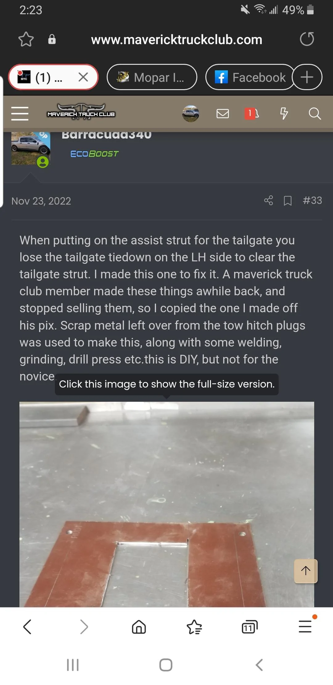

I decided on this instead of the D ring idea, and since he wasnt making them anymore, I used his pix as a guide and fabricated my own duplicate of his idea out of 11 gage steel sheet stock in my shop. Its a great idea.
Can you share some general instructions on how you made it? Looks like you were able to use one piece of steel stock and just cut the thickness in half to make the two sides? Not sure how you got the nice round edges or the oblong hole. Looks really really nice.
2 pieces of 14 gage sheet steel that I bent. Then welded together around the perimeter and ground smooth. I used a hole saw to cut two 1/2" circles, then connected them in the middle to make the slot.
