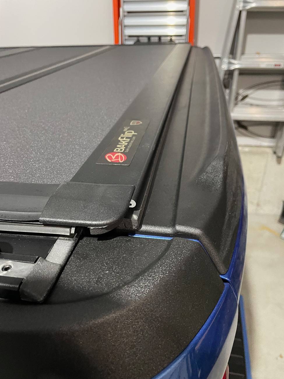

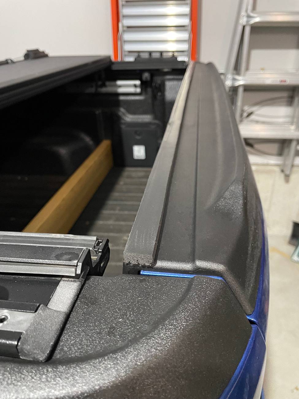

Hot Runr Guy Well-known member First Name Terry Joined Apr 27, 2021 Threads 101 Messages 4,262 Reaction score 7,912 Location West Chicago, IL Vehicle(s) 2024 Edge SEL, 2024 Lariat Tremor Engine 2.0L EcoBoost Clubs Dec 27, 2024 #7 My BakFlip MX4 sits a little high due to the Elevate TS rails that I have, so I added a 3/8" x 3/4" strip of weatherstripping to the top of the tailgate to fill the gap. HRG Sponsored
