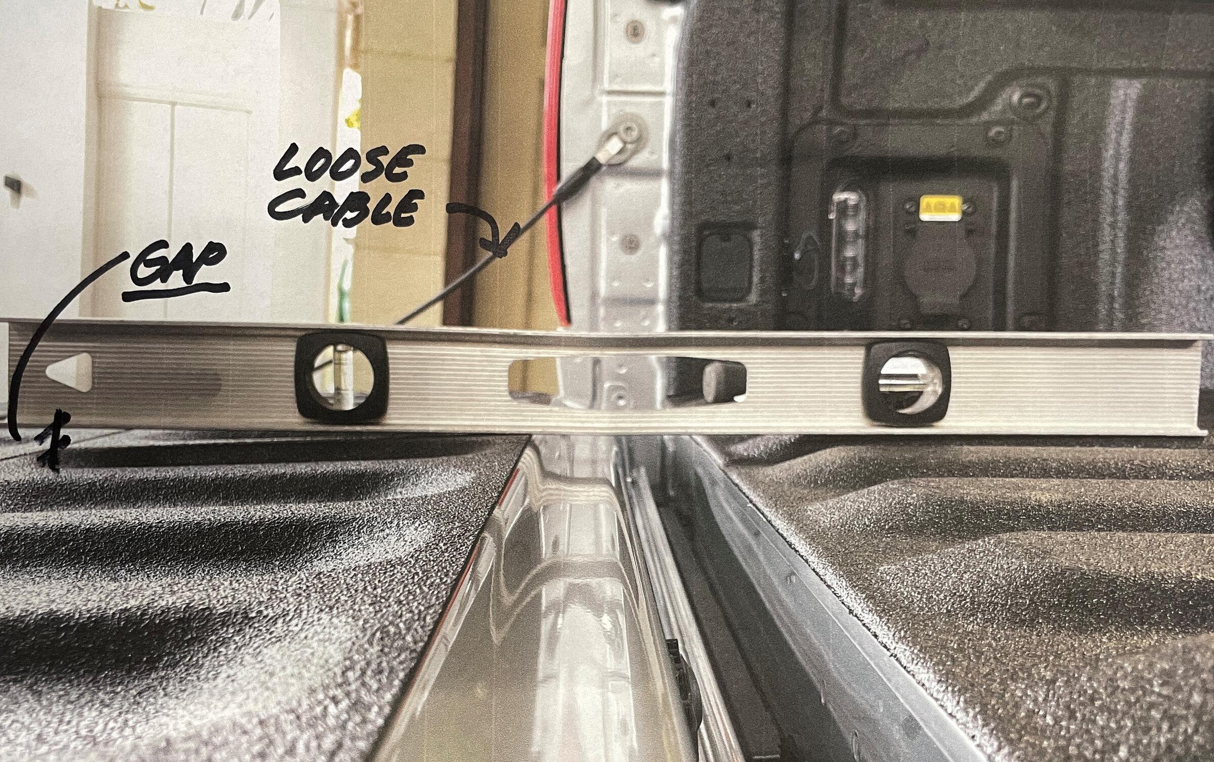

And in this picture, the driver's side cable appears to be slack......but the tailgate and bed appear level. Thanks for the pic.

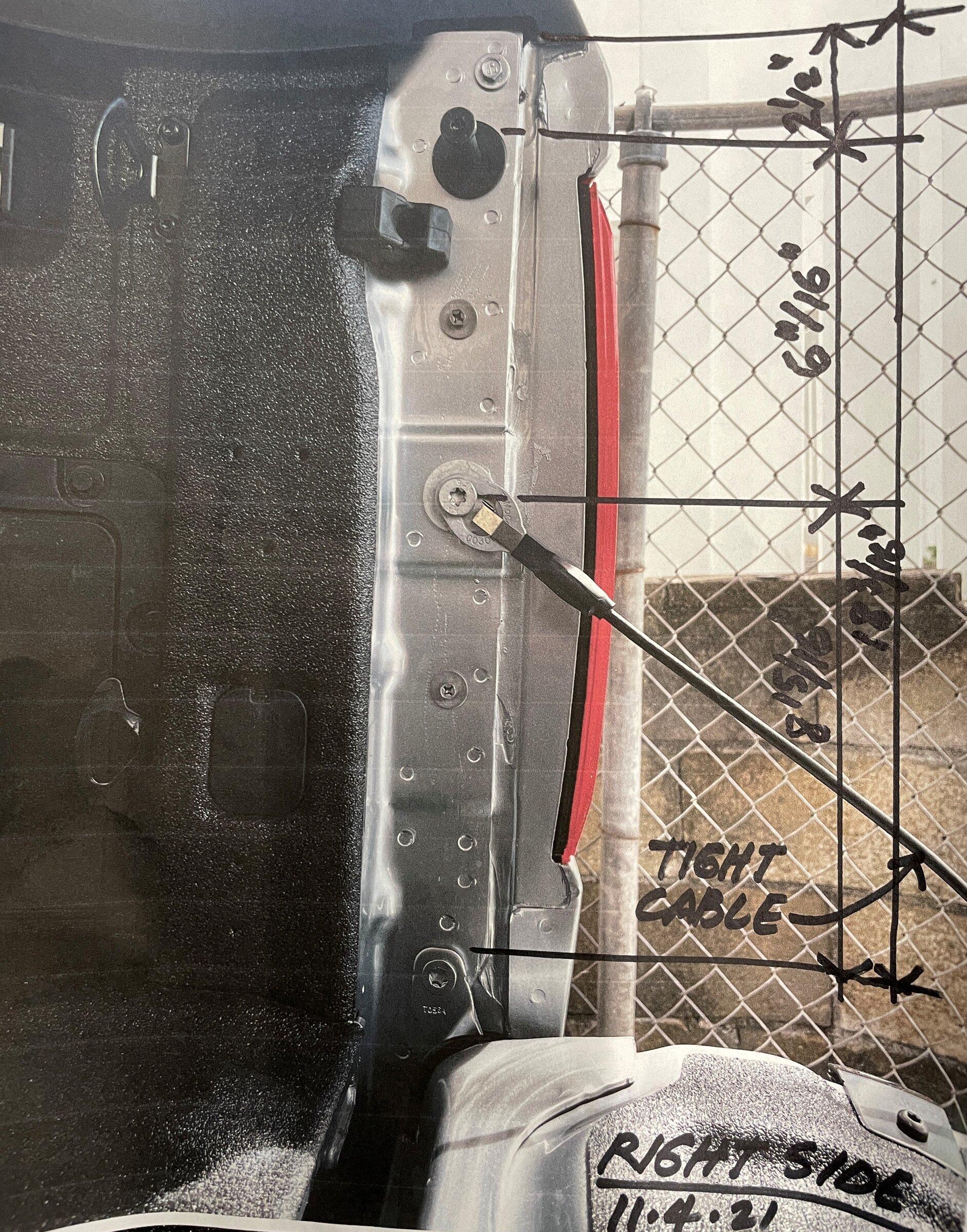

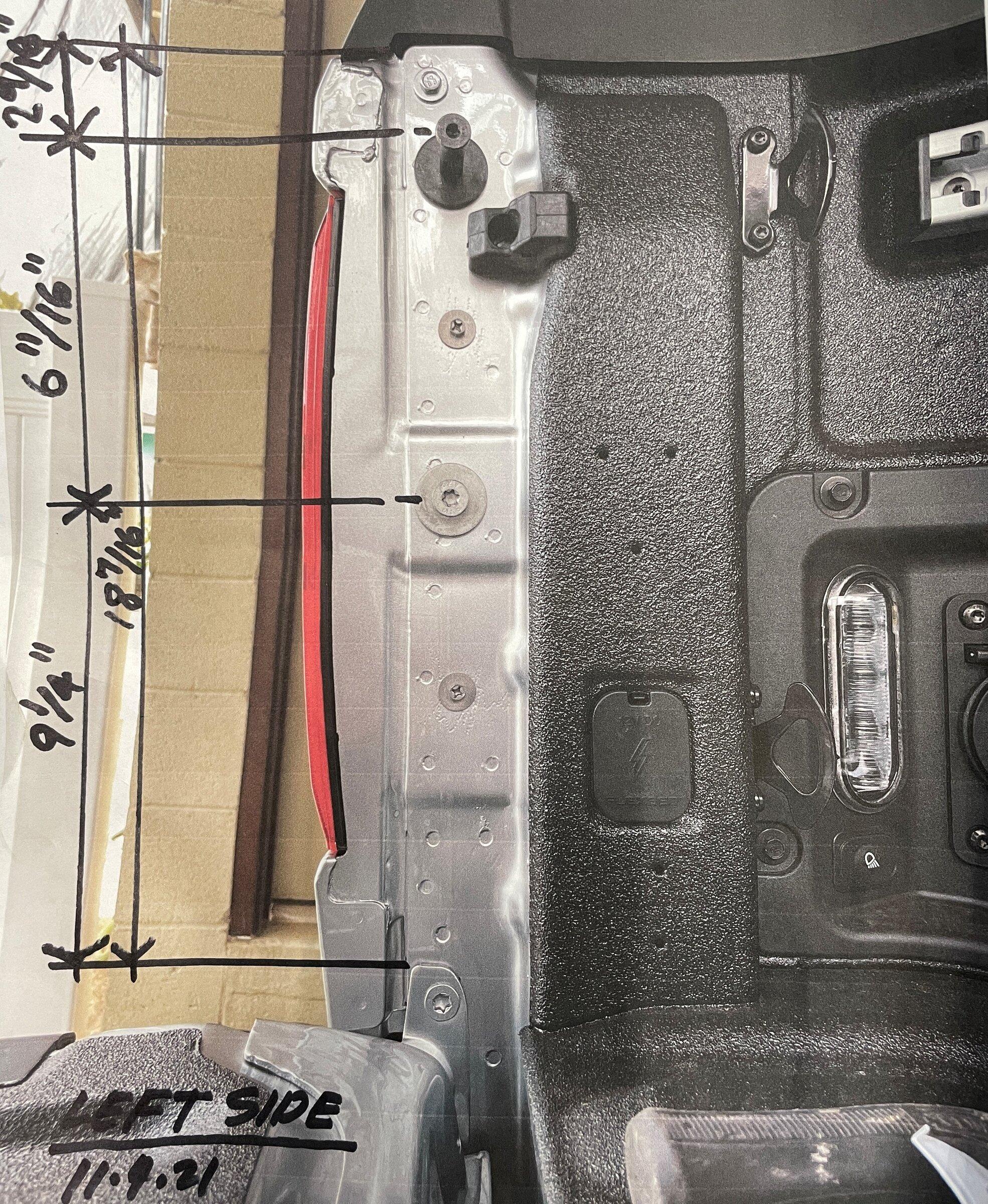

I've reported it to my local dealer and Ford Tech came back saying that it is within specs.
If you look at the dimensions, which I measured, seems like the tailgate hinge dimensions to the top of the bed are not the same. Notice the slack on the left side cable. There is also an issue with the tailgate not being level with the bed.

If I told my clients that a 5/16" difference is within spec on a door margin, I would be a hungry man!

Yeah my question earlier here was about if we have any pictures of Mavericks with coplanar beds, and if so then we could accept the "within spec" argument, that some are just out of spec. If none of them are coplanar, then that wouldn't be a spec issue... someone ducked up the design in that case, eh?

Sorry if this was covered previously -- did you measure the cables themselves, are they identical?

You don't need a level to see the "saggy" tailgate.
Holy ****, that isn't even close to being level. Was Quality Control drunk or blind the day this one was checked? Both?
