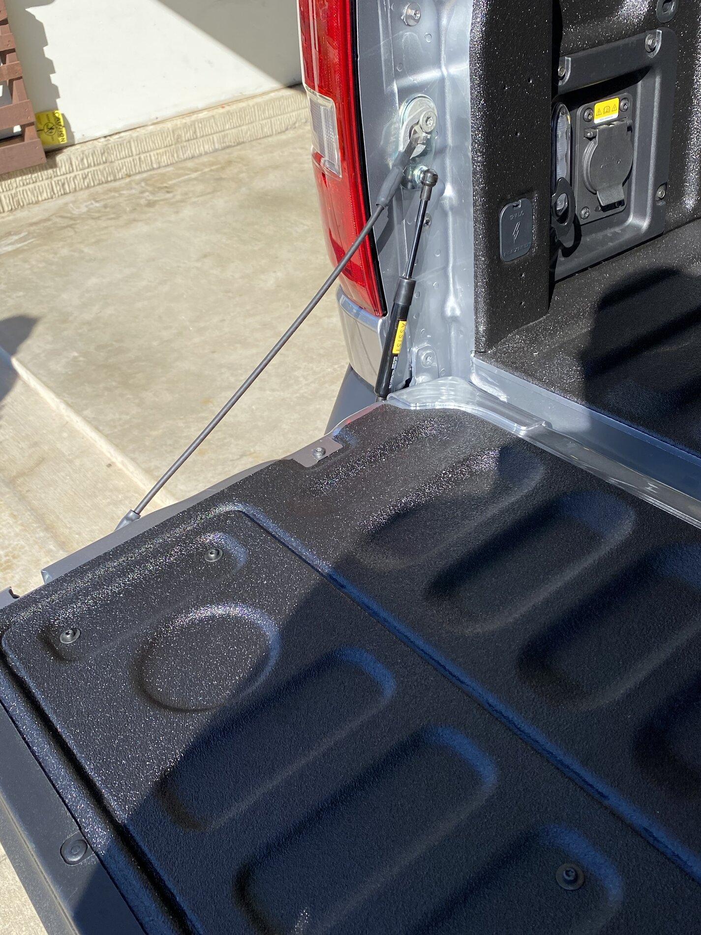

Looks like I'm gettting a bit of that rubbing also. I've opened and closed the tailgate about a dozen times since the install.
Ford Maverick Tailgate Assist Update IMG_1489 (002)

BREAKING NEWS!!! We installed it wrong!! The barrel has to go down, NOT UP!!! Ha Ha Ha !

Full disclaimer: my Father in law did the work. He likes small jobs like this to stay busy, and needed. Love this guy!!
Thanks @James St. Patrick !!!!
I know this is how the photo from Ford's website shows the strut, but don't the instructions that come with it show it the other way you had it originally? Wouldn't this position allow water to seep down into the strut?
You know, that’s an excellent point
This was addressed in a previous post by the OP in this thread which also mentions that DeeZee stated that it's installed incorrectly on Ford's Accessories page.
I'm hoping there's some resolution from DeeZee as I was thinking about getting one. Maybe I'll just go the button head bolt route.
