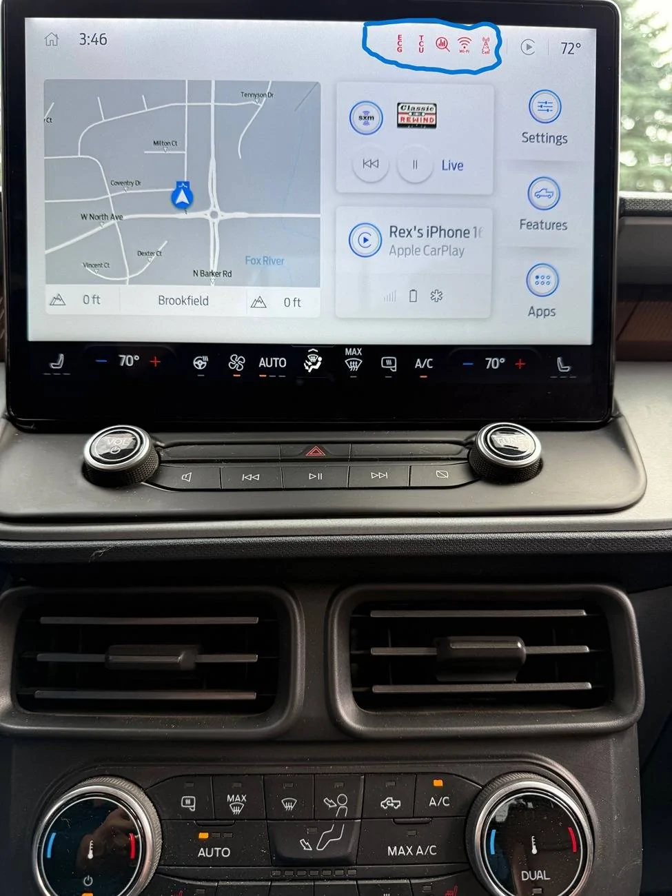

Great write-up, thank you very much, your APIM setting helped with my rear view camera and radio volume control on screen. I have the same setup as your except the Sync4 is from a 2023 F150 Lighting. There are some symbols in the top right part of the screen I am trying to activate or make disappear. I hope you can help or suggest options. The symbols are circled in blue. Thanks, Rex
Ford Maverick Sync4 APIM and 13.2" Screen Installation Guide (Lariat Models) IMG_0735a
Thanks!
I haven't seen all of those red symbols, but from the looks of it they are indicating communication (or lack there of) with the TCU module for one, and the Wifi unfortunately is not something that will work with this swap as far as I'm aware. I use the other theme where the category buttons are on the bottom instead of climate and that changed a lot...might be worth a shot, but I don't have a good concrete answer for you, sorry!
