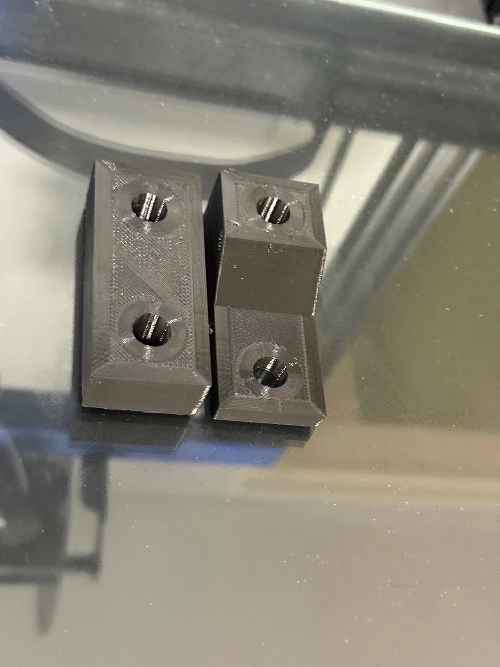

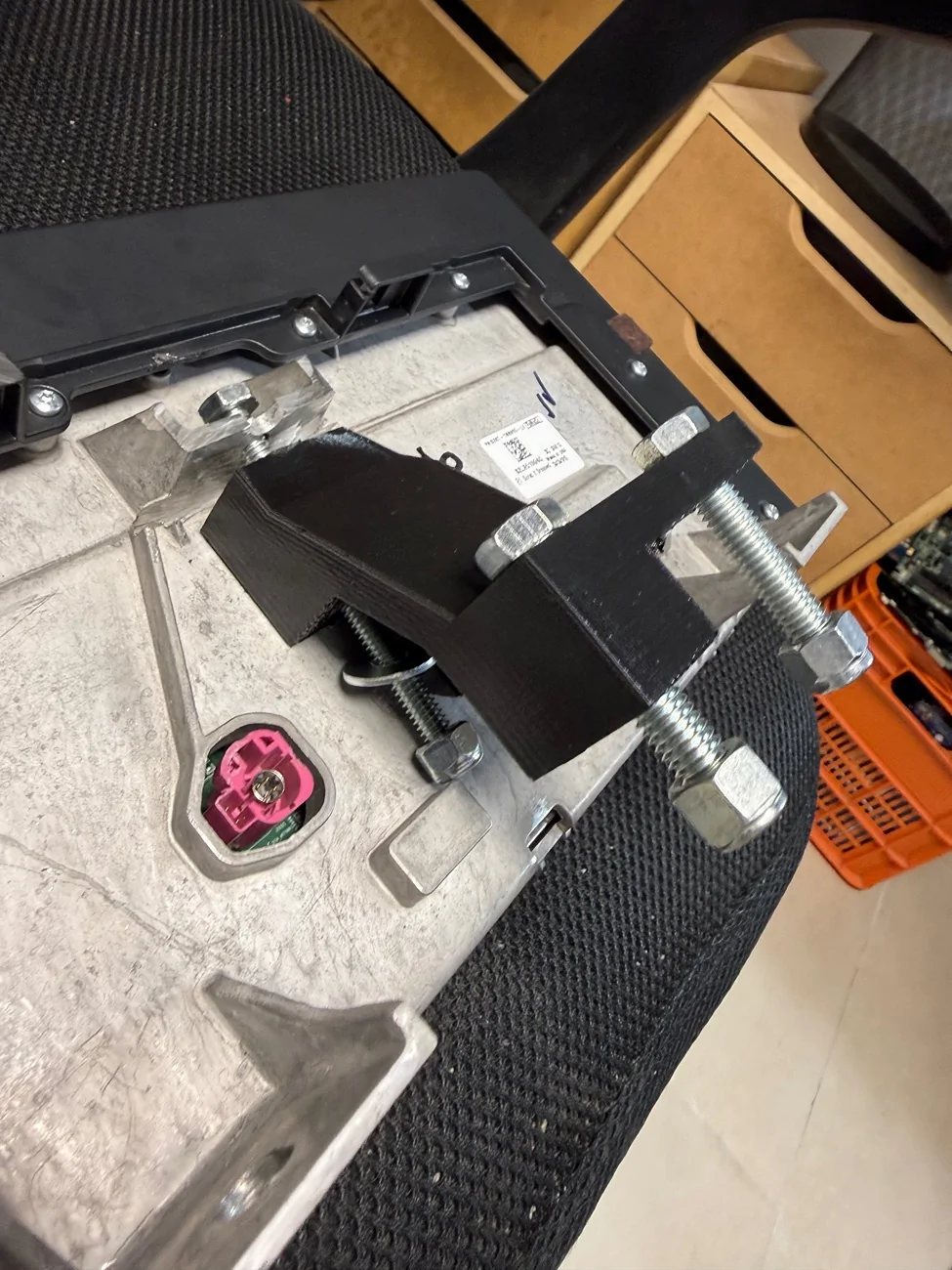

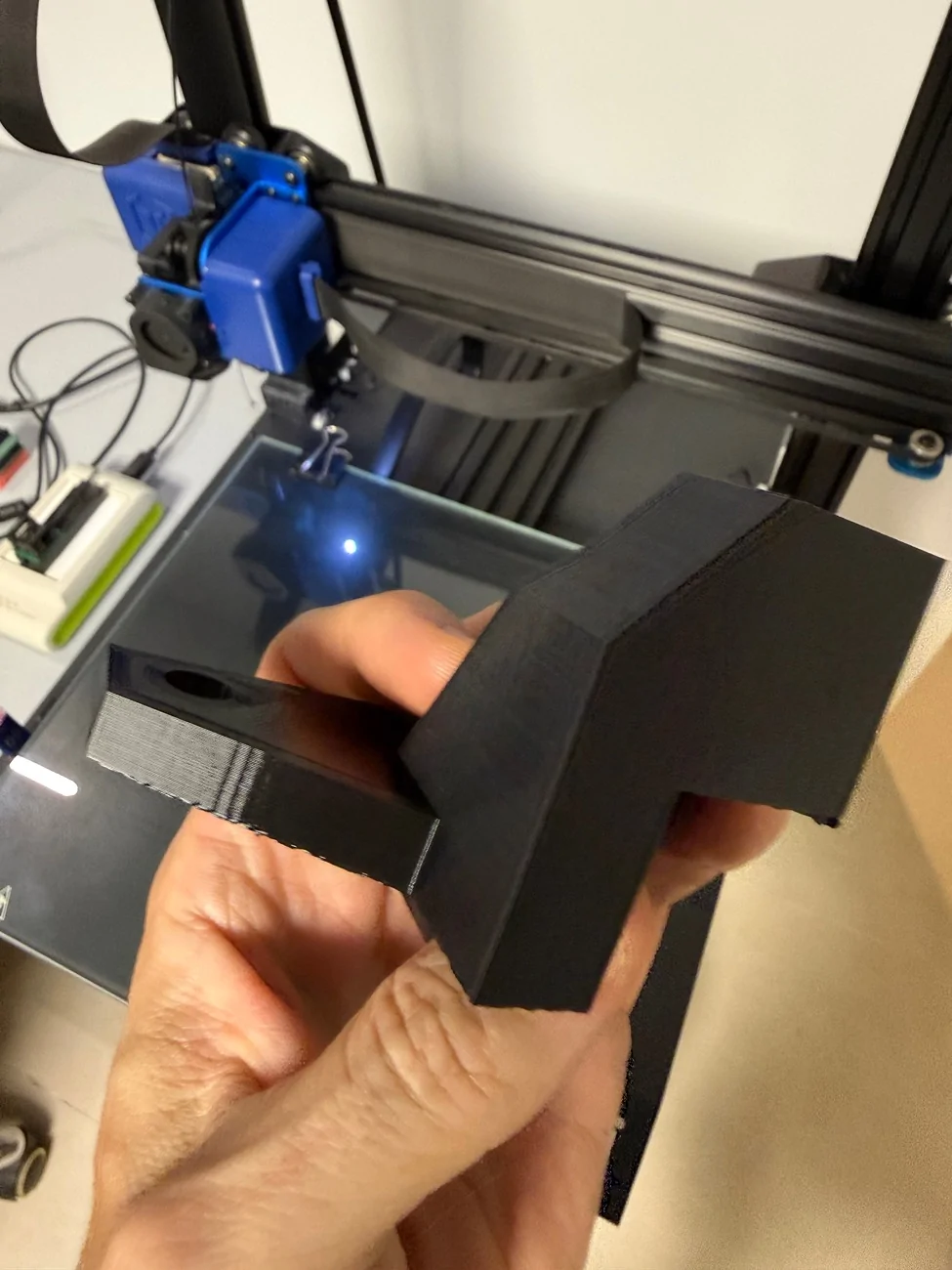

Second version of my 13.2 screen installation. I've printed (with help of some expert in the 3d topic desing) 3 holders to adapt new Maverick screen.
Next step is an extender to the rear cover , because large screen has a gap between dash and the rear part of it.

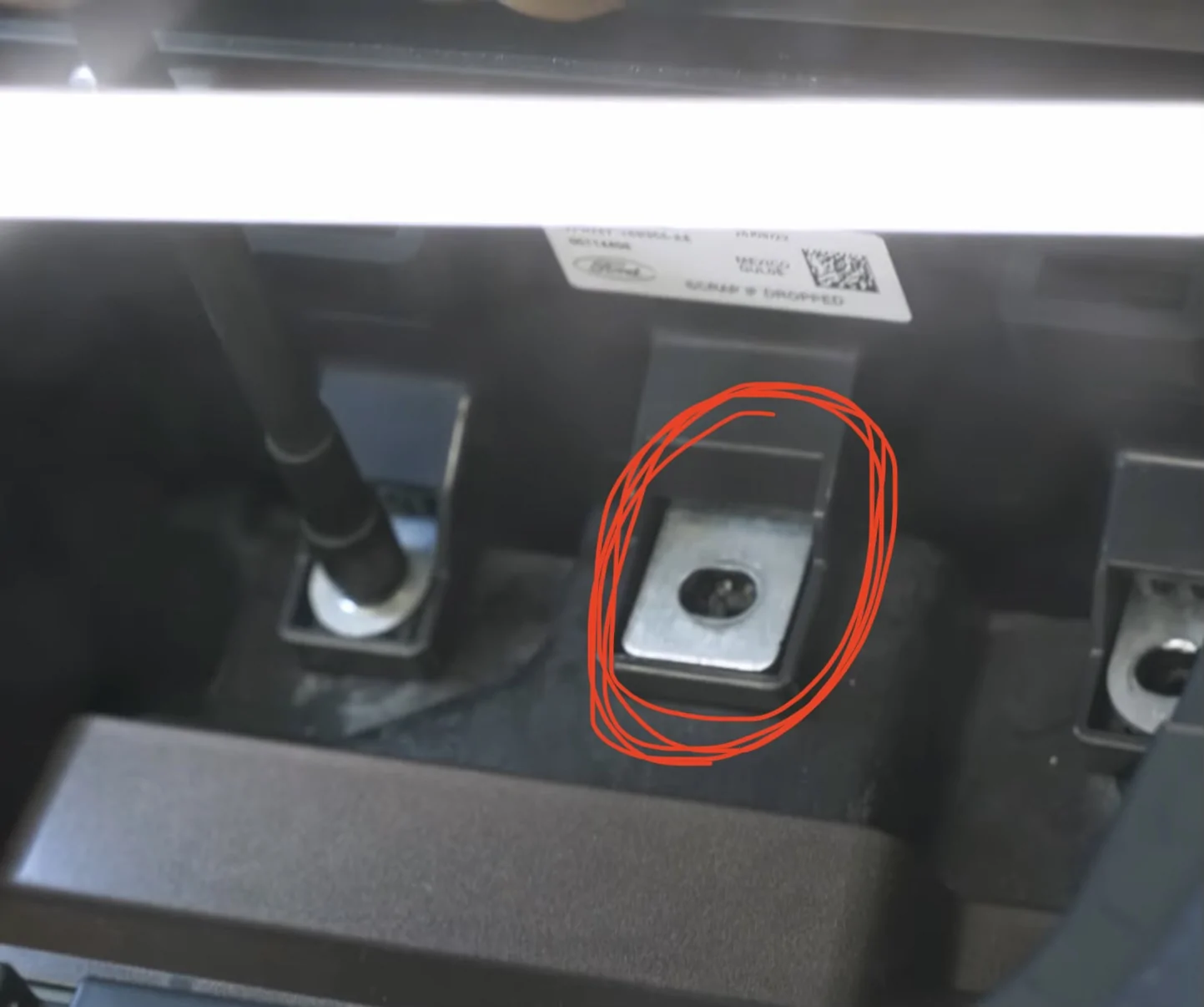

Does anyone here happen to know how essential or, hopefully, non essential these silver clips are after removing the screen? May have dropped one into the abyss 😬 Also does anyone know what size the screws are by chance?
It may seem counter intuitive… but I’ve had a randomly squeaky dash since I had an early service on my ā€˜22, and until I did the OEM Plus upgrade and found a screw missing, I didn’t know what or where it was.
that clip, holding the panel down in the center was missing a single screw and it squeaks randomly… but sounds like it’s coming from the gauge cluster. I just put my thumb on that spot and the sound goes away.
I cobbled together a random screw and got it secure.

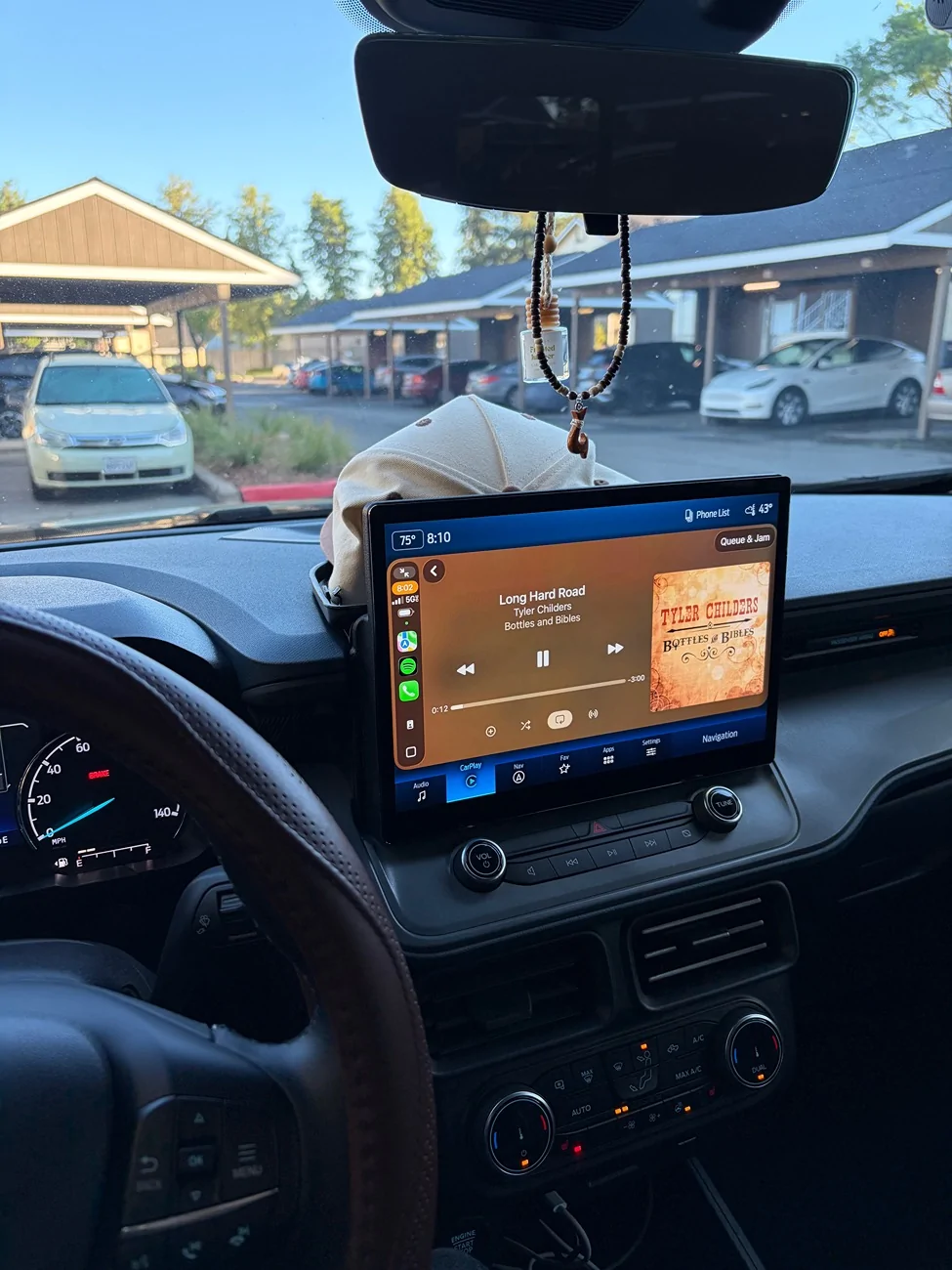

Just finished up mine thanks to OEM Upgrades Plus. Overall a very smooth experience. Quality product and much cheaper than some other OEM alternatives. It took a little patience and less than an hour to get installed. The kit arrived in about two weeks! Great communication from the team there on shipping updates and tech support as well.
yeahiguessman
Angelo
Nov 30, 2024
150
96
2024 Maverick Lariat
The one thing I would say about this after having it all day, if you have some particularly bumpy roads you are definitely going to notice a little vibration in the screen. Nothing crazy and it’s probably to be expected due to the nature of the mod. If your screen mount isn’t using the blue retaining clips like infotainment.com then you might notice it. Overall very happy!
