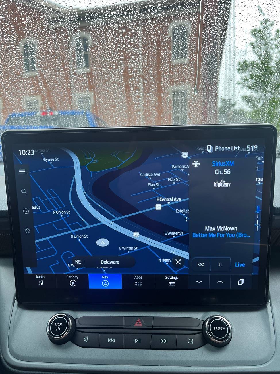

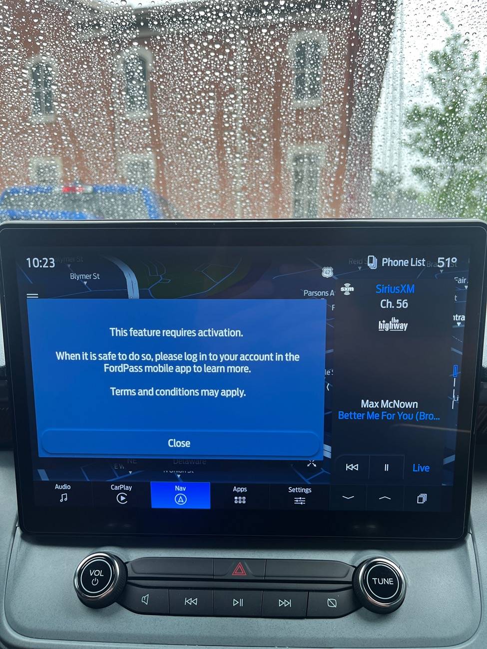

Any idea how to overcome this issue? Apim if from a 2024 escape and I have a lariat so had factory nav with sync 3. Would like factory nav to work on sync 4 but seems like it’s all grayed out. It’s following me around on map but I can’t plug any addresses in to navigate to.

Nav is subscription based. So your gonna need to pay. But I'm not sure how that would work
You can continue to view the map or use Android or car play

Knew it was subscription based for live traffic, weather etc. was hoping I could still just use basic navigation as others have been able too with escape apims in lariat trims

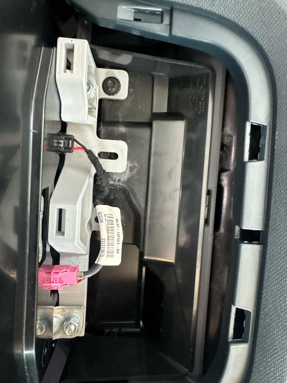

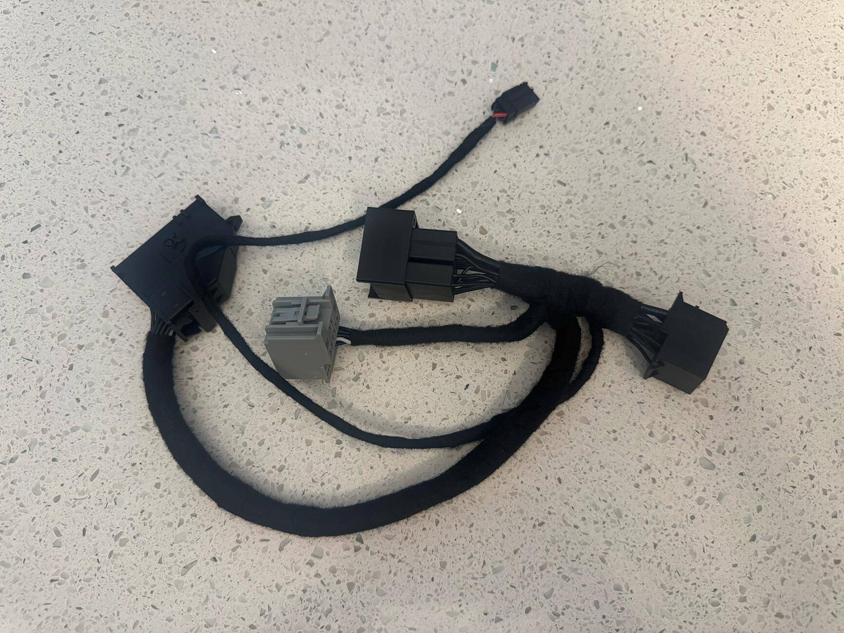

Harnesses are finally in and 1 more revision to the bracket and I'm hoping to have them shipping by the end of this week! Harness works with both upgrades to 8" sync 4, 12" sync 4, and the 13.2" escape screen. Bracket is only for the 12" transit screen.
