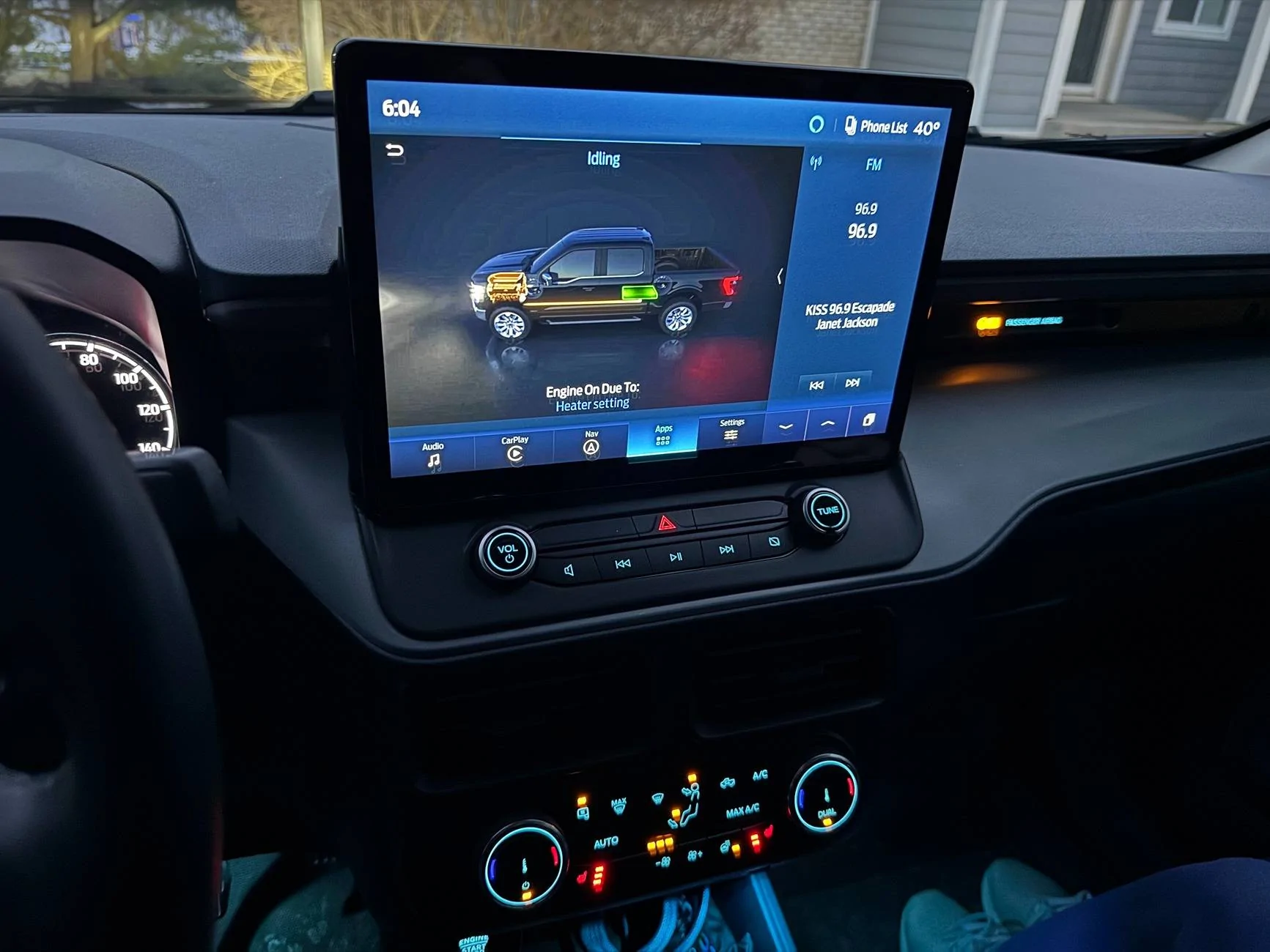

Someone sent me this today and I decided to do a deep dive here and figure it out.
Make sure hybrid is enabled:
7D0-02-02 xx8x xxxx xxxx
Enable the power flow menu:
7D0-02-02 xxx6 xxxx xxxx WITH climate bar enabled
7D0-02-02 xxx4 xxxx xxxx WITHOUT climate bar enabled (what you have pictured).
I don't have access to a hybrid so I can't actually confirm this works but I'm pretty sure it will. Report back with your findings!
If you just want to enable the climate bar layout:
Enable unreal theme:
7D0-02-03 xxxx xxx1 xxxx
Enable Climate bar for non-hybrid:
7D0-02-02 xxx2 xxxx xxxx
If things look weird or don't show up reboot the apim by holding power and next track for 10s or reprogram nothing into it, or reboot with FORScan.
As always any parts or programming you need for these upgrades check out www.oemplusupgrades.com!
Excellent, thanks so much. I had the hybrid enabled but adding the climate bar and unreal theme was helpful and looks good. Like @Bobert47, I see the trip screens but they don't change.
Two things to note, and maybe you know how to enable them. The Fuel Economy screen does not up date. It will show when it switches to electric but no fuel economy. Also the climate bar looks good but only displays the temp for the drivers side, not the passenger side, is it possible to enable this aslo?

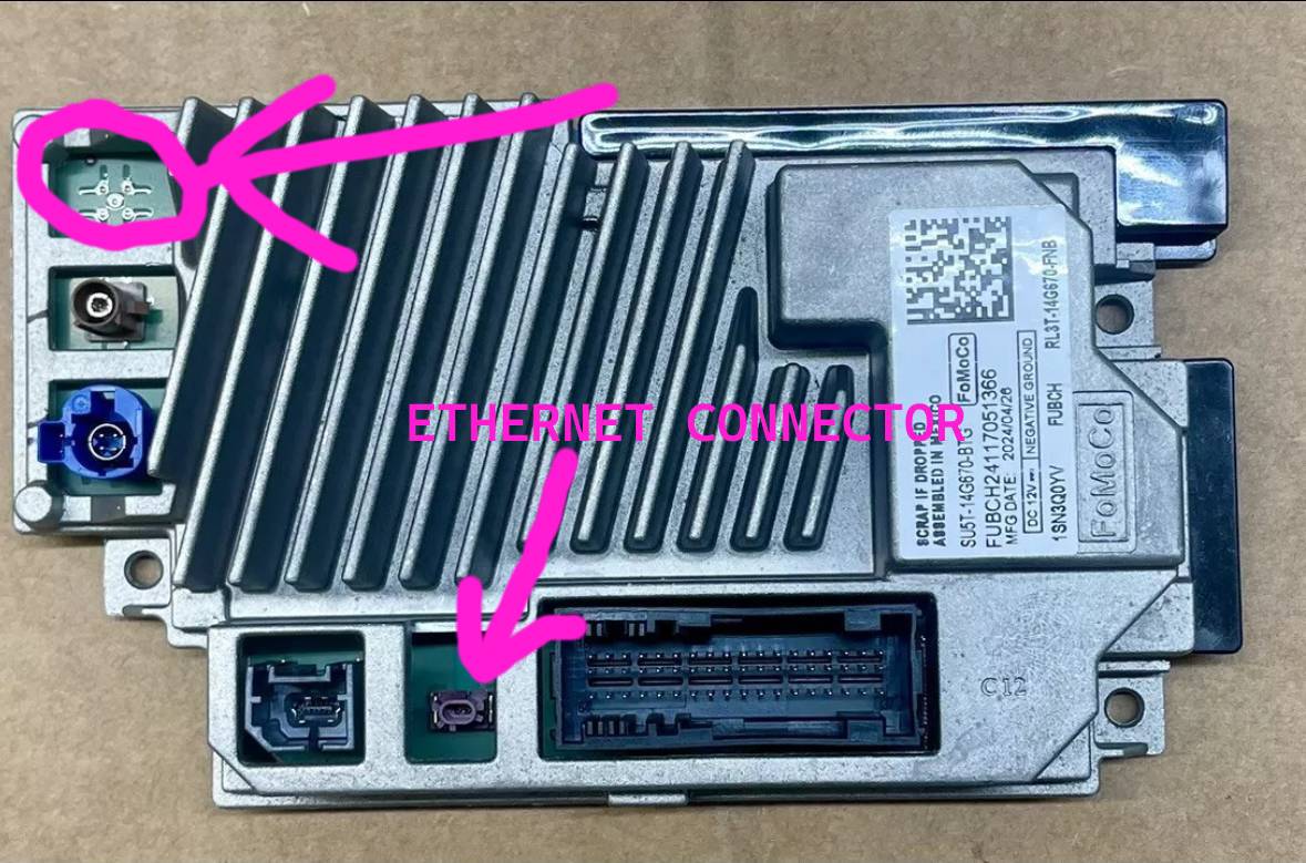

It seems that Ford makes APIM with GPS and without GPS.
The GPS antenna connector should be there, but this APIM doesn't have it.
Does anyone know how to find a OE replacement cable for the GPS? During the install of my sync 4 module I ended up breaking the GPS cable so now I no longer have GPS in my ‘22 IE no more location availability for my truck thru the ford pass app.
