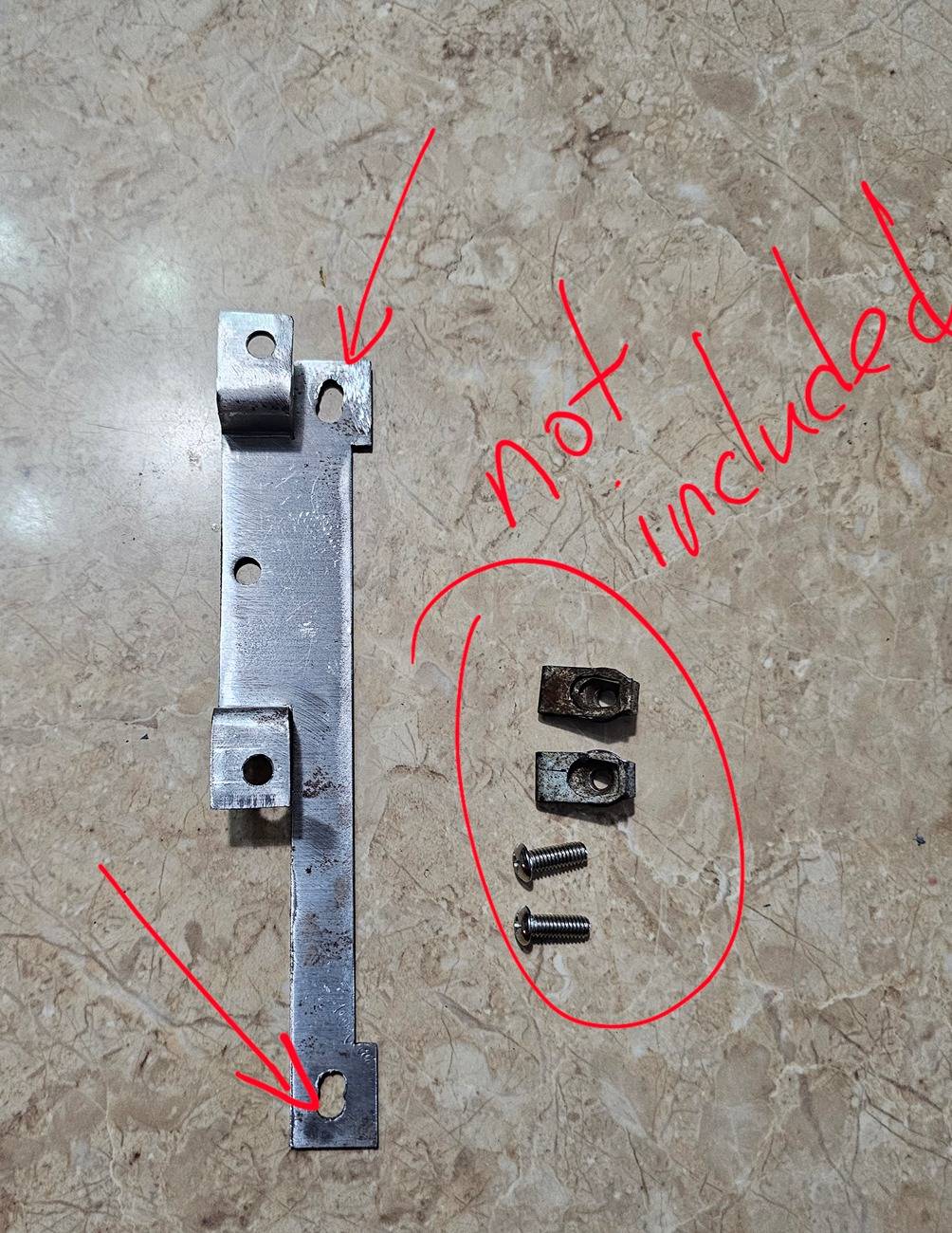

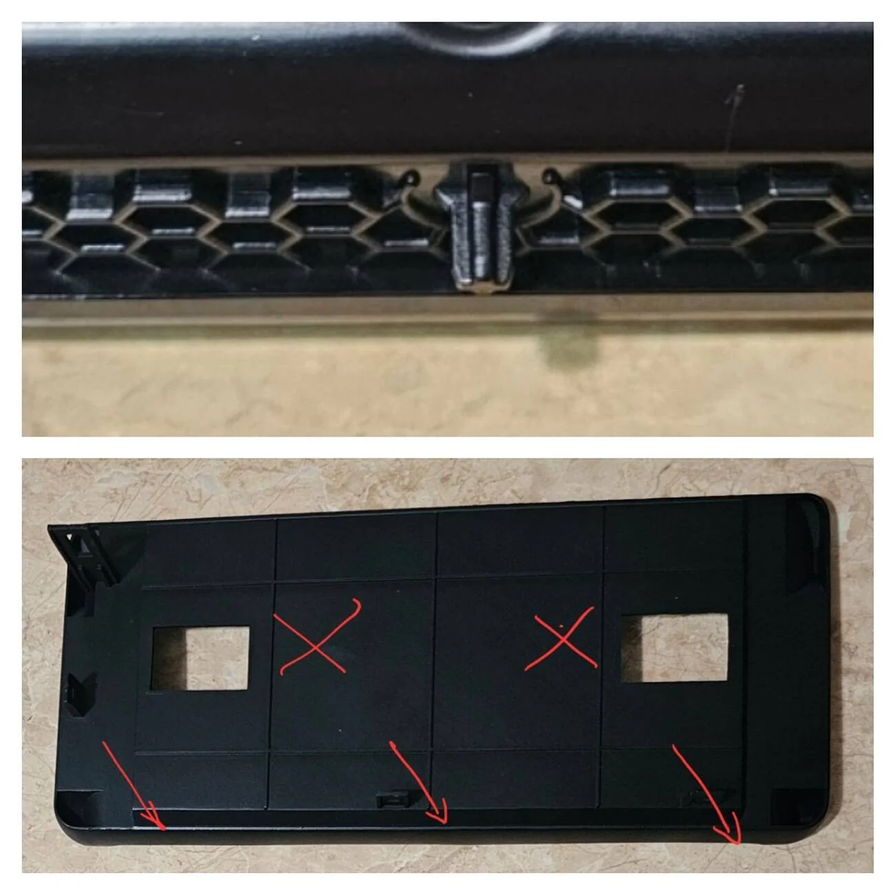

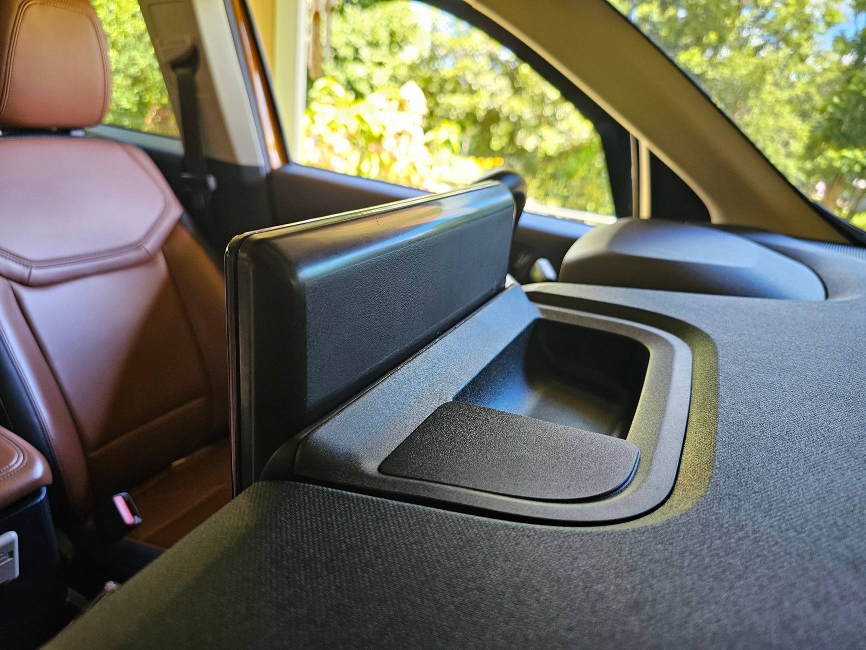

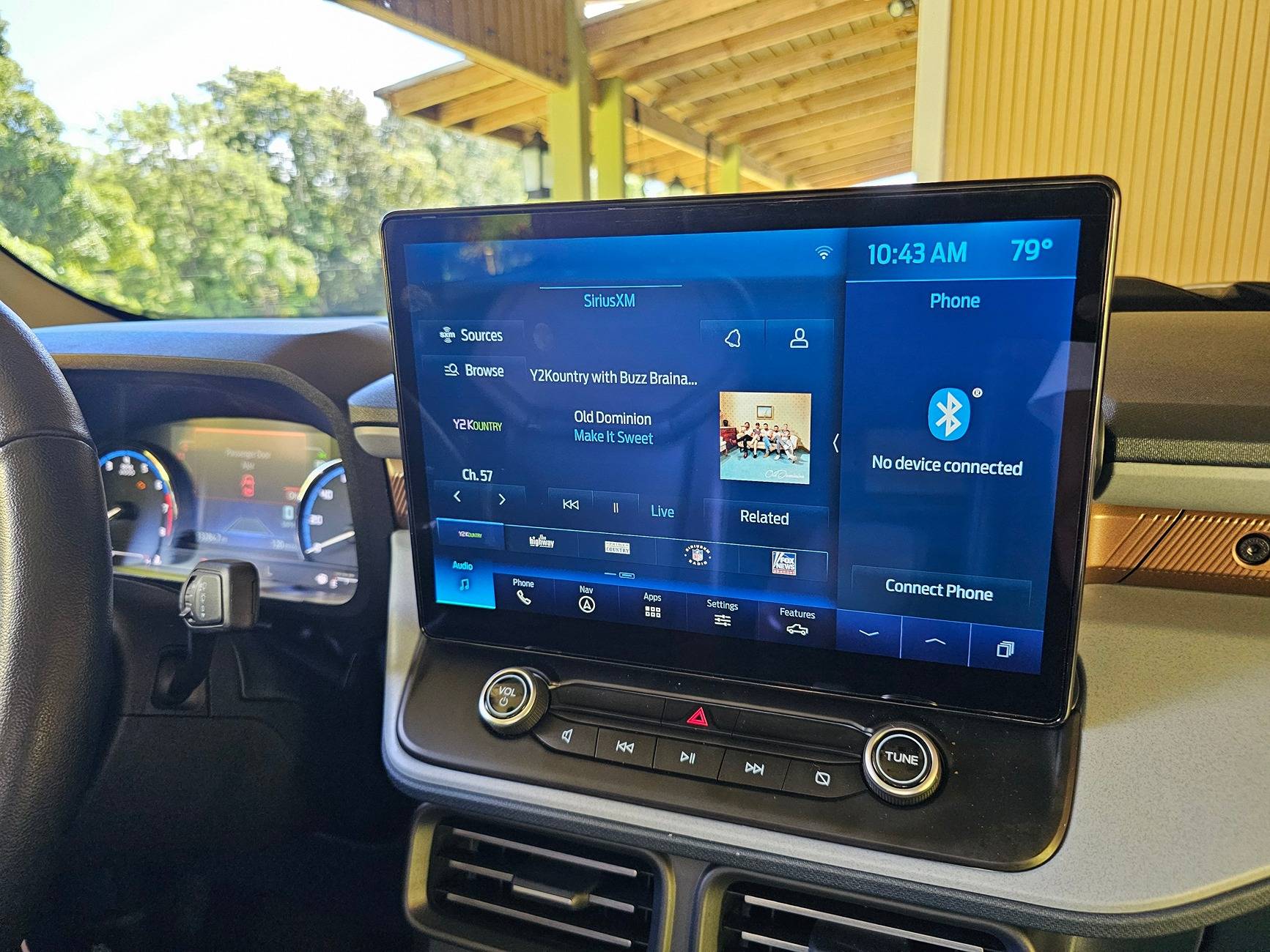

This is how it is looking. I'm very happy with the final product, BUT right now, I don't recommend you buy the kit for several reasons. The plastic back plate does not have the holes to pass the screen cables, nor the 3 holes at the bottom that keep the screen fixed. The holes in the metal bracket do not align when you put the screen in place (They also do not provide the screws to attach the screen to the metal bracket). If you have tools to correct these problems you can buy it, if not, don't do it. I contacted them and they are going to correct those issues. As for programming, a lot of changes need to be made in FORscan as many things don't work well. Apparently, what they did was upload the Sync3 codes to the new APIM. I'm fixing that now. I'll keep you posted.

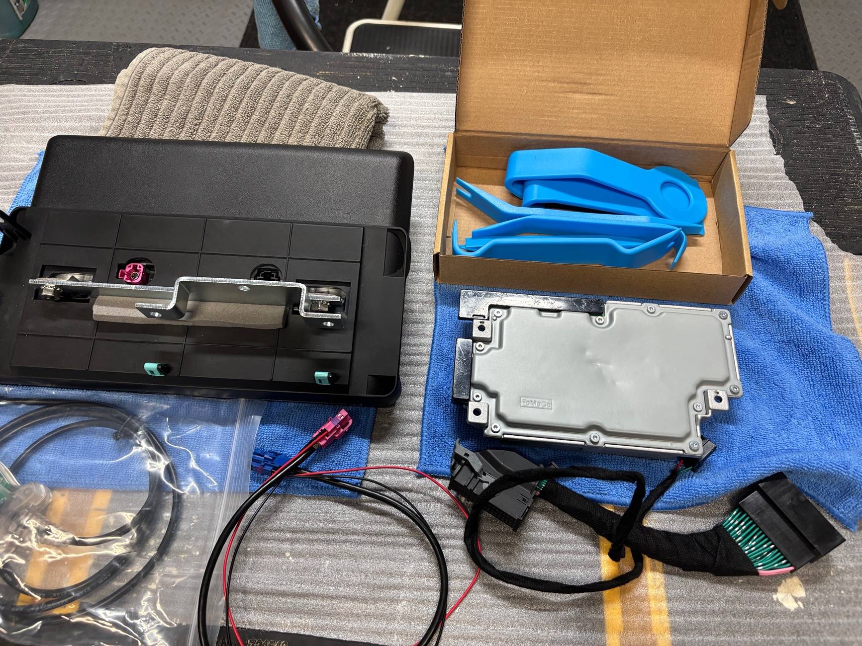

Can you upload photos of what they gave you?
Hank573
Hank
Oct 31, 2022
2025 Ford Maverick Lariat Hybrid BAP,
This is what came with the 8" to 12" sync4. The screen is not scratched just looks that way in the photo. Also, the install bracket and screen holder are already installed on the screen. I hope this answers your question.. I added a photo of the back of screen and APIM.
Ford Maverick 13.2" screen SYNC 4 upgrade (so long, cubby!) IMG_0056
Ford Maverick 13.2" screen SYNC 4 upgrade (so long, cubby!) IMG_0057
pantera156
Pantera
Feb 25, 2024
86
Porto Alegre
lariat 2.0
Very thanks!! I'm 98% sure it's a Ford Transit screen
