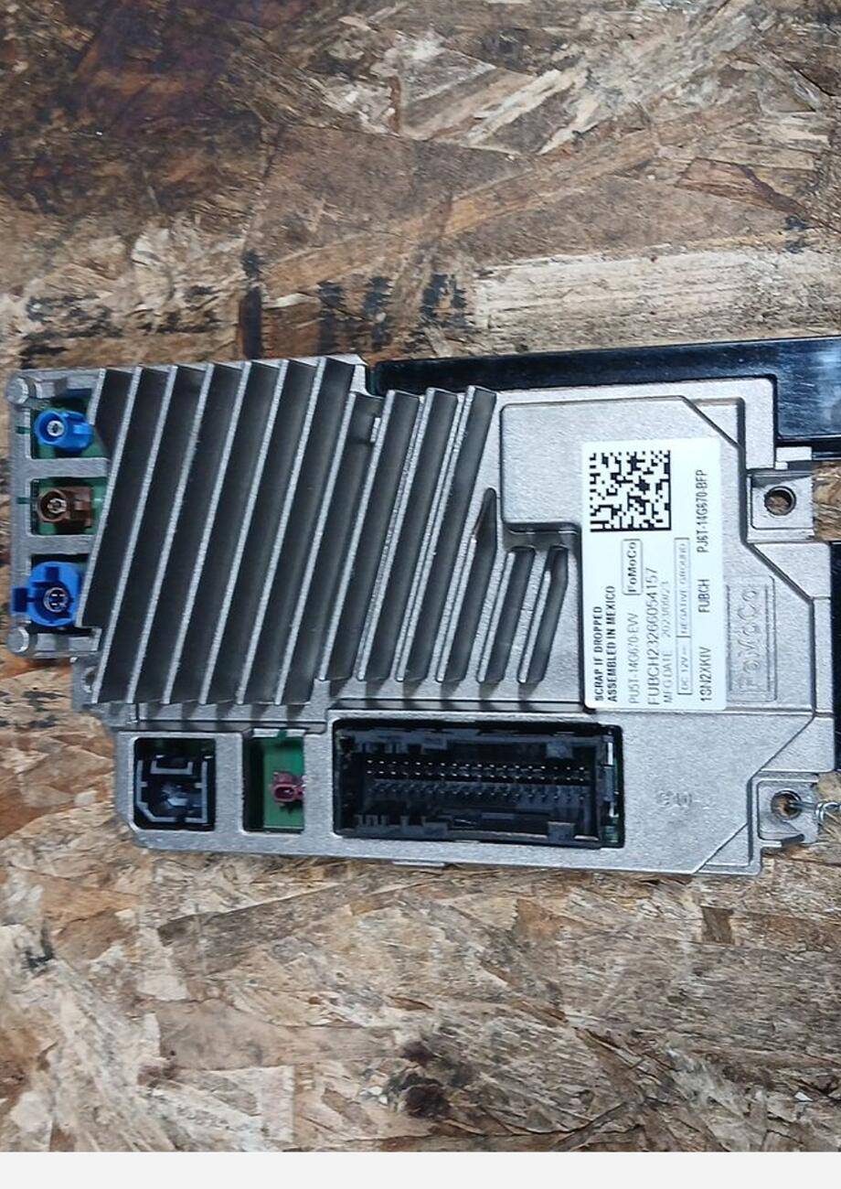

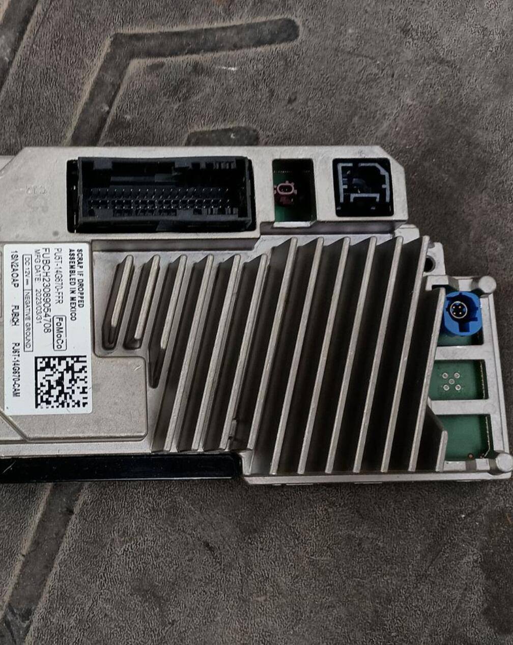

Confused on the plethera of APIm models available.
I do not want navigation, but do the models without navigation work with the larger screens and SiriusXM?
If not, can navigation be disabled on the nav models so that it doesn't come up on the screen?
Both of these are from a 2023 escape, not sure which one I would need.
PU5T-14G670-FFR
PU5T-14G670-EVV(or EVR as well)
Edit: Top model w/o Nav looks like it's for 8" screens. I haven't found a model for 12" screens w/o Navigation.

you are correct. the six fin display connector is for 12+ and the 4 pin is for -12 in screens.
i think your going to be hard pressed to find one without nav for the 12+ almost everything has it now. you may be able to turn it off it off in forscan not sure tho.
why no nav?
why no nav?
I much prefer Google Maps/Waze.
Isn't the navigation subscription based, and I didn't think these could be updated as far as the software.
