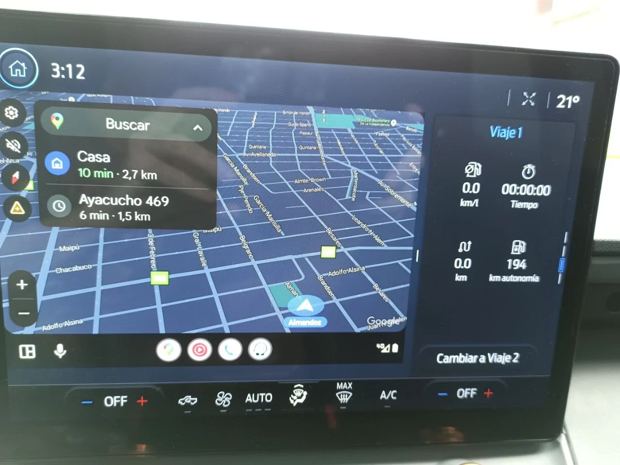

Has anyone been able to get it to display the full TRIP data? It only shows the remaining range, but not the other data. :crying:

I haven't been able to get the trip data to show on the infotainment screen at all on my setup (I didn't dig into it too far to be honest since it shows up on the instrument cluster screen for me still). I'm using CarPlay with the SYNC side panels if that is of any concern.

You need a matching dash to do it. Once I swapped to the escape cluster it started working. The stock one won't talk to the sync 4

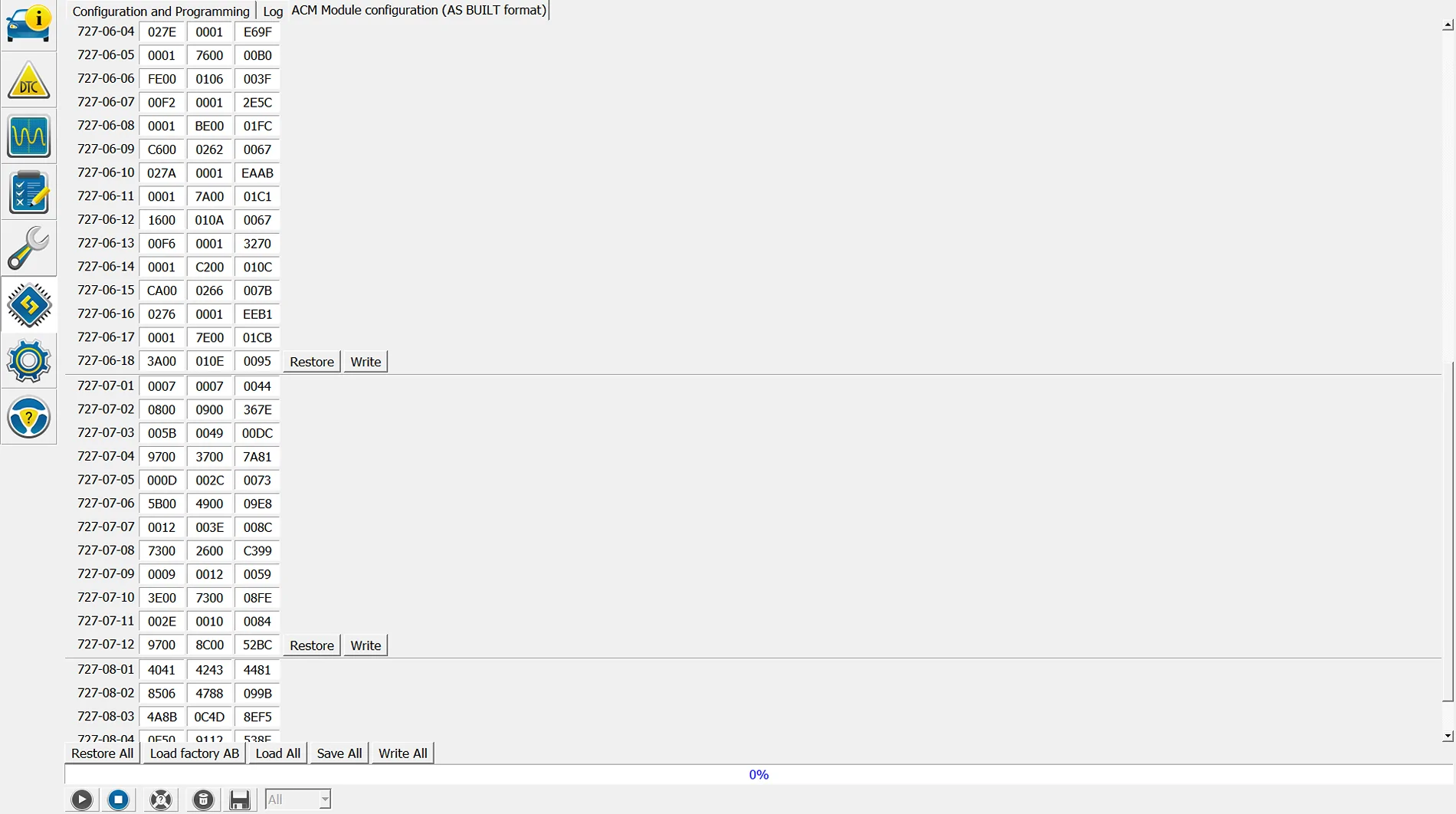

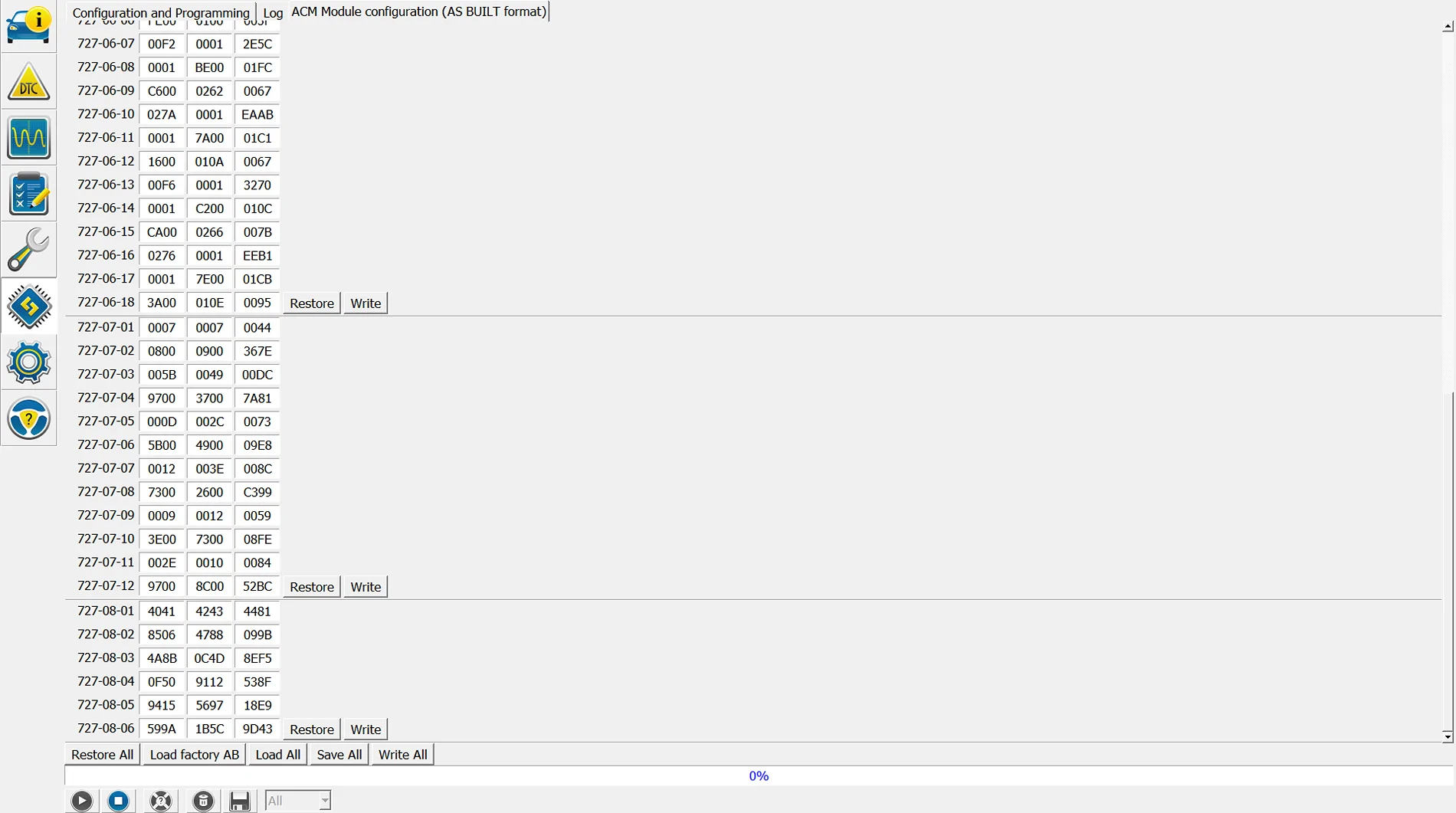

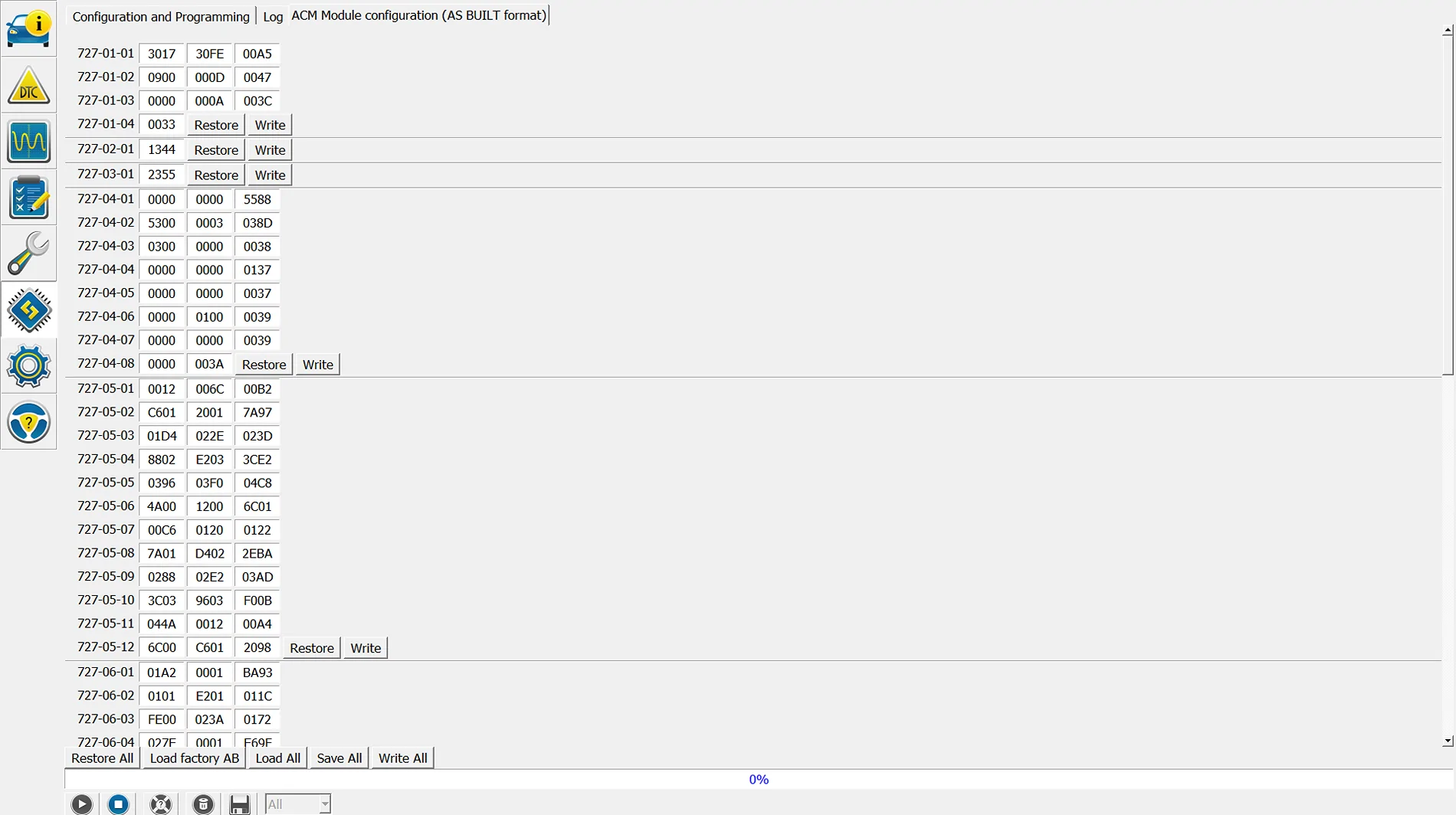

Hey MattinNC, here you go, Merry Christmas! :)
The images overlap, its not as many lines as it seems. Sorry its not in a table to copy from, I'm on my phone and already on my holiday travels. Hope it helps and thanks for the shout out!

Bobert, Thank you so much for posting! I appreciate it. I wanted to have another Hybrid to compare the ACM. I have the "23 Hybrid Lariat but without the B&O system but it should be pretty close.

Thanks for addressing this! I took that picture just after getting my build setup. I can confirm that those lines are what I needed to get the screen working. I will add that the "trip" screens that will show up on the this mod (if enabled) don't synchronize with the the "trip" on the cluster. I learned this from another user on here, and that you would need to swap out your cluster for a 2023 escape (or similar from what I recall). Anyway not specifically pertinent to this part, but the power flow screen does work very well. Happy New Year All!
