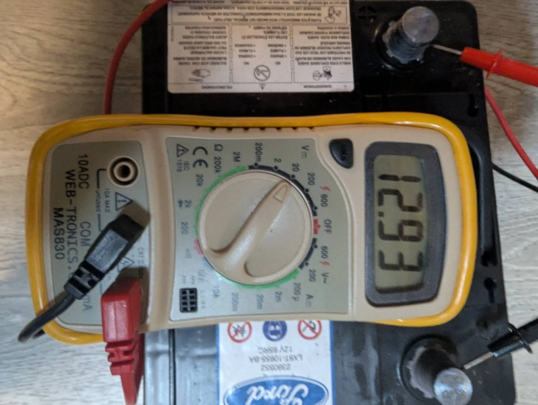

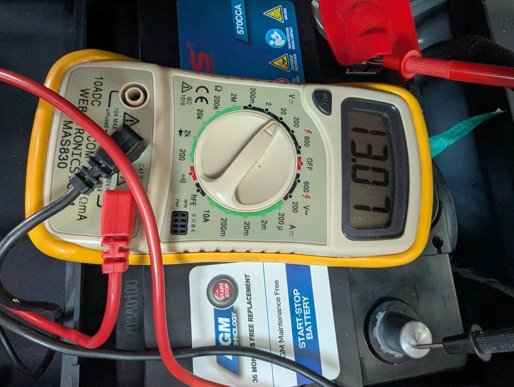

Seems to have a full charge???
But then again, this is my first modern AGM battery...
I'm wondering if there's some other way to test the charge???

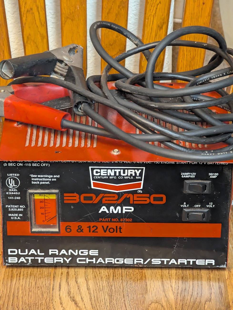

I remember the day I bought my old trusty Century charger/starter back in 1995-
It was pretty high tech 30 years ago, AND made in the USA...
Still works great, but not for AGM batteries, as I understand it???
Yes, doesn't look like it's for AGM.

And you could have used your old fashioned battery charger for charging that new AGM battery without a problem. Just don't overdo it: maybe 3-4 hours on the 2A low setting at 12V would have been fine.

Just make sure you have a charger compatible with AGM batteries.
